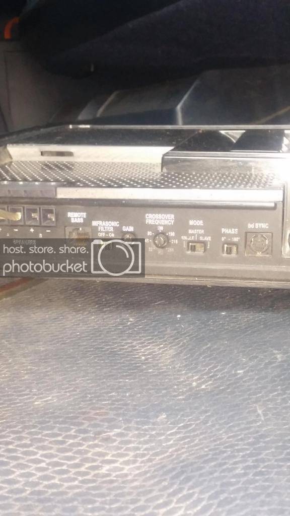

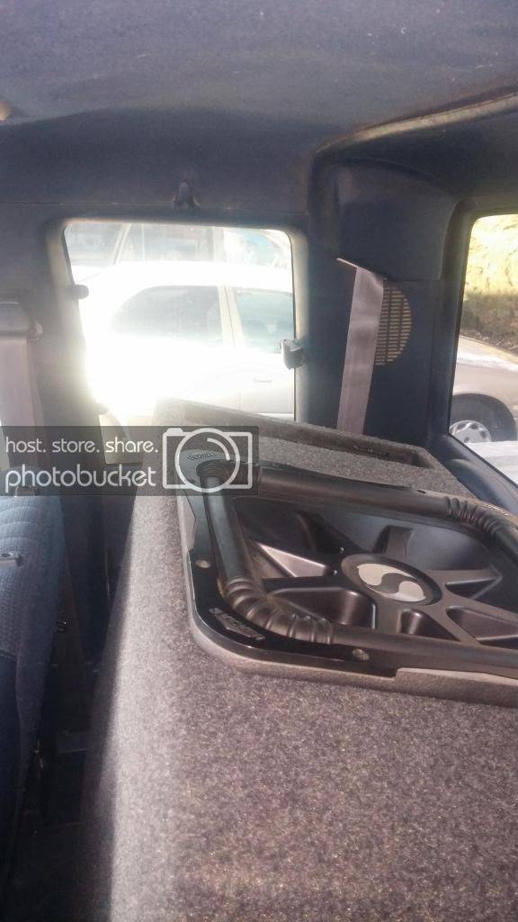

Pics of any switches or knobs on the amp. I'd be interested to see the box as well.

K, heres an attempt at photos.
[/url]
amps current settings
box is in back seat in extended cab truck, firing towards the ceiling. Best picture i could get right now
I can't really tell where the low pass filter is set. Should be @ 80hz.
Really it doesn't look like there's much else you could have botched there and the power and ground seems adequate. Sub and port up seems to do well enough in X cab pickups as well, and the box looks pretty big.

Yeah, it was set roughly at 75 to 80hz. In the time i was off the board, i switched out the t1000 for an alpine PDX 600 @ 4ohms, haven't had any problems. Still stumped. Im gonna try the Rockford again here in the future. Thanks all for the replies.
