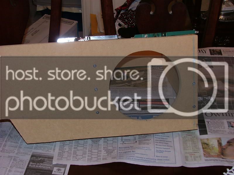

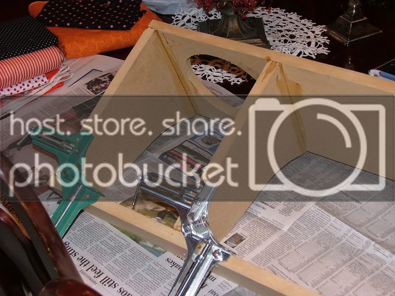

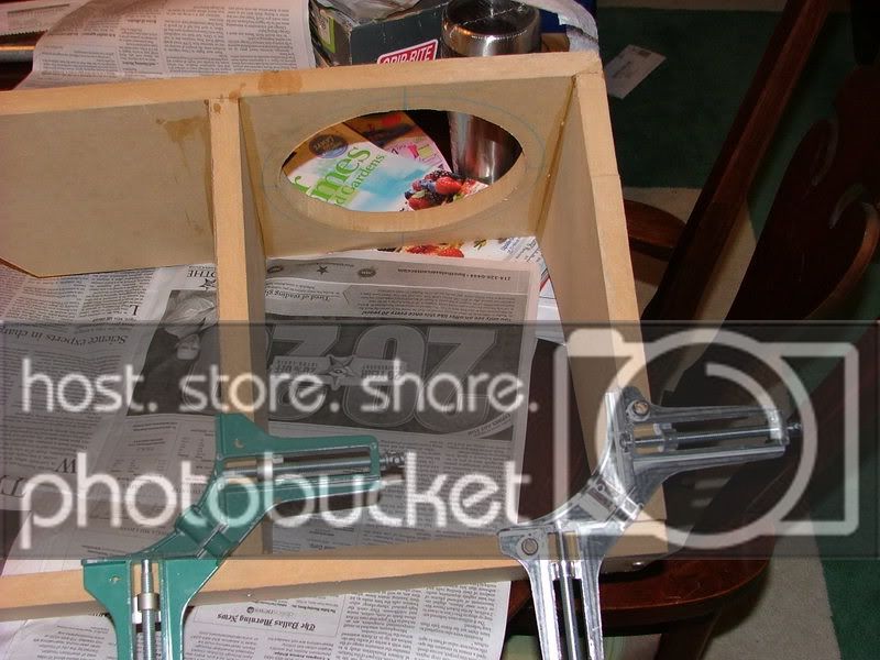

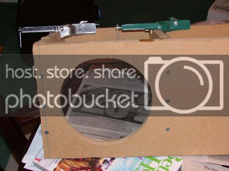

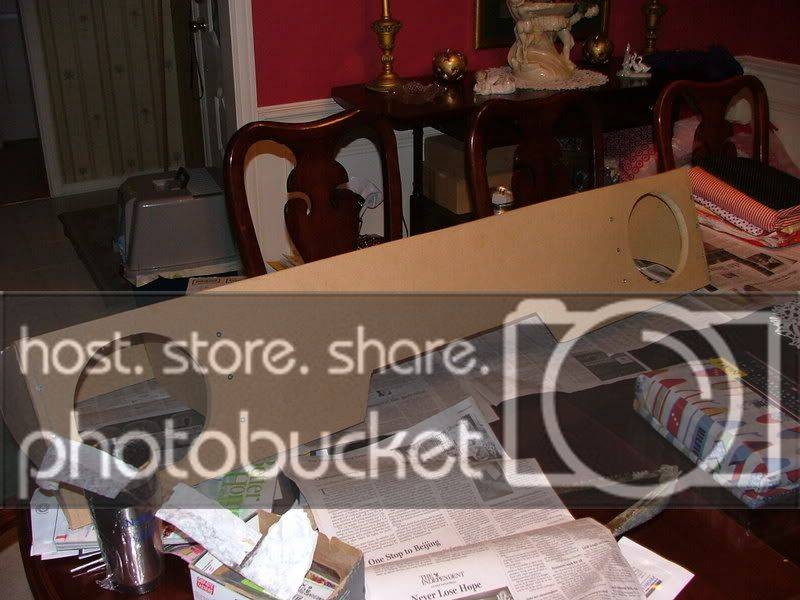

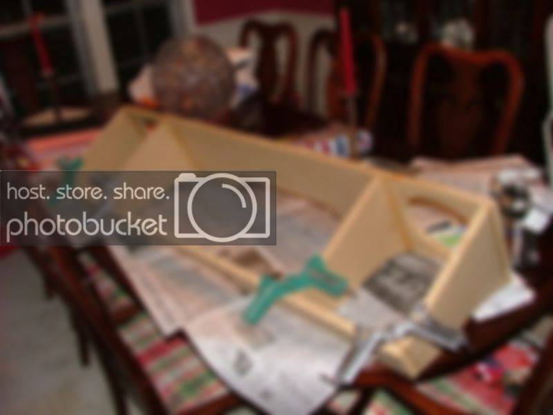

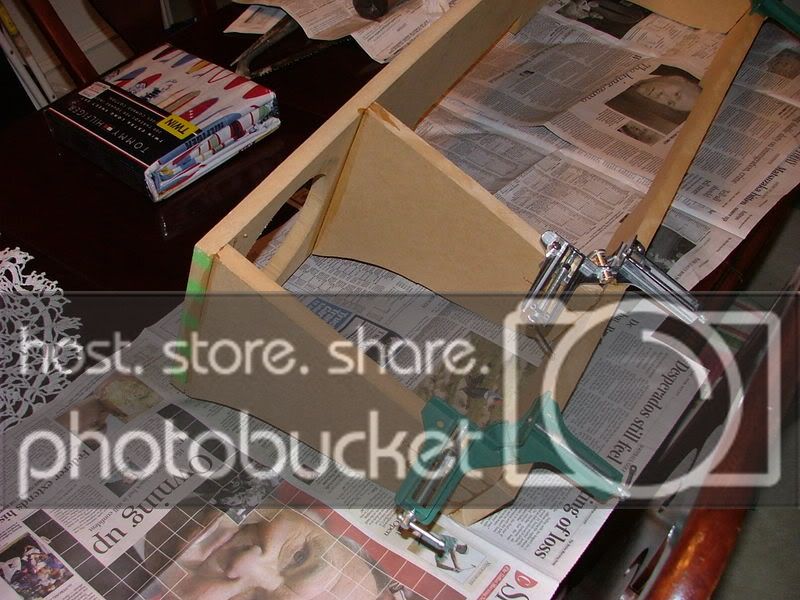

Ok so I was lazy today, I only cut out the circles for my subs, glued it and screwed it together... But I took pictures
Im thinking Im gonna need to caulk the shit out of it tomorrow but either way im fiberglassing the bottom so I can just come up the sides to make it truly sealed. Also I left the middle open because I can either make that storage or put my amp there. Im really liking it so far, too bad I don't have an amp or headunit to power it up with to hear it lol...

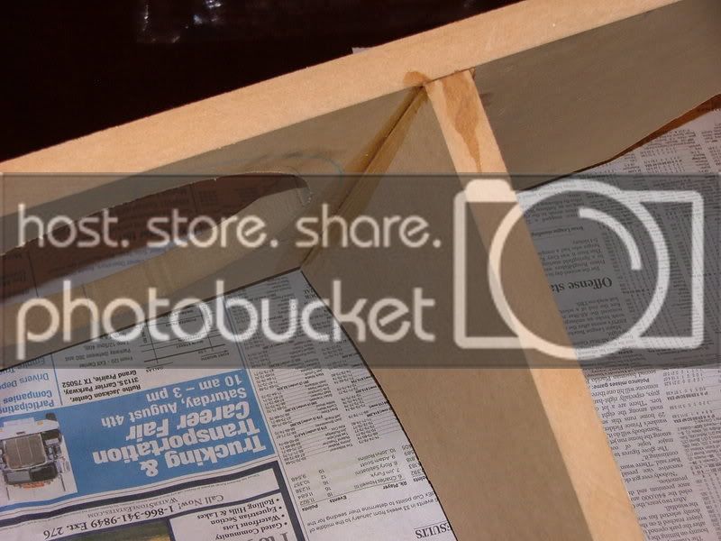

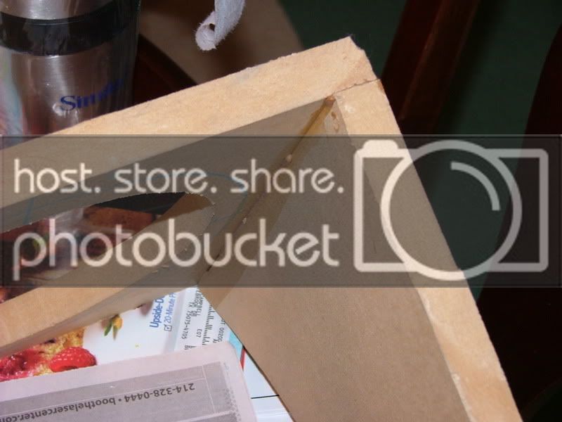

Some of my cuts were not exactly perfect though, lol... if you look at the 4th and 5th pics they didnt turn out to great lol...
