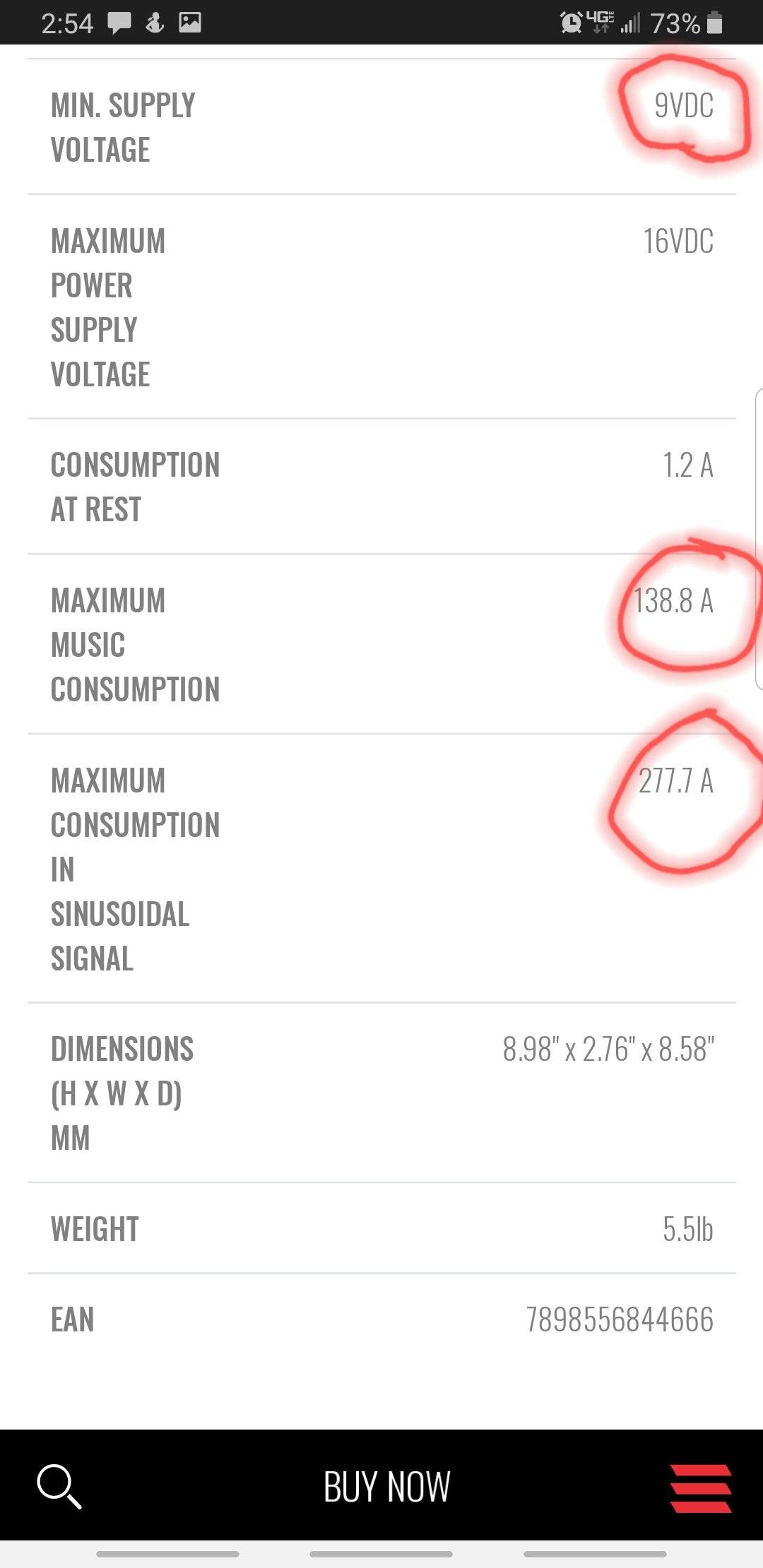

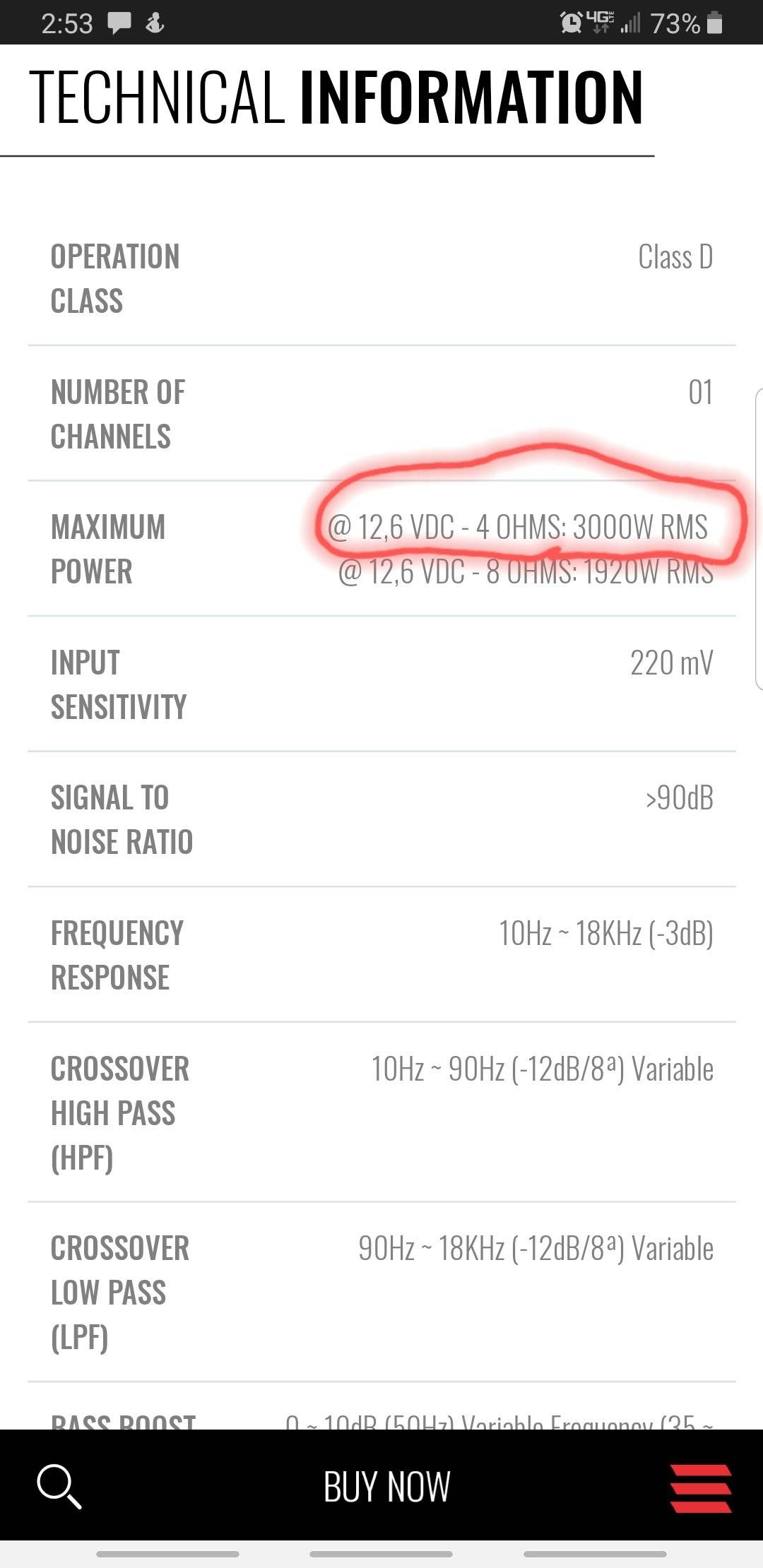

O.k., I did some research. What are your thoughts on a Taramps MD3000.1 4 ohm amp to push the AB HD15d2 at 4 ohms. It's roughly 3,000 rms. These are the specs. I highlighted the key parts to me. Thoughts?

The are great amps. I have had 11 Taramps amps and loved them all.
I’ve seen HD8000s dropped to 9 volts multiple times and shut off due to low voltage protection and they just kept coming right back on with no issues. The MD amps are even more better built. I would always wire as low as you can to combat impedance rise and if it’s too much power just lower the gain.

I will most likely order the MD3000 4 ohm model. 3,000 watts rms @ 4 ohms @12.6 volts. Now, what do I do with the Orion XTR2500.1? It's never even been installed. BTW, what does, "I fried a chine" mean?

Again don't buy the 4 ohm. Buy the 1 ohm and wire to 1 ohm.
If you ever went to sell the amp you will have a very hard time selling a 4 ohm version over a 1 ohm.

But the 4 ohm draws less current, which is what I need with my electrical in my bug.

But the 4ohm will draw less current, which is what I need with my questionable electric in my bug. Not worried about selling the amp.
