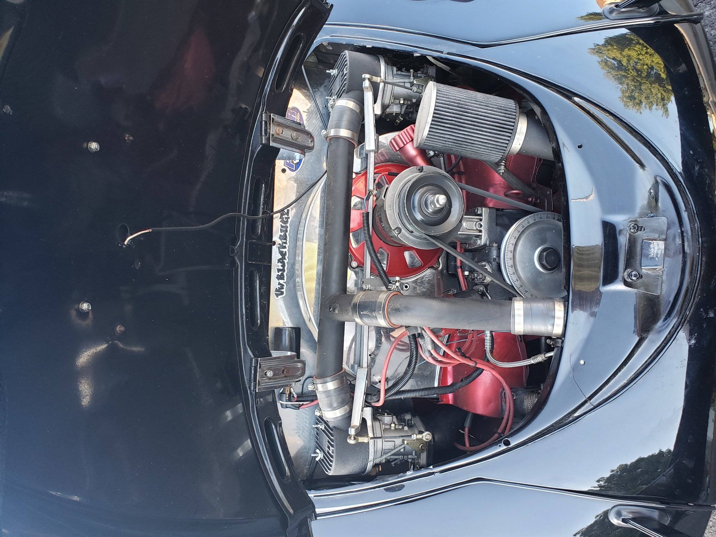

It's 12 volt and will have two batteries. The amp is rated at only 12 volts. I think the motor is big enough to keep everything going. 2,180 CC turbo charged.
