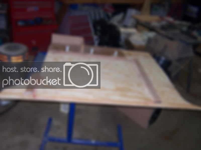

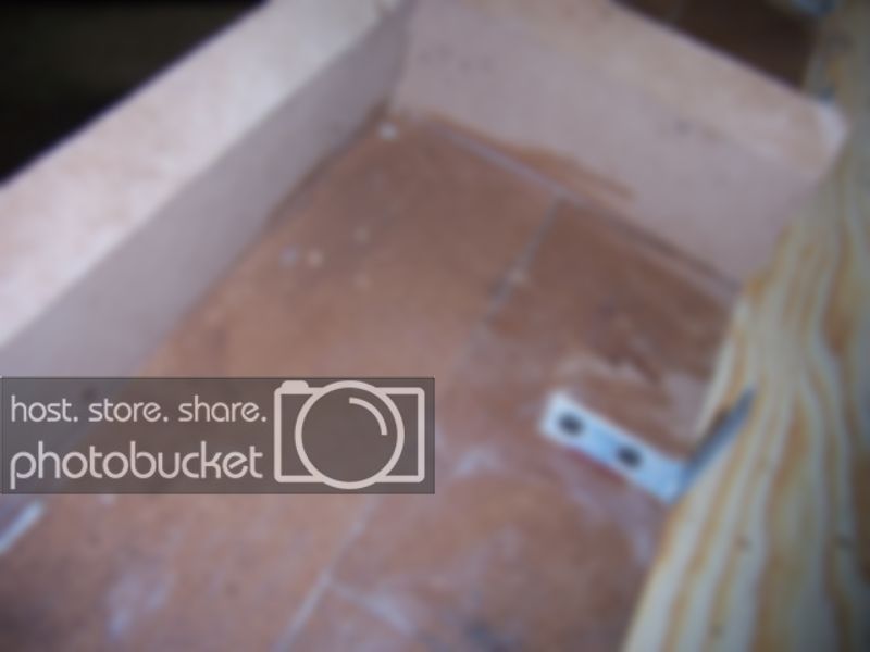

Well the plan is to re-glass the door panels. I am going to glass the mids on the same plane and point them both in flat, will get a lot more leg room too.
After I get to that point Im gonna order a new set of tweets glass the a-pillars.
