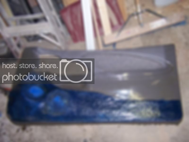

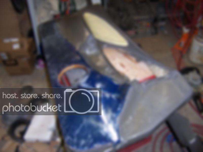

Small update, laid down a bunch of resin to dry over night. See where Im at tomorrow. Gotta pop off that fabric piece and then do the rest of the panels.
From there it looks like I can just get away with some bondo. I dont really think I need kitty hair but we will see. Could use some advice with that part.

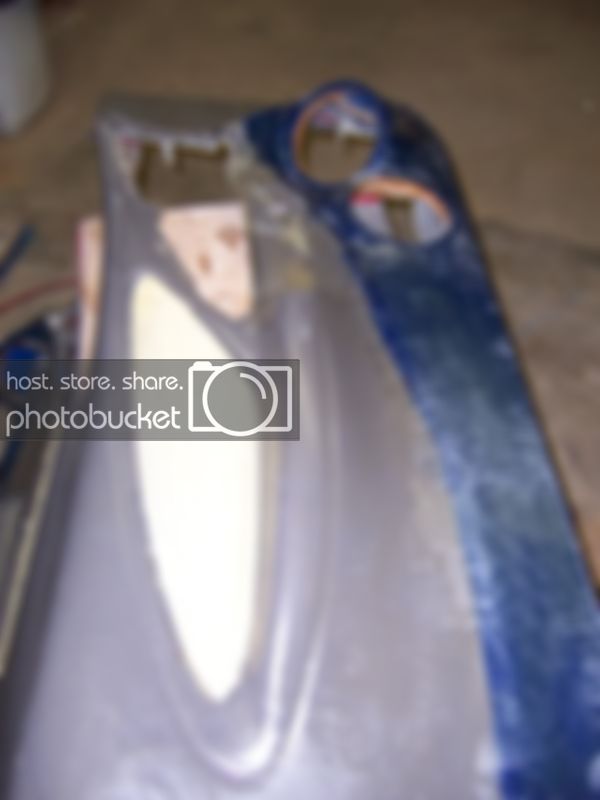

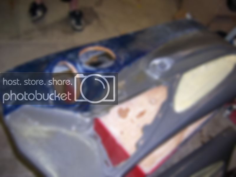

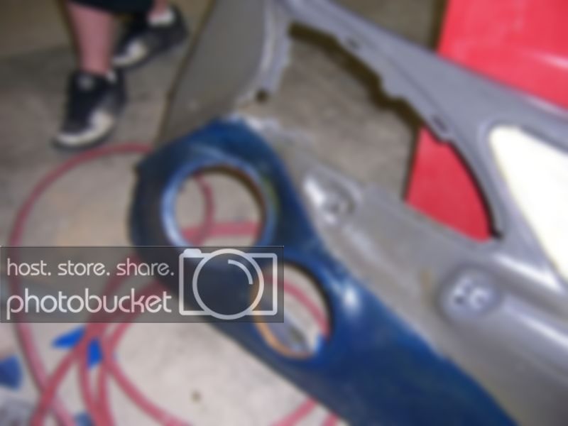

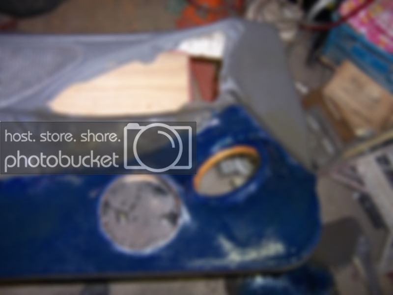

Got a little done today before finishing the other build I was working on.

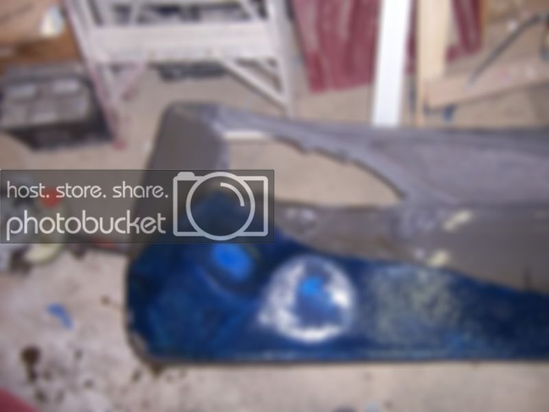

Got a lot more work to do on the passenger panel, but the drivers side is gettin there.

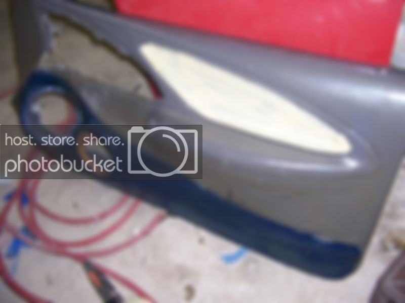

Gettin some high build and sealer tomorrow so I can finish them up soon.
Just need the vinyl to wrap them.
Is there actualy vinyl on those factory panels, or is it textured plastic? Did you just resin over the vinyl? I'd be worried a layer of resin on something like that would crack and flake off after you vinyl'd it. Just curious. I'd hate to see you put all that work into them only to have them come apart.

Is there actualy vinyl on those factory panels, or is it textured plastic? Did you just resin over the vinyl? I'd be worried a layer of resin on something like that would crack and flake off after you vinyl'd it. Just curious. I'd hate to see you put all that work into them only to have them come apart.Seriously, Rave "faux leather" FTMFW! after you peel the backing off, you probably won't even need a heat gun!

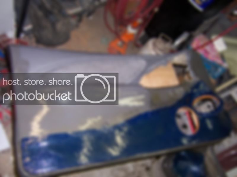

Well the bottom of the panel is just abs, and then from there up it feels kinda like vinyl. Its really rubbery. I was kind of worried about adhesion as well, I was gonna get some 40/40 and hit all the edges with it, but after checkin it out more today it doesnt seem like its gonna have an adhesion problems. Ill see though after I do some more sanding and glassing.
Any tips for something to coat on if I run into problems? I was gonna pick up some kitty hair but I dont have really anything to fill in or build up more. Gonna do some mat or cloth from the back when I get a chance too.

I can't think of anything that would really help. I've never done it that way. I'd probably wait til it's nice and dry and flex the door panel and see if it cracks anywhere. Ideally, I'd probably separate the panel into it's main parts and remove the vinyl and 40/40 it back together after I was done with it.
I like Duraglas (fiberglass reinforced filler, similar to Kitty hair or Bondo Glass) on parts that could benefit from extra bonding strength or rigidity.
My best suggestion would be to add some mat/resin to it and then use filler (or Duraglas or equivalent) to smooth it out.
