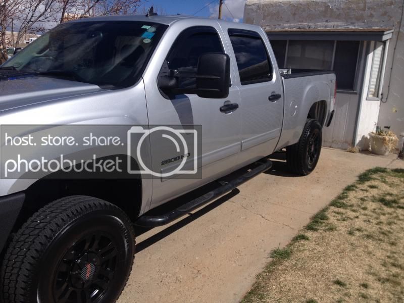

The truck now has 3400ish miles after a month of driving. Here's the truck as I arrived on a new location today:
The boss doesn't like when I get larger-than-stock sized tires. I don't know if have room to fit larger tires with the wheels fully turned either...it's close.
I will go with Goodyear Mud tires when I swap. I think they're will be very slightly larger but have much squarer shoulders on the tread. Stock will still look too small to me tho.

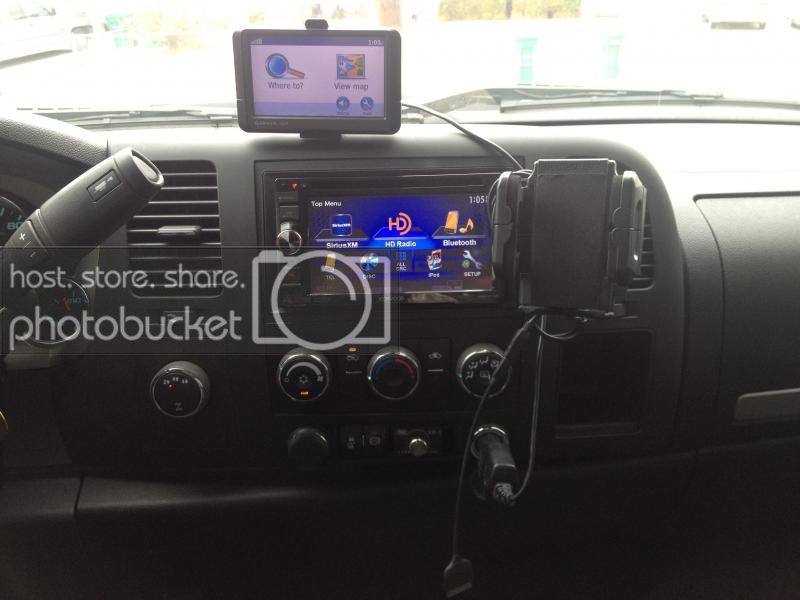

My very busy dash. Hands free blue tooth and booster + cradle for the phone. The right side accessory plug that the GPS is plugged into has been re-wires to only be on when the ignition is on or on accessory...not always on like they all were. The LC-2 is wired into the left rear speaker wires. I had to sand down the LC-2 to make it fit in the little opening in the dash. It sticks out too far, but it sure does work nice.

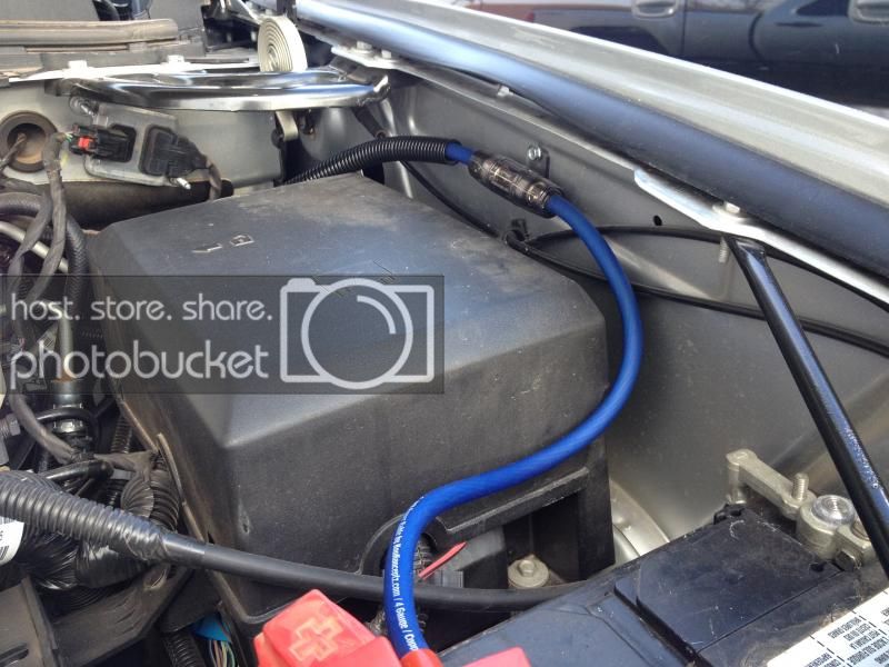

Installed the Knu 4 gauge wire. Loomed it to it went thru a grommet into the cabin since I had some loom around:

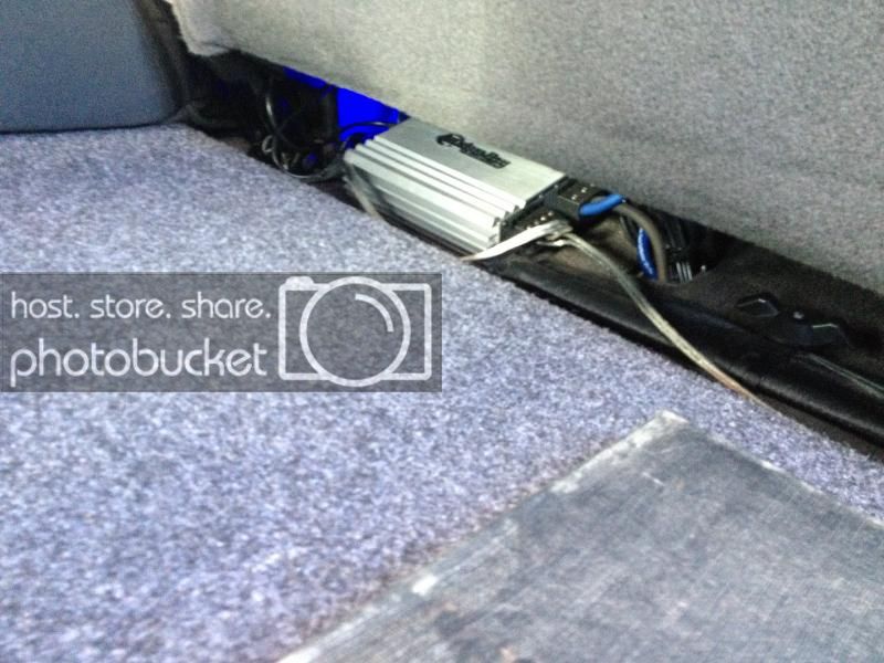

Amp wired and on. I double and triple checked everything every step of this install since I've never installed to a factory head unit before. It's under the back of the back seat. Wiring isn't clean but its never going to be seen so I'm not worried about it:

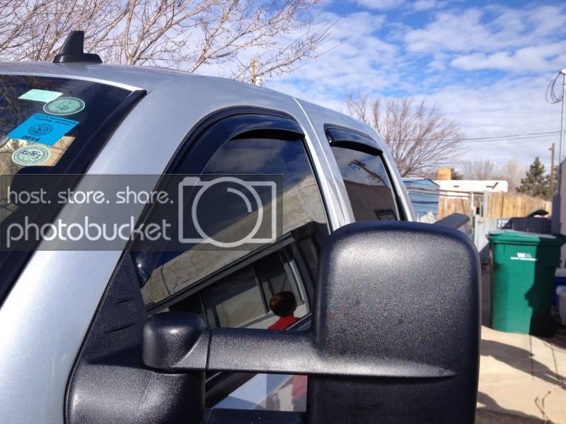

One more little thing this weekend... I added side window visors.
Before:
After:

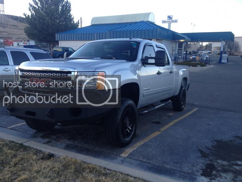

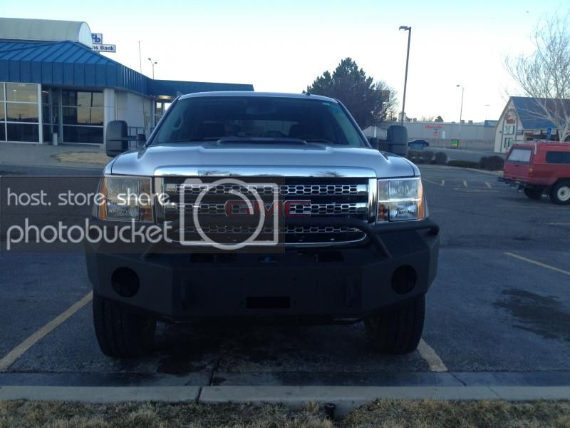

6700 miles on the truck now. I've been working a lot lately and haven't done much except for wash it once or twice, until the new bumper came in.

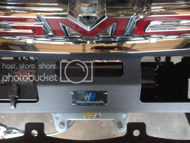

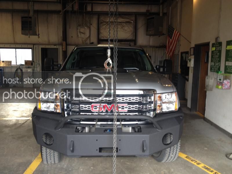

Hammerhead Armor with pre-runner style hoop:
I need to get some lights and a winch for the truck now, but I want to build a new sub box first. I still haven't added the deadener to the front doors even tho the door panels have been off twice now. I was just looking at the back seat mounts and think I can raise it 1/2"-5/8" safely and easily with some spacers giving me just a touch more room for my new box.
I found a winch in town for cheap today...

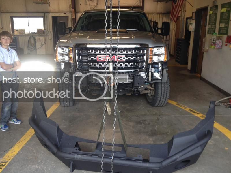

I ran down to the shop where I could use a jib crane to hold up the bumper:
...and pulled the bumper off

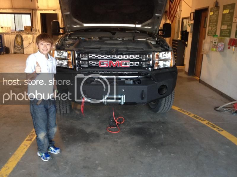

Slipped the winch in then re-installed the bumper. (Hadn't hooked up power in this pic)
Top view of the winch. I had to buy a couple of 4.5" clamps to fit the power unit onto the motor of the winch. Turned out OK.

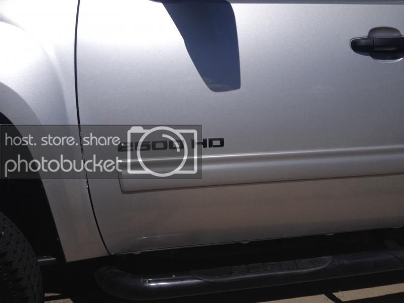

Still haven't deadened the doors or worked on a sub box. I did however Plasti-Dip some chrome emblems to black...
And the real pain done with a lot of razor work... I never did look to see if I could remove the letters it would have been much easier

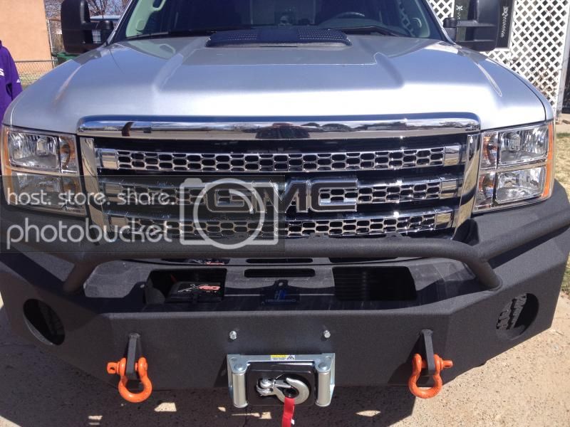

I also got a Daystar winch keep-er-staight-er thing and a couple of 3/4" D-rings on the bumper.
