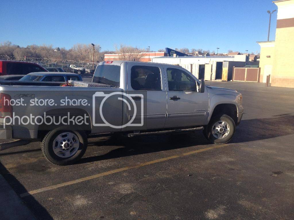

My boss got me a new work truck. It's a 2014 GMC Sierra 2500HD with a Duramax. I had to give up my old truck which was a Megacab, So now I feel cramped for space something severe.
The new truck:
It's pretty plain, but I'm also lucky because the boss doesn't often buy us new trucks. We do need trustworthy, tough trucks that can drag trailers off highway. The Duramax is strong. If this thing had wings...

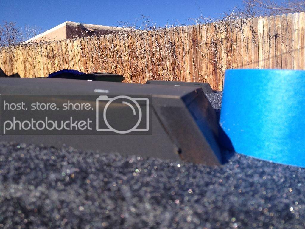

My mechanics work fast which causes things like scratches and dents in the bedrails when they install toolboxes into the bed.
Well, I know how to fix that... Bushwacker OEM style bed rail covers.

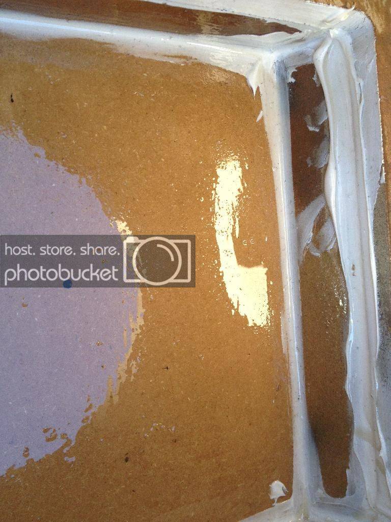

To make the flimsy stuff a little tougher I did a layer of resin, a layer of fiberglass cloth, then a couple more layers of resin.
Then I flipped the box over and did a couple layers of resin inside.
I didn't add much to the height of the box or limit the mounting depth by coating the wood with resin. I'm not going too crazy with this truck anyhow.

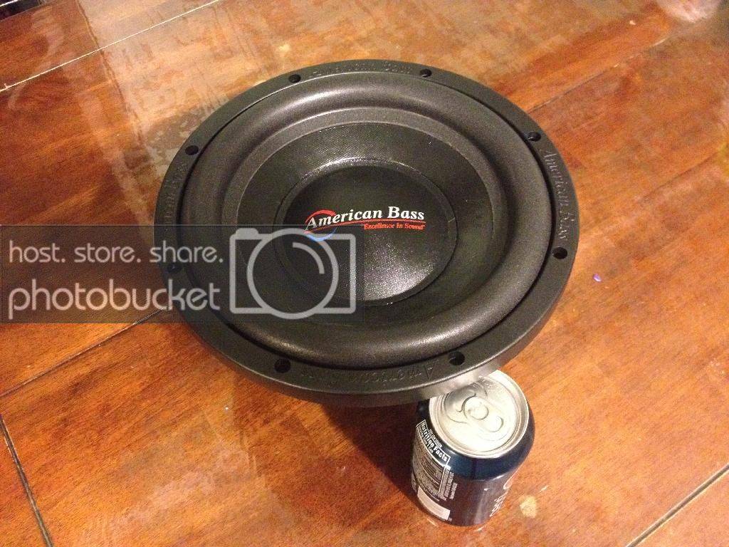

I just lowballed for some AB DX10s (Not the XDs previously mentioned) and got them so I also ordered my mini AB amp. We'll see how this works. Maybe I'll just remove the back seat and throw my 3 - RD Alpha Max 15"s in there and tear this **** up.

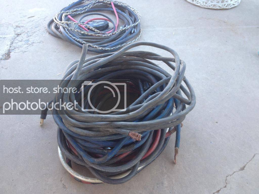

I started building my amp install kit. I thought I had a 4ga amp kit it storage but I'm guessing I gave it away. I've decided I'm going to use a Kicker 1/0 power wire w/ a Kicker 250amp fuse and a Knu Koncepts Kolosus 1/0 ground, then step down to 2 gauge within a foot of the amp. I found a weenie blue wire which will work perfect for a sensing wire and a set of twisted Kolosus RCA. Now all I need is a high/low converter.
Amp install kit. I've got tons or ring terminal, solder and bolts for making this happen.
Extra 1/0 (For use in the next ride I do competitions in). That roll weighs around 60lbs on the arm scale...
Changed my mind on the wiring. If I leave and have to evacuate the truck quick I'm not going to want to take the time to remove the wiring. I have a knukonceptz 4 gauge amp kit in the mail. What I did get today was:
2x American Bass D4 DX-10s(Thank goodness for the dustcap logo being sensible and not like on the site):
American Bass - DX 10

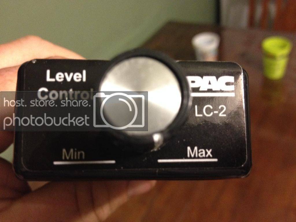

I also received and I'm excited to try this PAC LC-2:
I've seen this thing mentioned a couple of times and I still haven't figured out exactly what it's for. Is this a replacement bass knob? Is it even a bass knob? What's so great about it?
