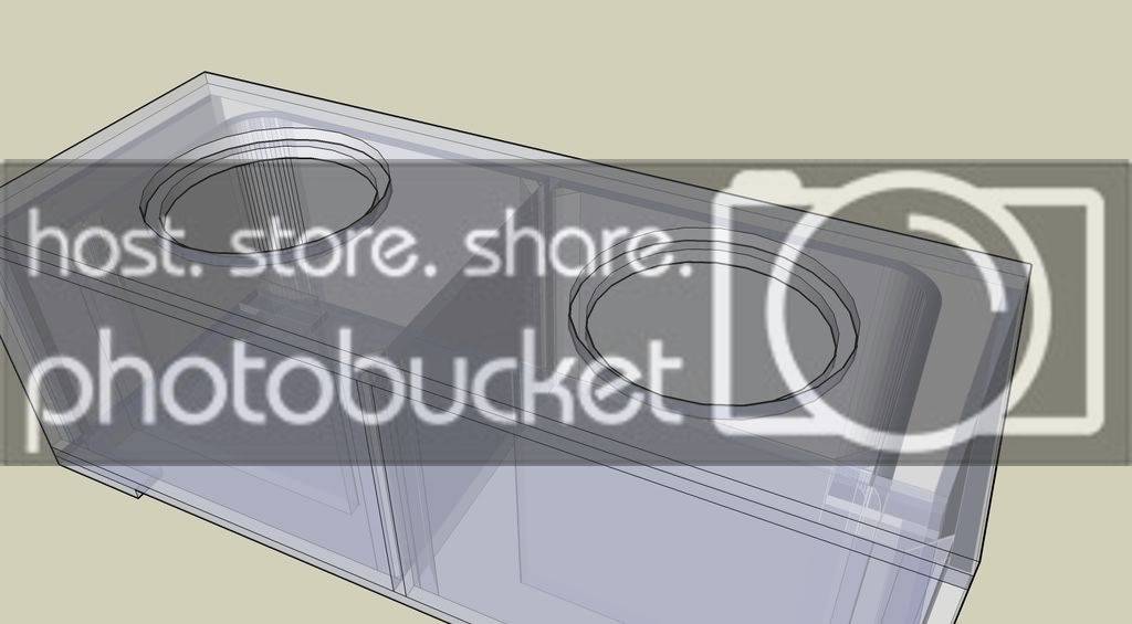

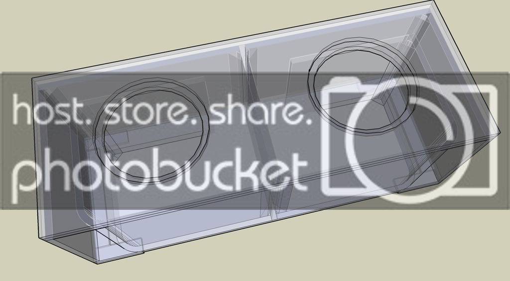

Each 12" Re Se subwoofer is placed in a 2.3 ft^3 (net) chamber tuned to 29hz. The box is a top firing / port back enclosure design for a tahoe. The Dual slot ports are kerfed. Box will have angle bracing as well. Subs will be flush mounted, and the box is going to have legs to let wiring pass under it. for a huge display rack that we will be building when he comes to pick up the box. (for his amps, crossovers, distros, fuse blocks, and battery.
I believe hes running 2 x600.1 PG AMPs, and a 300.4 for his mids. which are PG RSD's.
Anyway. On to the pictures of some progress.

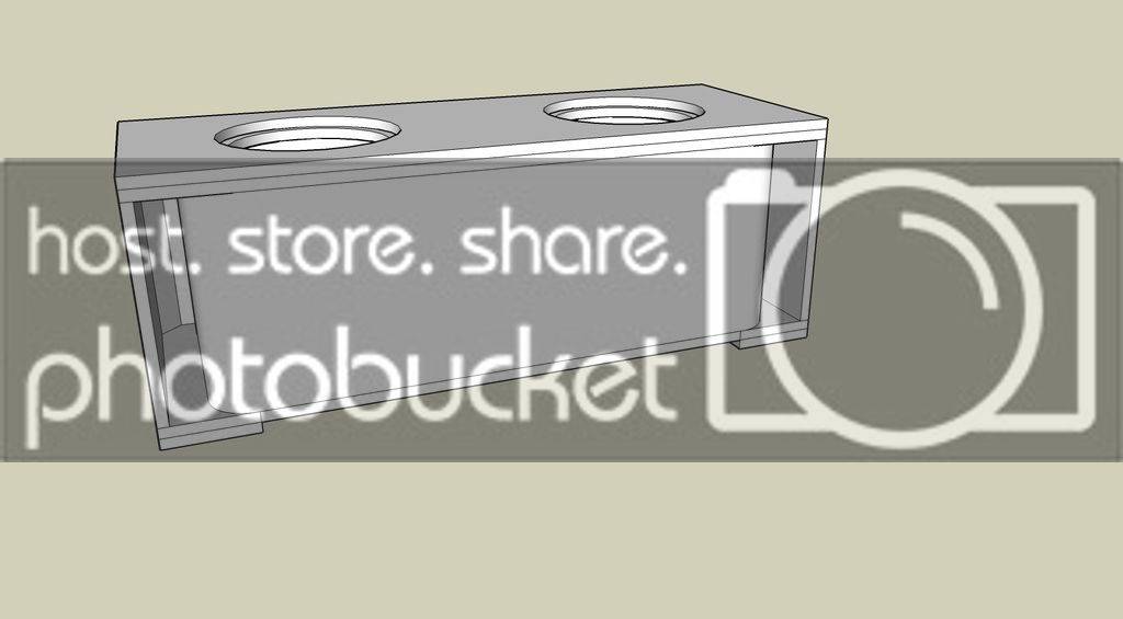

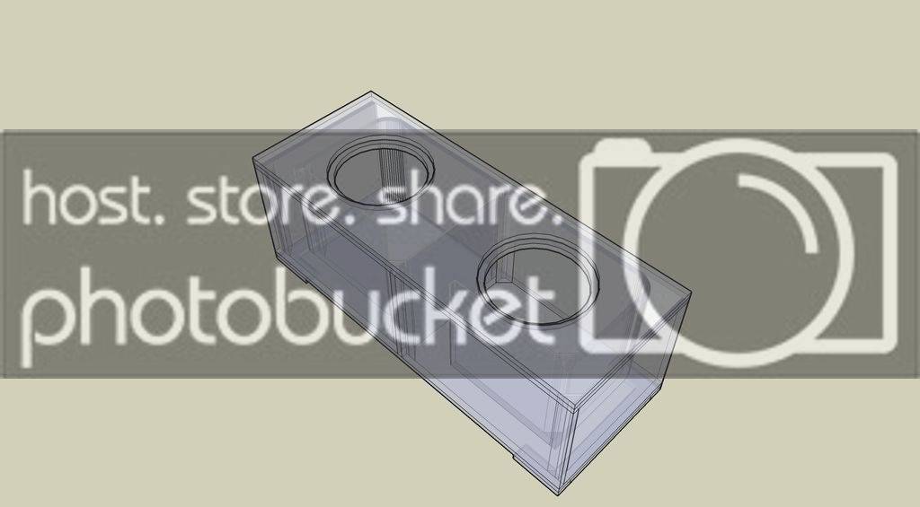

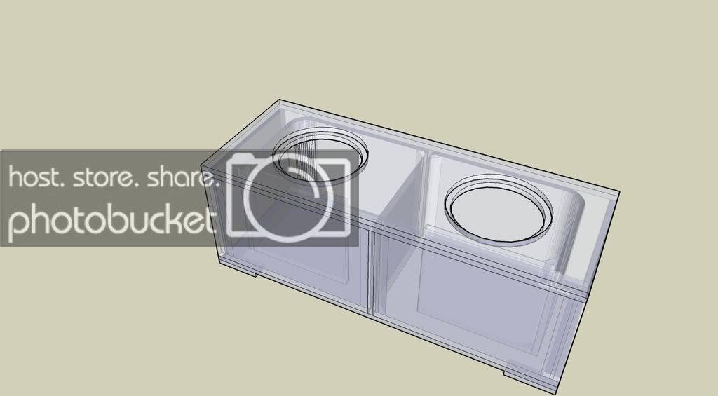

Design (Dimensions Ext: 47.5W x 17H (without legs and Double Baffle) x 18D) Each Port is 2.25 x 15.5"

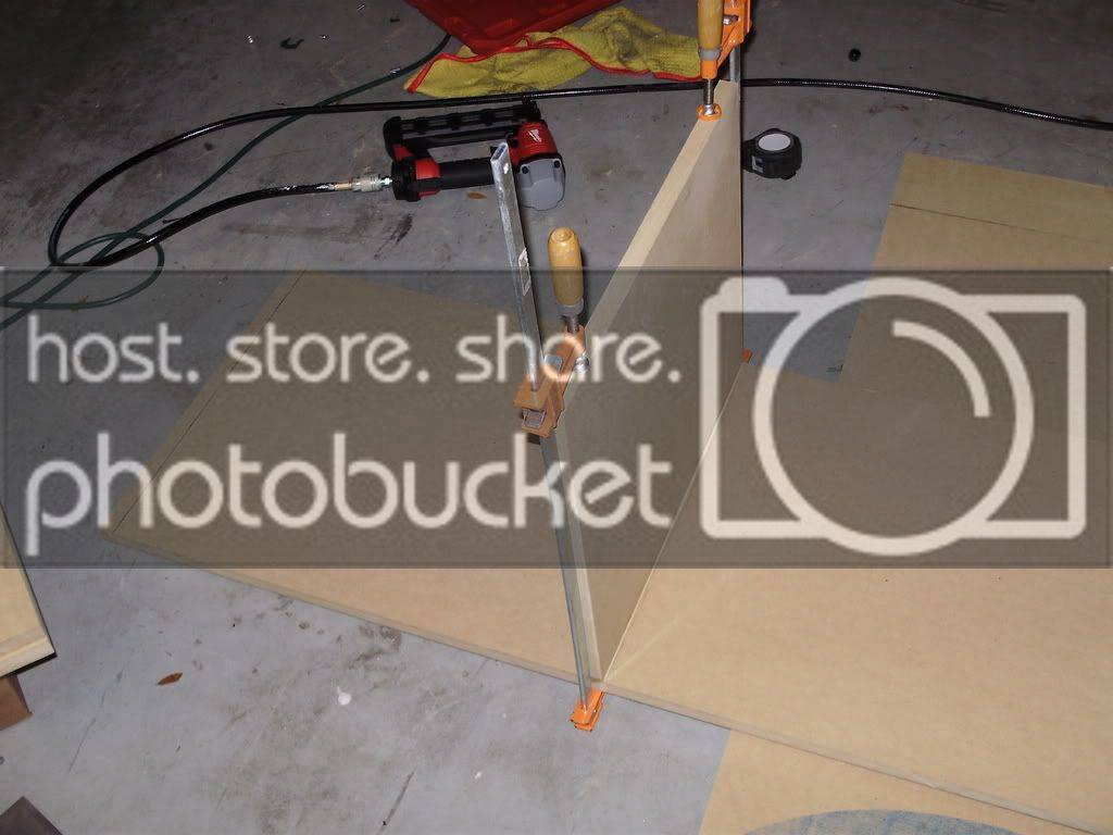

Setup (Rigid Contractor Saw TS-3660 (with zero cleareance insert, Porter compressor / nailer.)

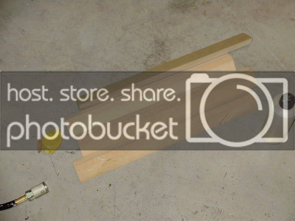

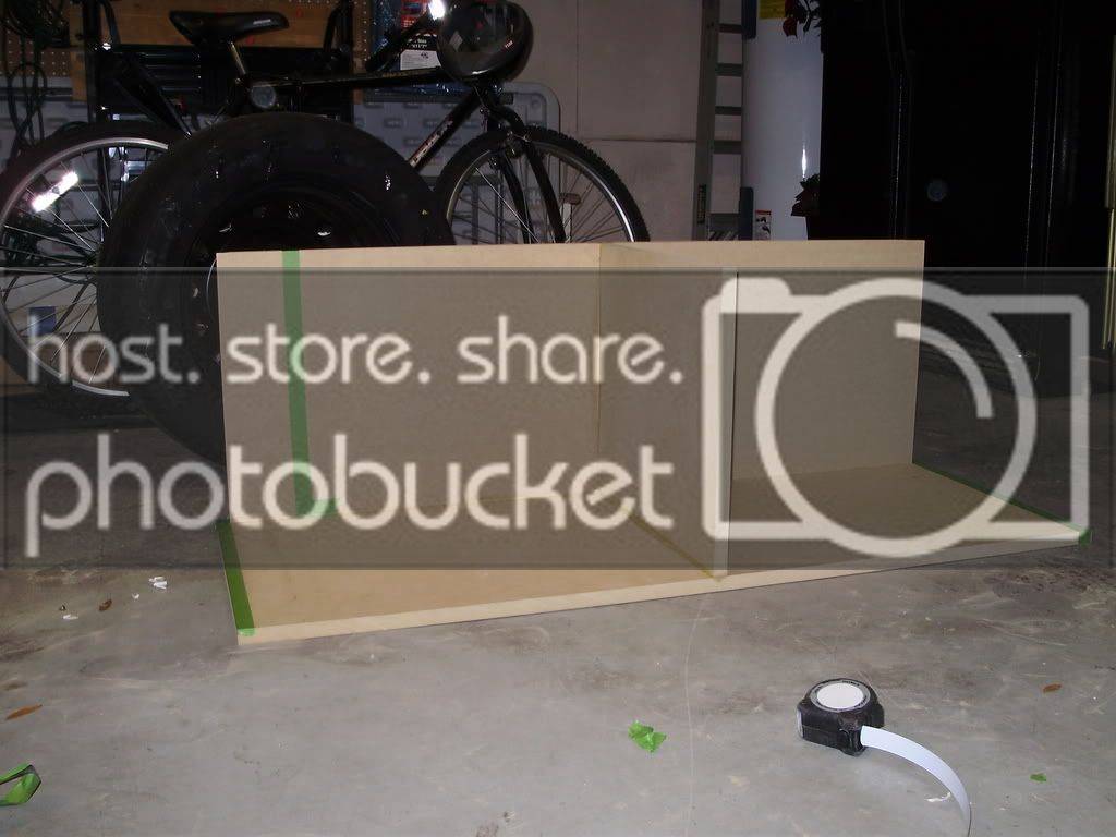

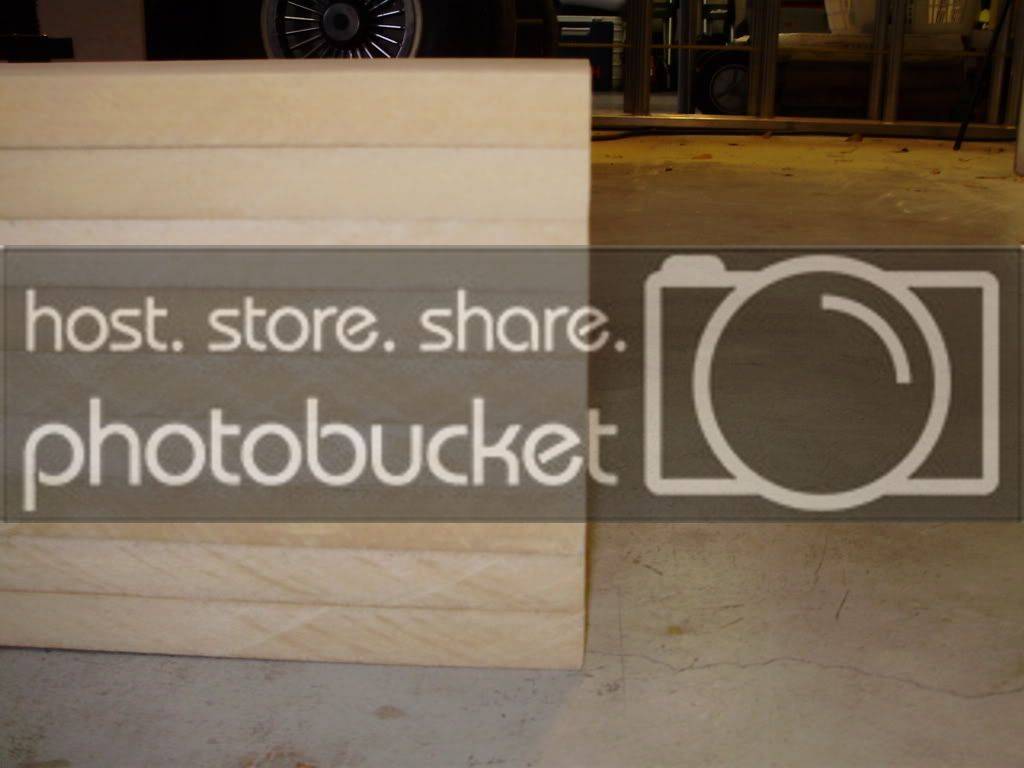

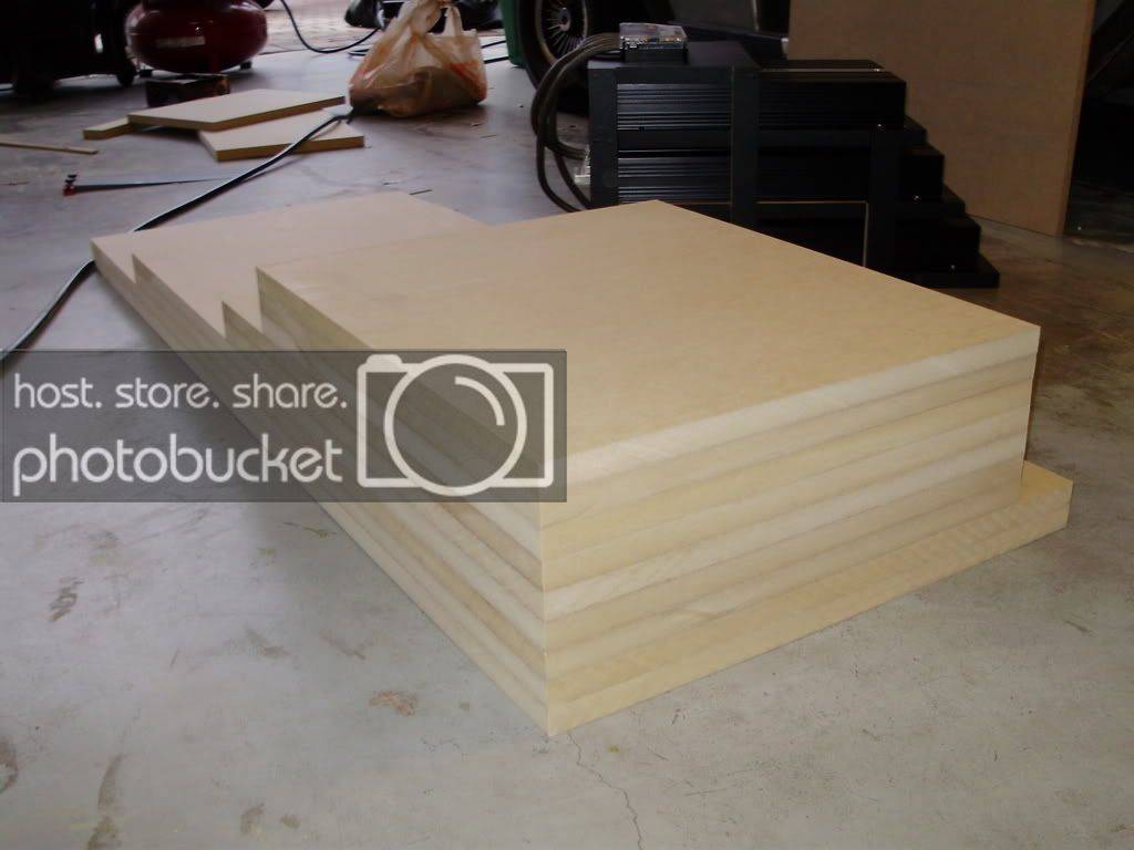

Cuts Lined Up

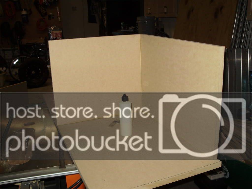

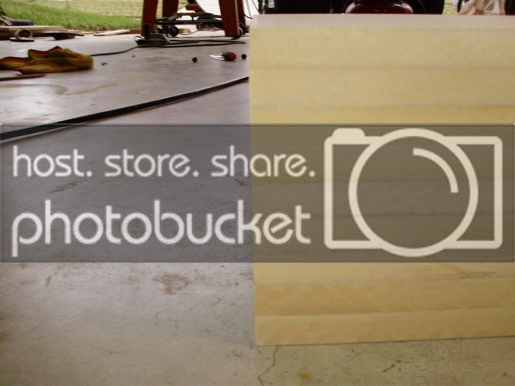

Lined Up. so straight. Table Saw > circular saw and sanding

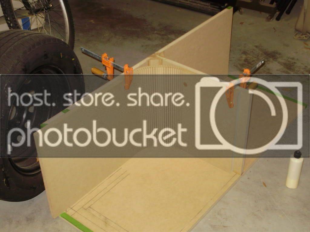

Its has begun

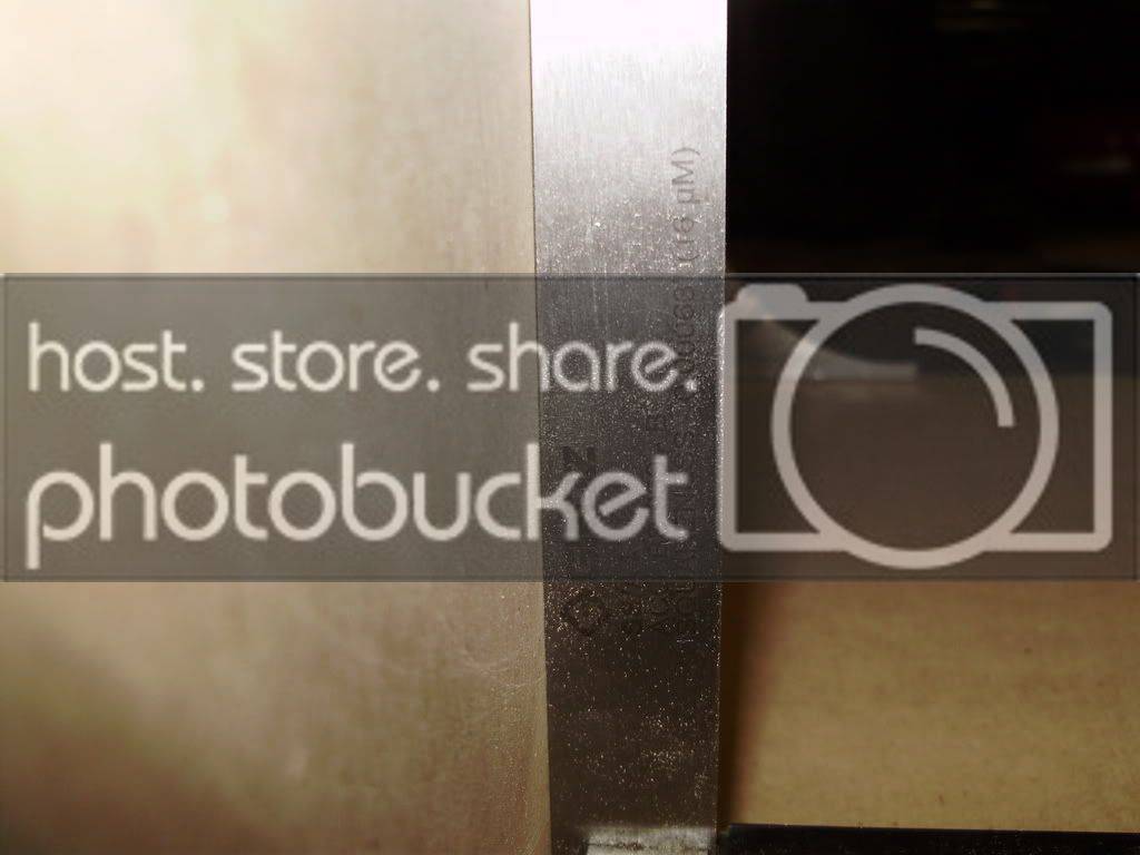

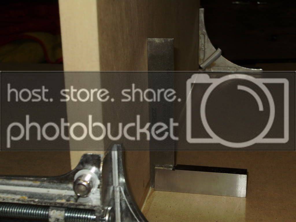

Engineer's square for the exact 90 degrees

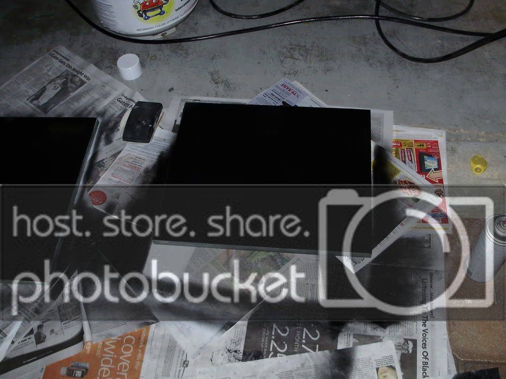

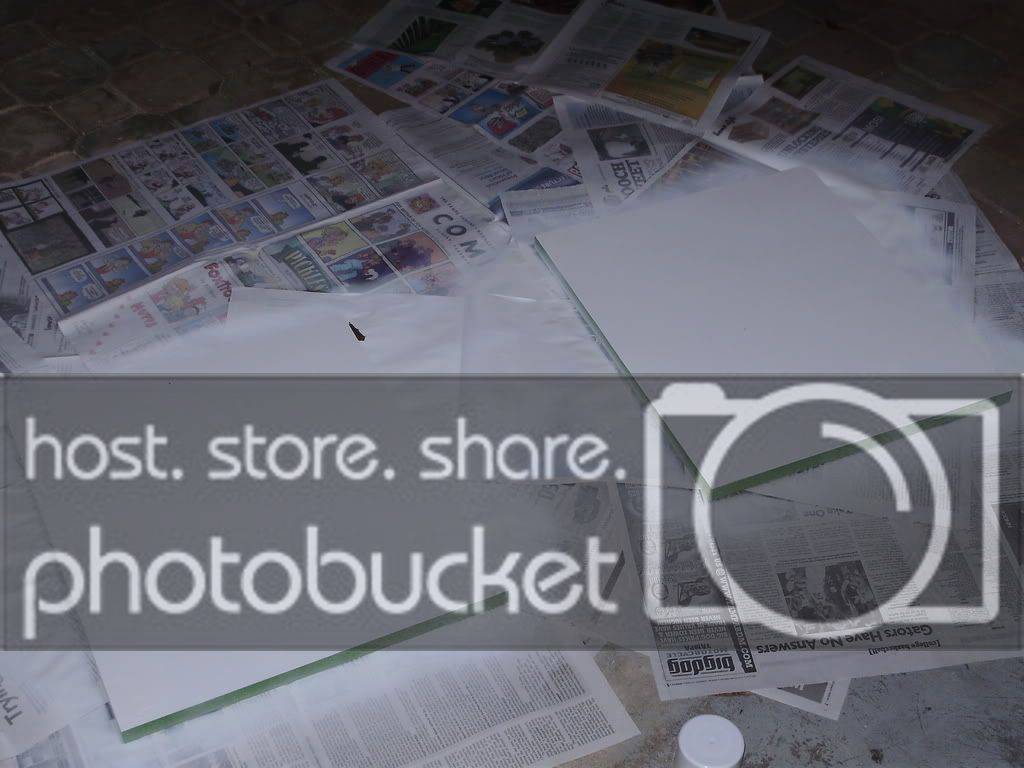

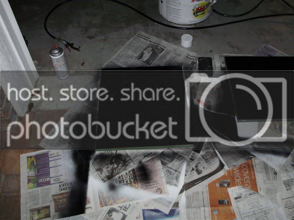

While this was drying i was priming the sides of the box, and inside port wall.
Black followed
While the paint was drying, assembled the backs
Masked the edges off to prepare for priming and painting

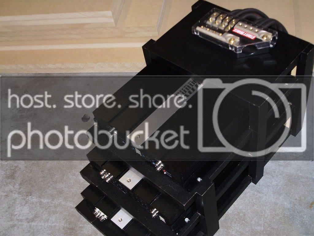

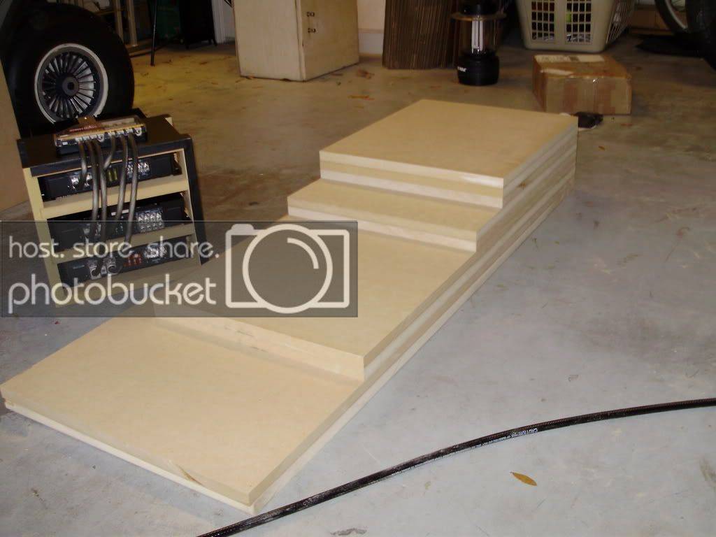

1 more of the amp rack. (first attempt at vinyl) wierd unflat surfaces so it was hard to get edges right.

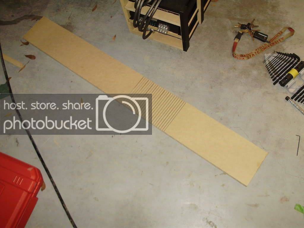

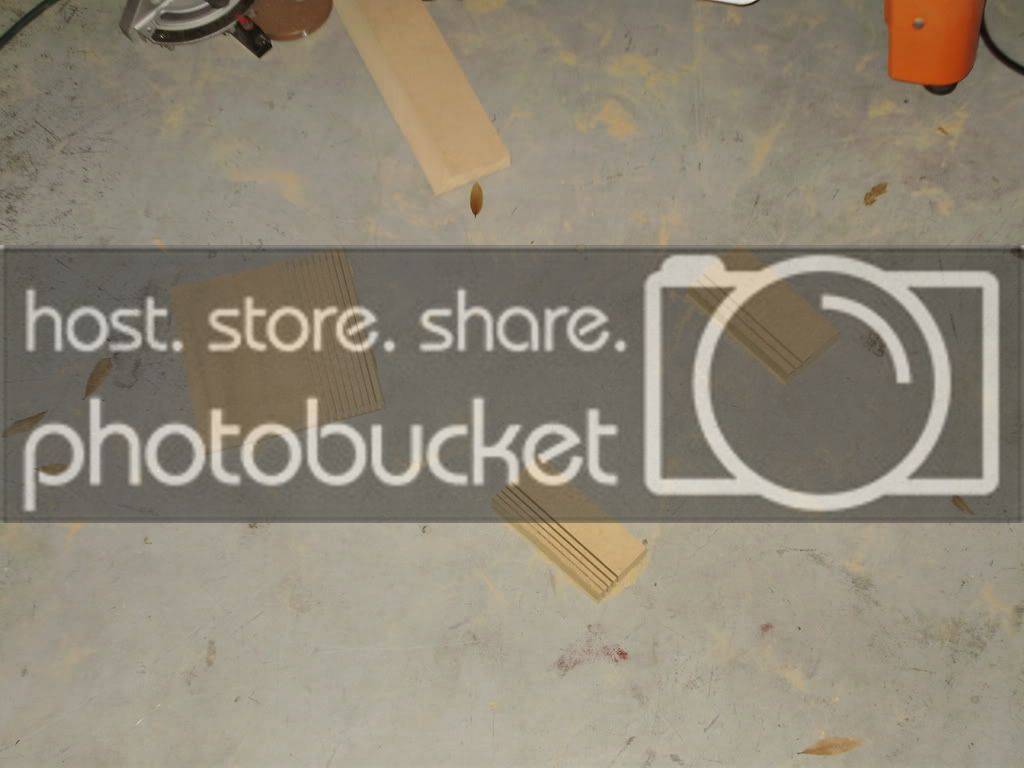

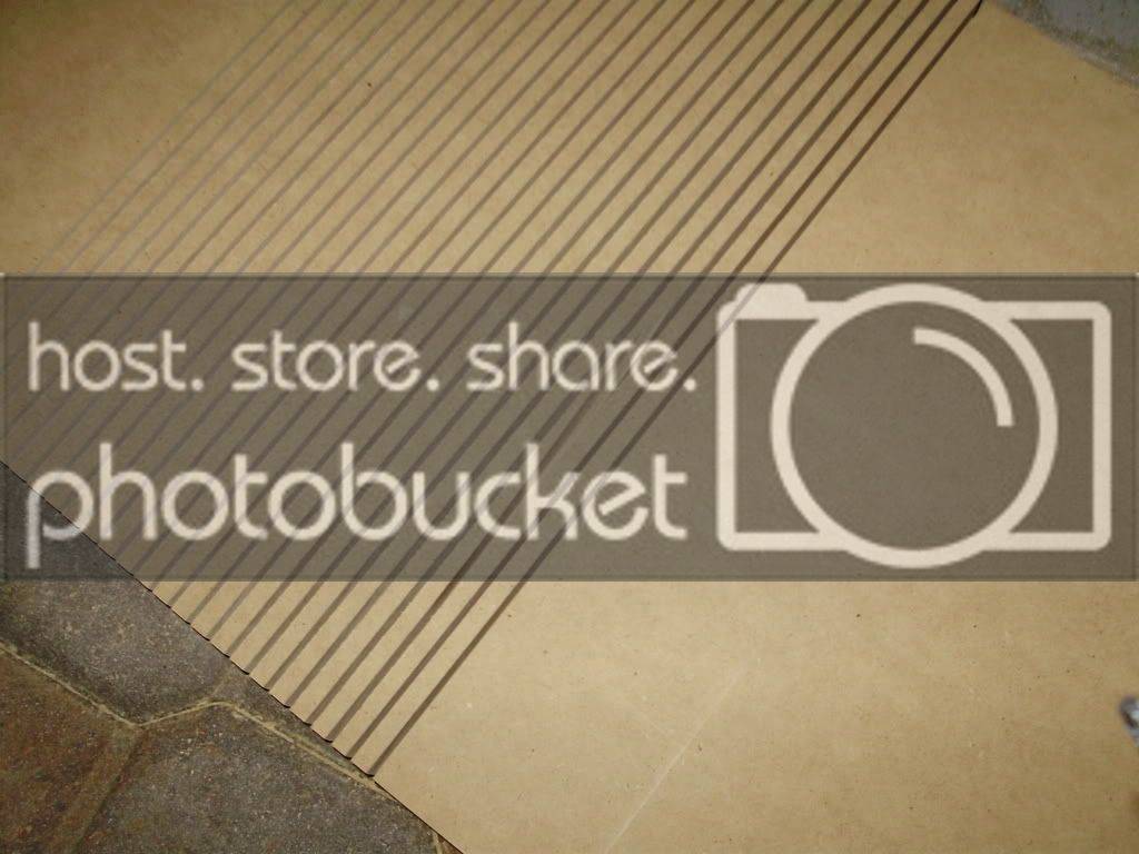

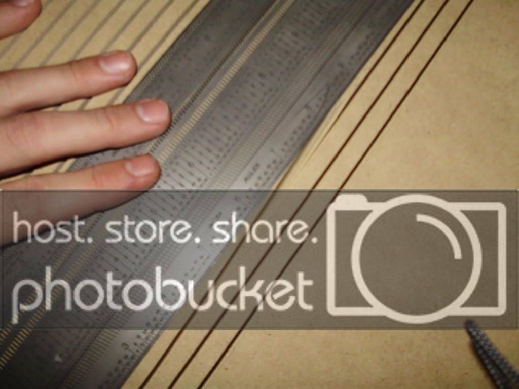

Finalized version of number of kerf cuts and spacing needed in 3/4" wood to get desired effect. this is the completed (successful test piece)
The scraps of the not so successful ones

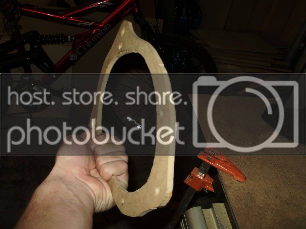

as well as make some quick 6x9 adapters for a Camry.

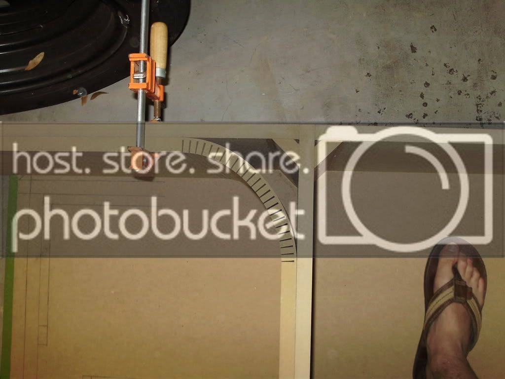

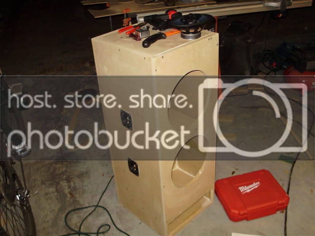

first front panel made and kerfs cut. then braced against the box and see the fit and finish and angle it makes
loosening it up
second front board.
slight run away on 1 of the kerf cuts. led to a 1" diagnol slice. however it didnt go through to the next kerf, nor did it impair the kerf it was a part of. so it will be filled in when bent like the rest.
