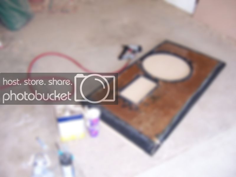

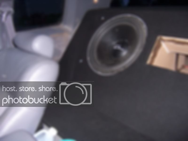

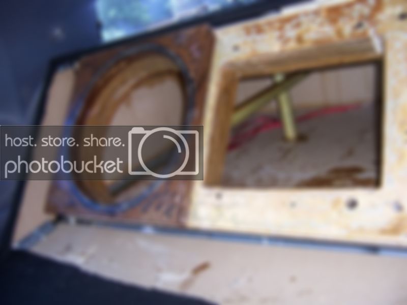

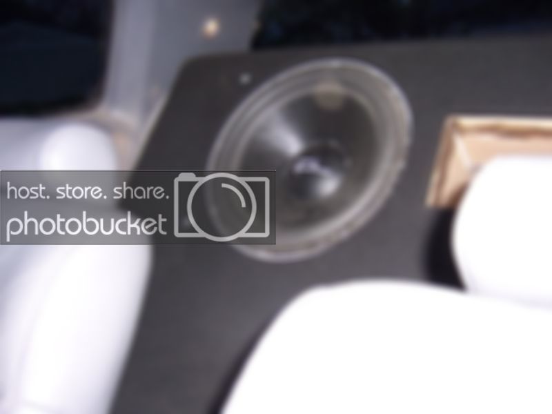

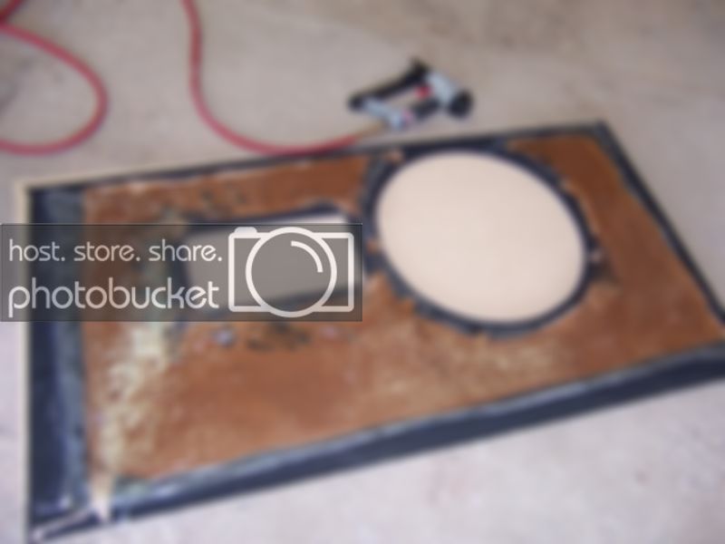

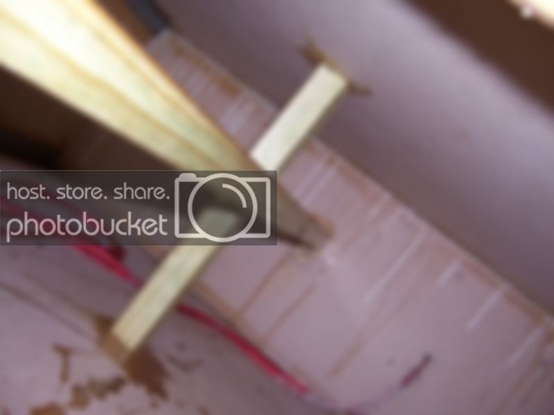

Well I finally wrapped the inside panels. Its almost sealed off completely now, I foamed up some spots but theres still some areas I need to fill in and I still have to glass the rest of the enclosure...including the braces cuz I broke them loose.
But heres some pics...

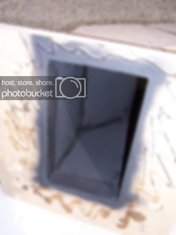

And yes the port will be painted black. I didnt waste my time or the paint on this one because it wont be the last one I will be using. Im going to order a set of duct work flares for the ends of the port and make a new one with the flares.

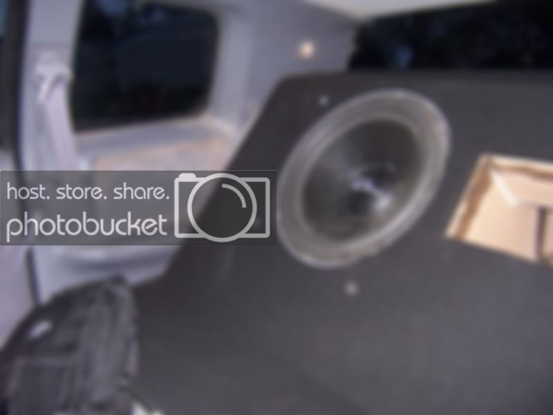

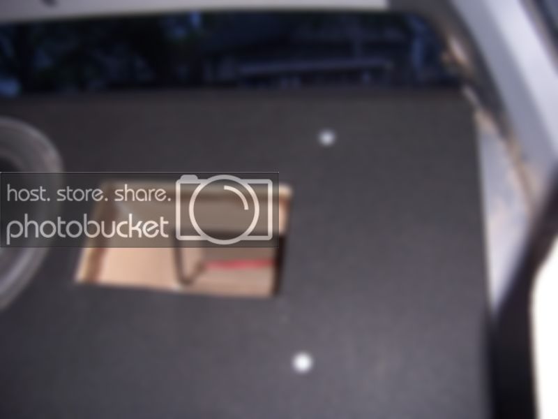

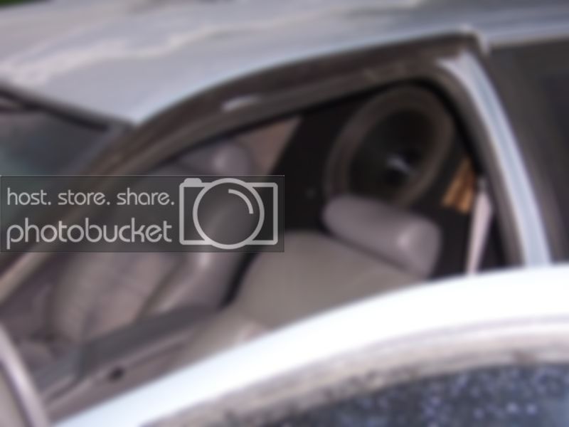

Got some more stuff done so far today. Ive got a killer idea for a grill on the front that I may get working on here shortly. In the mean time I got some pics while I wait for all the resin to dry.
Nice setup, I like how you took your time to do the lil details to clean it up and make it look so presentable. With a BTL 18 and almost 3000w I know its loud vid quality or not, great job! //content.invisioncic.com/y282845/emoticons/thumbsup.gif.3287b36ca96645a13a43aff531f37f02.gif
