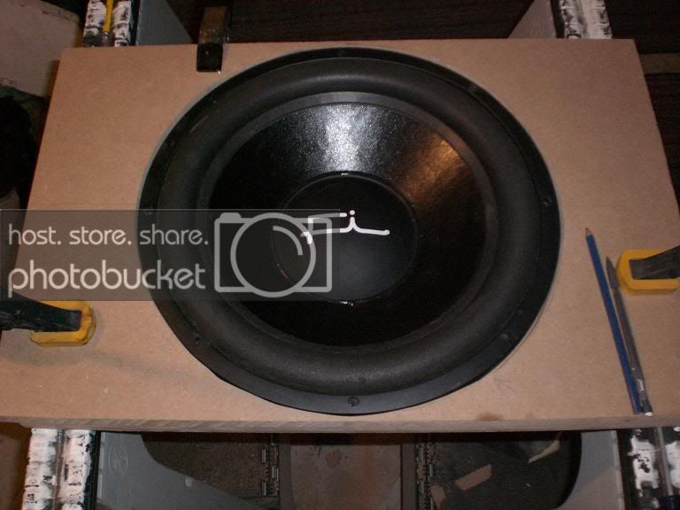

hey everyone. this is my first build/install/system. I'll be running a 15" Fi Q w/ BP option and slappin a RF T10001bd to it, in a ~3.7cu.ft. ported box tuned to 32hz. suggestions/comments/concerns if you please:)

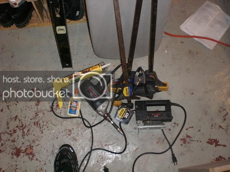

my oldschool tools, not state of the art, but they work:laugh:

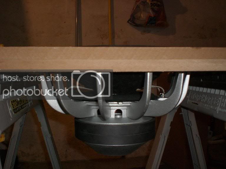

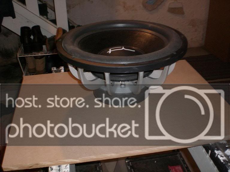

here's the Q...bought from 97cavy (thanks again:cool:)...its a heavy little guy i must say

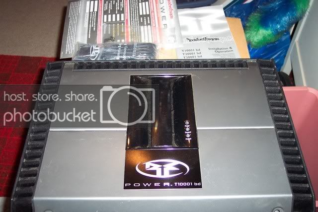

Rockford Fosgate T10001bd..should be here *hopefully* any day now..thanks assman for hookin me up with some pre-pics:cool:

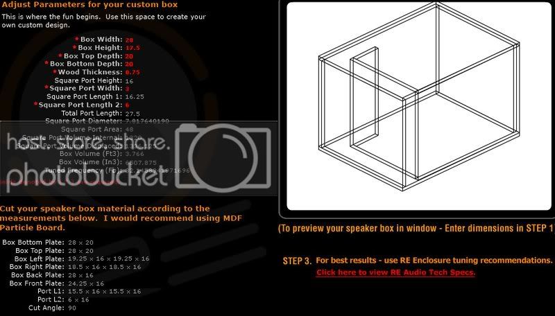

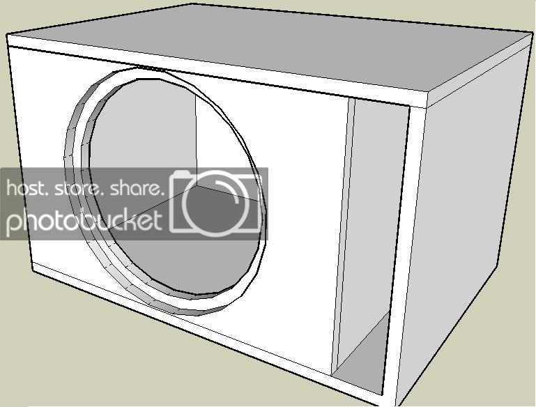

Here's the box designs, used the RE calculator on it, hopefully it sounds decent:rolleyes:
used sketchup to draw a little skeeematic

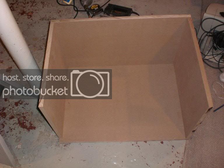

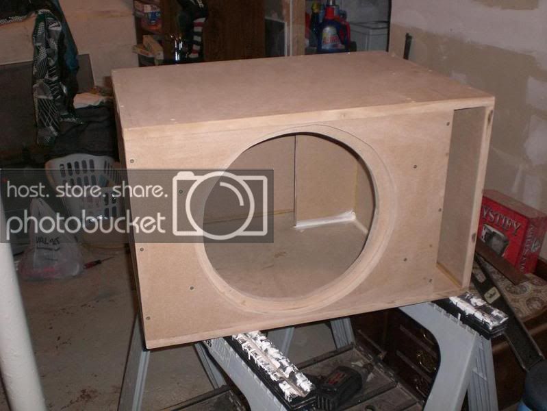

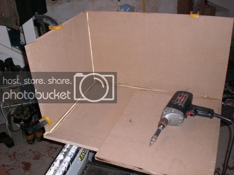

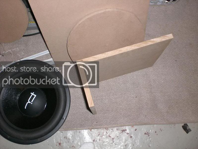

got the 2 sides and back screwed in real quick, dry fitted too, everything fit pretty good (didnt get a change to get the dry fit picture)

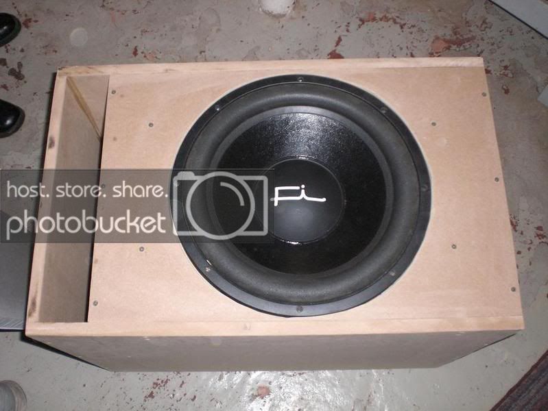

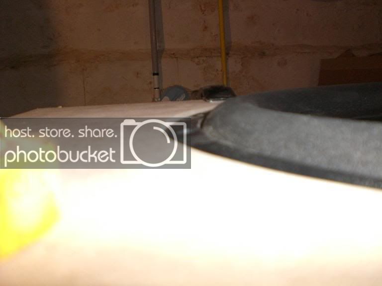

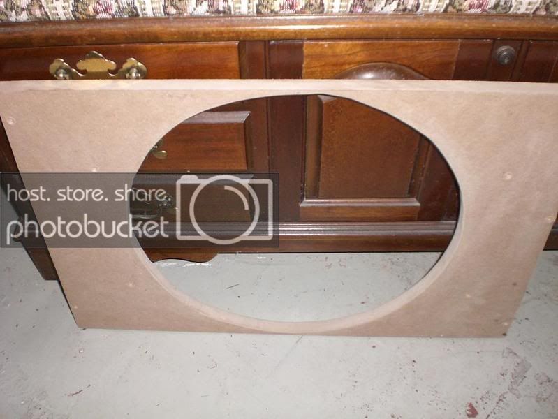

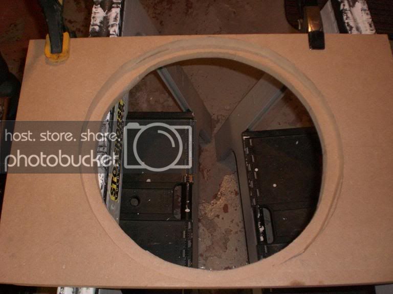

I guess you could call this a baffle? wanted the flush mounted look kinda deal:p:

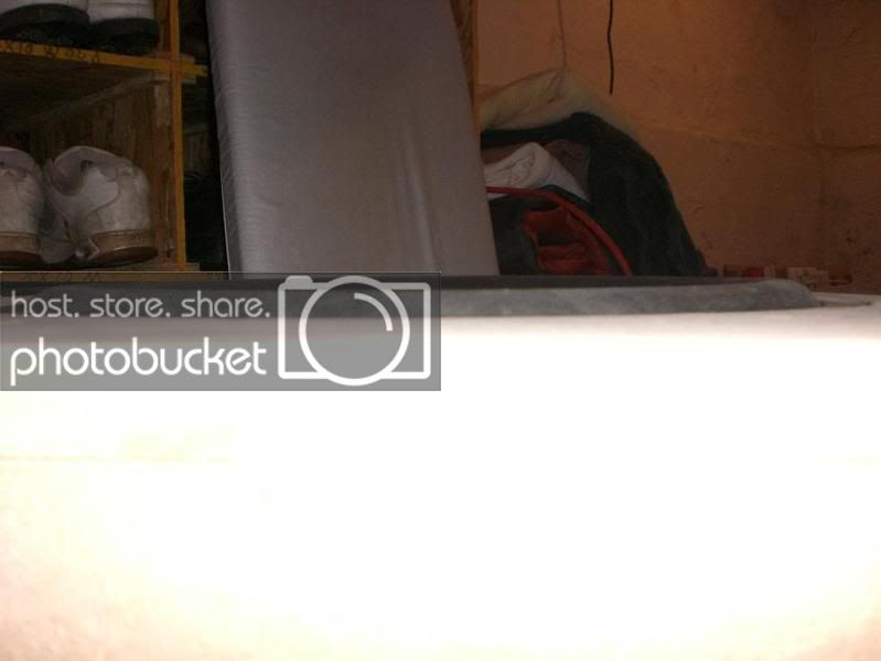

a little rough, but a few minutes of sanding and minor shaves off with my jig
seems to fit decent for right now..

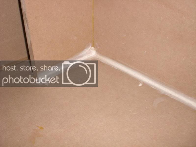

on to the glue'n!
only got the back and left side done last night...i dont think i used enough glue??//content.invisioncic.com/y282845/emoticons/frown.gif.a3531fa0534503350665a1e957861287.gif
that's it so far, going to get the next side on tonight...hopefully ill be done with it by the time my amp gets here!

yeah, the beast nails was my step dads that he had lyin around the house, so i thought id save myself some money...alternatives? or just say screw the liquid nail thing all together?

I was having a hard time deciding how big i wanted my box to be...it took me a good week to get a design that fit in my gay trunk...this one should fit pretty nice, i think ive seen a few people with enclosures that big...hopefully it sounds good..

build looks good..i personally think u could have went wider on the box...so u can decrease in depth so u can buy back alittle trunk room....but other than that 3.7 with 48square inch port should be nice and loud

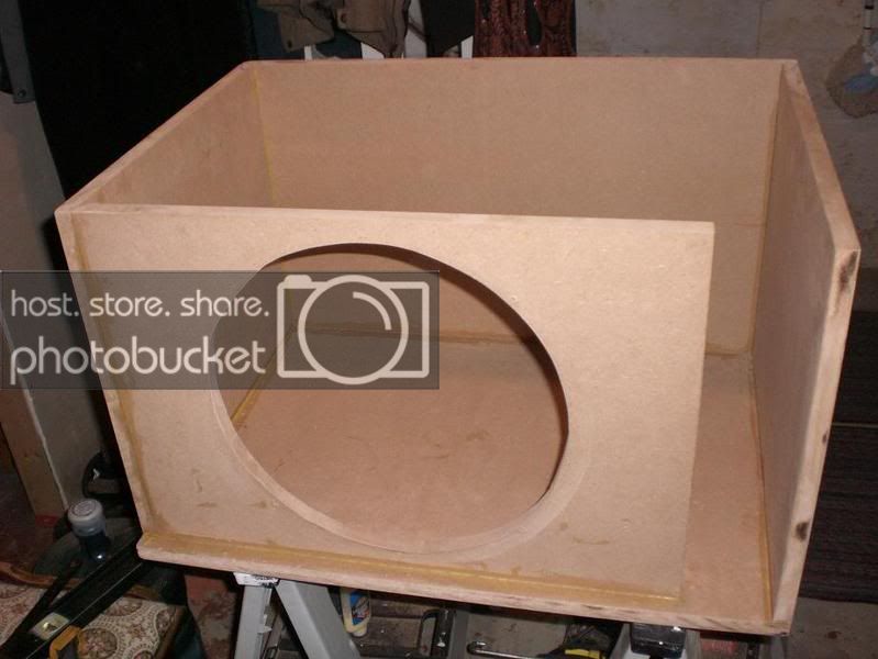

Got a few more sides done on my box today... did some sanding...and put it in my trunk to see if it fits, and it does wonderfully //content.invisioncic.com/y282845/emoticons/biggrin.gif.d71a5d36fcbab170f2364c9f2e3946cb.gif

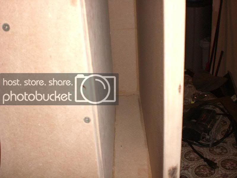

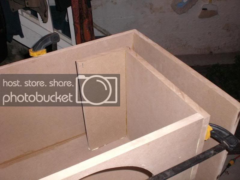

put the 2 port sides together and put on the inner front side...i didnt think that one out too good cuz i couldnt put any screws to the front/port...hopefully it doesn't cause me any harm in the long run..also i dont think my cut was perfectly straight on the bottom, it wasnt touching on the entire thing...but i got 3 screws in the bottom...im prayin it will stay good enough:crap:

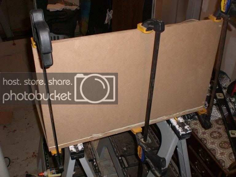

port pieces glued screwed and clamped
next piece to go on will be the outter front piece...then the top:veryhapp:

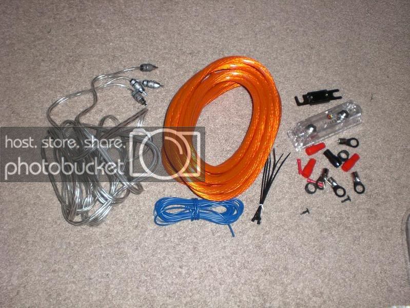

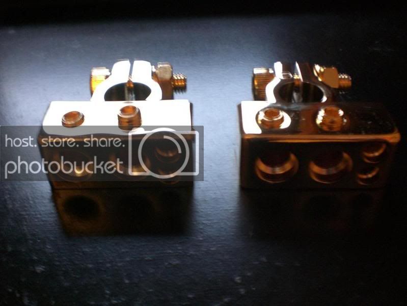

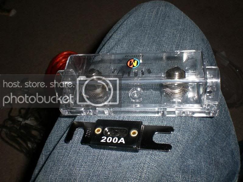

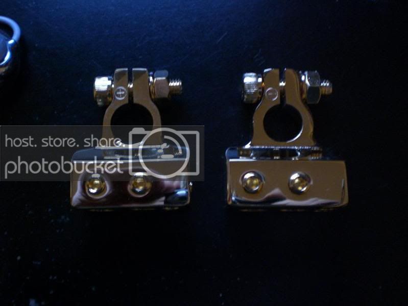

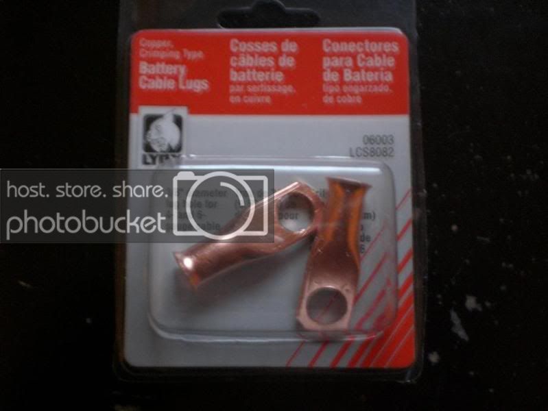

Alright, Im having a bit of a dilema here... my memphis 4 awg wiring kit came with a 200 amp inline fuse..Im going to be installing the big 3 with the left over 4awg...but i dont know what fuse to use for it? and also, a few guys from ROE were saying that the 200 amp fuse is way too much for my setup, and to down grade...so what 2 fuses should i down-grade to exactly? on another note, i went to autozone today to get ready to install everything...some new battery terminals..hope those were the ones i was supposed to get //content.invisioncic.com/y282845/emoticons/crap.gif.7f4dd41e3e9b23fbd170a1ee6f65cecc.gif and some more connectors for the grounds..
