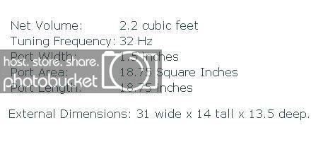

built my box.. bass doesnt sound right.. not round.. and in the trunk sounds weird. almost like an echo.. sharp sound. no air leaks.. what could it be? ive never had this problem before.
help please
set up memphis mcd-500 and m3
help please
your port is too small. the port area should be around 30-35
so should i keep the dimension just make the port area bigger? put all that work into it and its messed up..
sigh..
found the problem.. it was an air leak.. tightened one of the screws on the sub to the box.. and viola.. all fixed.
