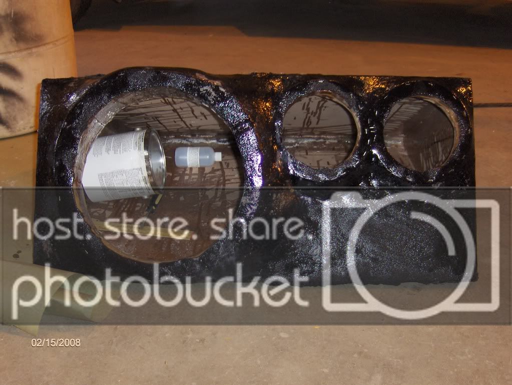

After looking back i feel a bit bad of how i said what i did. In a more constructive way i will say, you need more resin and wouldnt hurt to get some more mat on there either. Get some bondo on there after that and make sure u got plenty of sand paper. Starting to look better just please make sure u have enough electrical up grades for ur amps.
thanks guys for the comments i feel better now about this,, the box is small it's only 4 cubic feet after the sub an ports are in ,, but i had to stay under the window line,, for street b..the

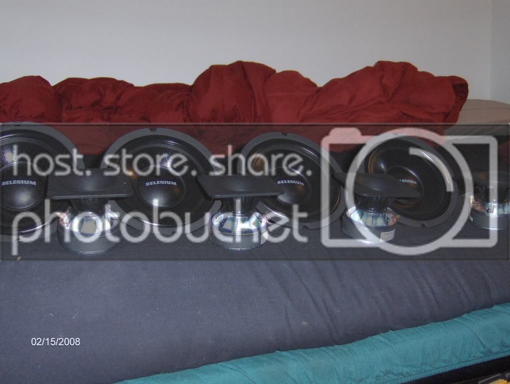

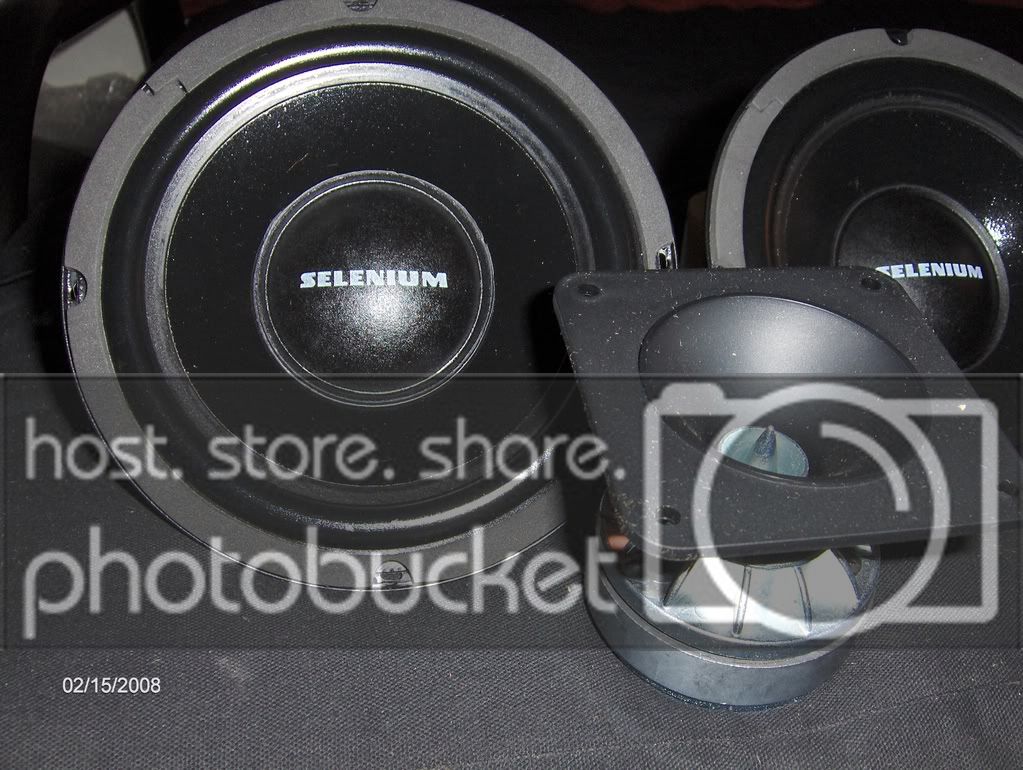

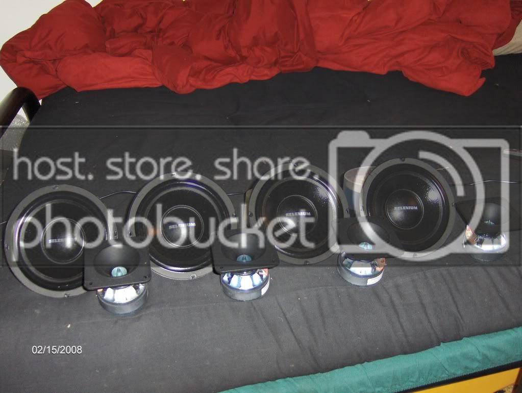

in 5 days im getting the rest of my mids an tweets, 8 to start off with.
alt' is being made right now should be dont in 3 weeks. box is at my job's body shop, so i can work in a spray booth it will be dont in 2 weeks,, ill keep you guys posted,, still to come fiber glass door panels, an 7" screen in the dash
i know you say people are dumping on you but i have gotta say that your fiberglassin skills need work. those rings are hidious. you need to get yourself a router and a jasper jig, or if your using a jig saw take your time and go slow, dont power threw it. and even tho you say the front peice will see no air movement from the box, i would have layed atleast 3 layers of glass on it for strength. the resin just on the fleece alone will end up cracking if hit good, i can take a thick piece of fleece soaked with resin and snap it easily and even with bondo it will be weak. nice as amps tho. but just take your time on the wood working and it will be that much nicer.
ok just giving a update , the picture below are or the box, with another layer or resin, an the holes cut out , also my 4 mids an 4 tweets, crossover's are coming in 3 days, i will bench test them in my room an make a video..( i have a head unit set up on a charger in case ppl were wondering,, in joy
learn to type A hole lol //content.invisioncic.com/y282845/emoticons/smile.gif.1ebc41e1811405b213edfc4622c41e27.gif looks good bro, cant wait to start puttin these in the accent.. its gonna get loud especially with those tweets ... hurts just lookin at um

I would have went a different route with that enclosure though, looks a bit odd to me. Its all trial and error though.....
