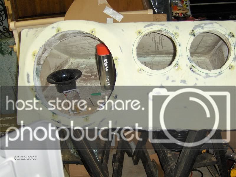

yes the box is a little small its 4 cubic feet, if i made a square box the amps would be above the window line. keep in mind i have to obay db drag street b rules. sub is going basket in the box. ports are gonna go internal. an there will be a second baffel on the slant.. 53" by 26" to support the 2 amps.. i thinks i got every ones question

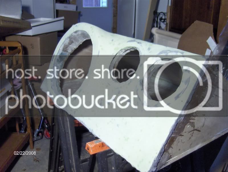

this is some progress i got done this past week an weekend..

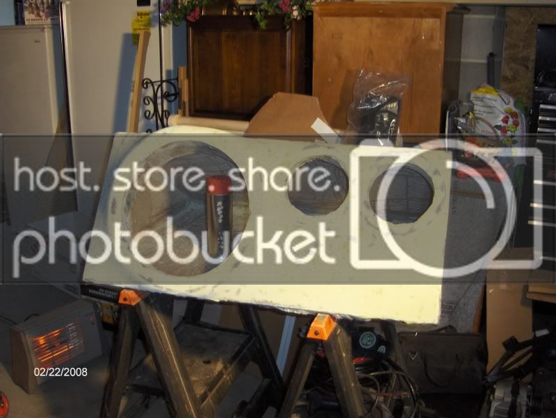

my box all bondo up.. an sanded

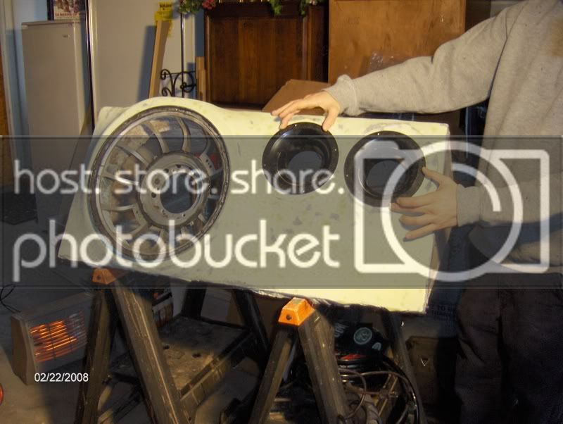

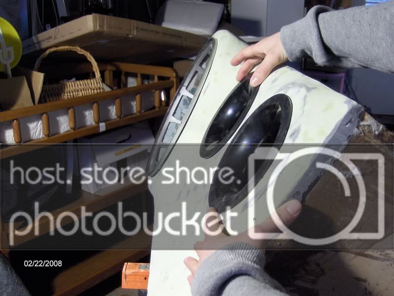

test fit of ports an basket
another view

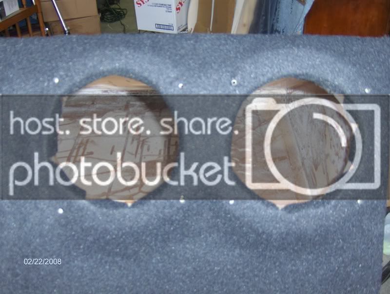

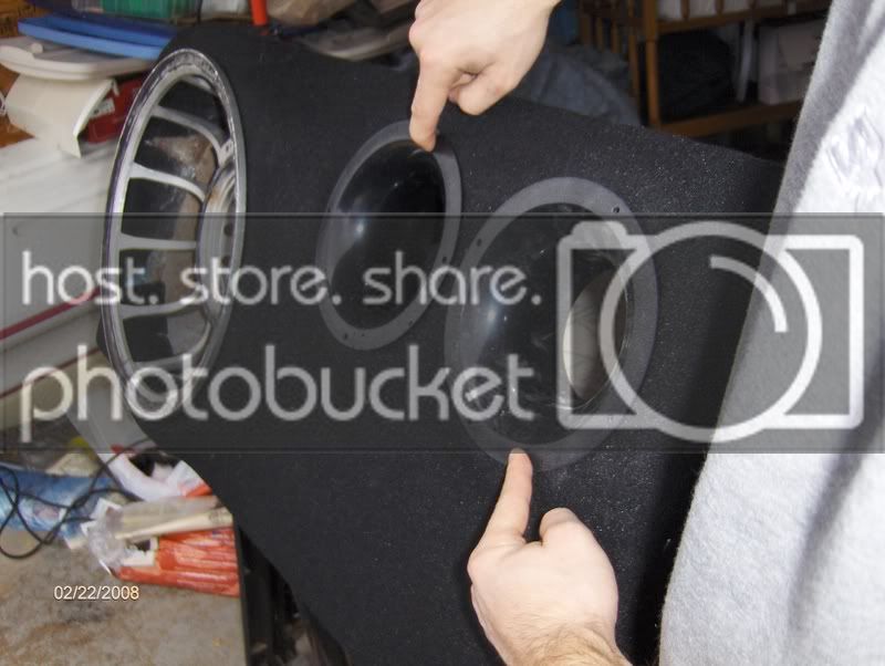

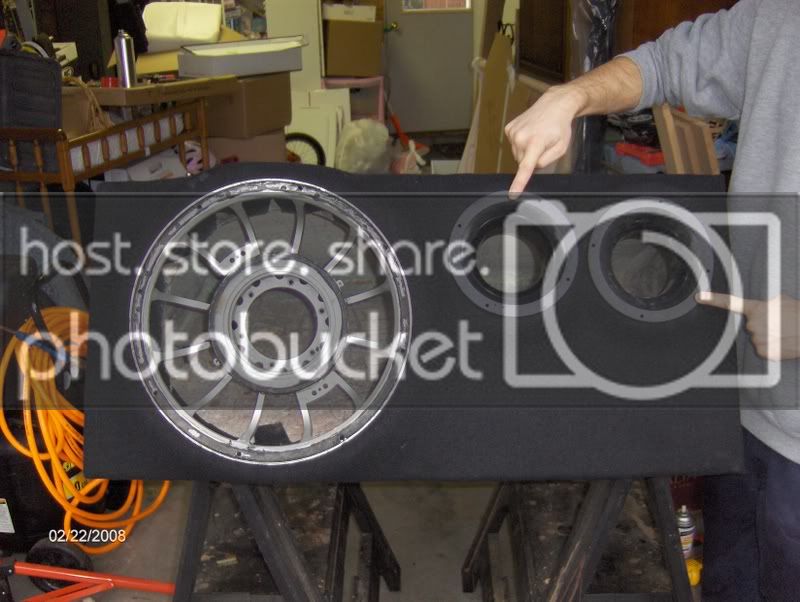

i got threaded inserts from my job, that take 10/25 machine screws,, this is so i can change my ports an sub with out distroying the box. by the way they came out great

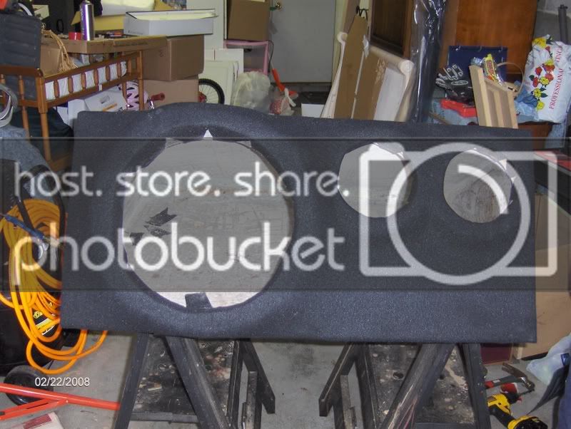

decided to carpet it instead
