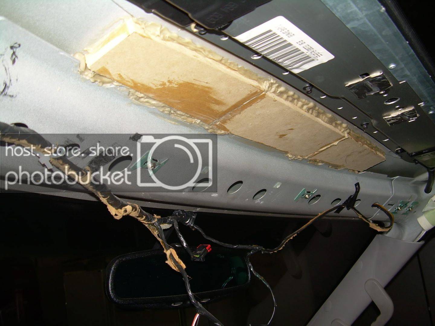

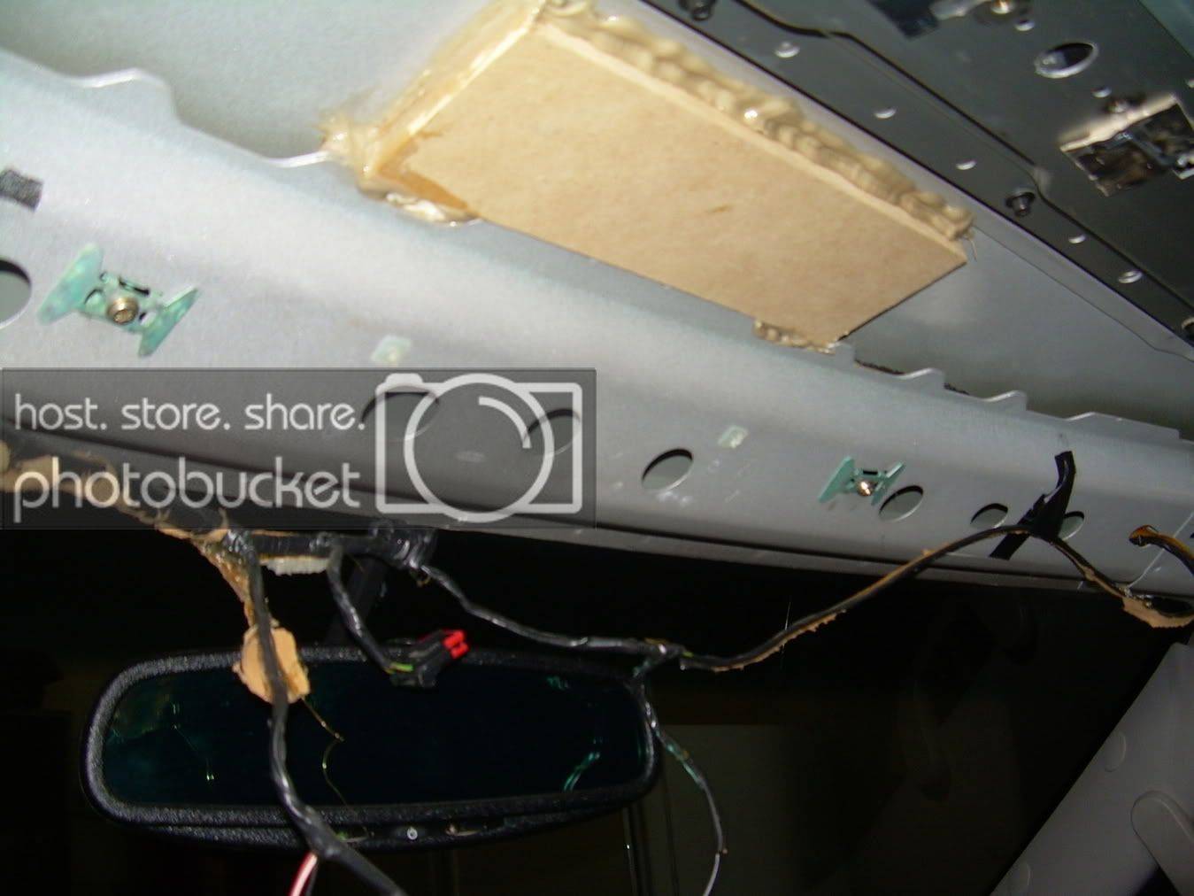

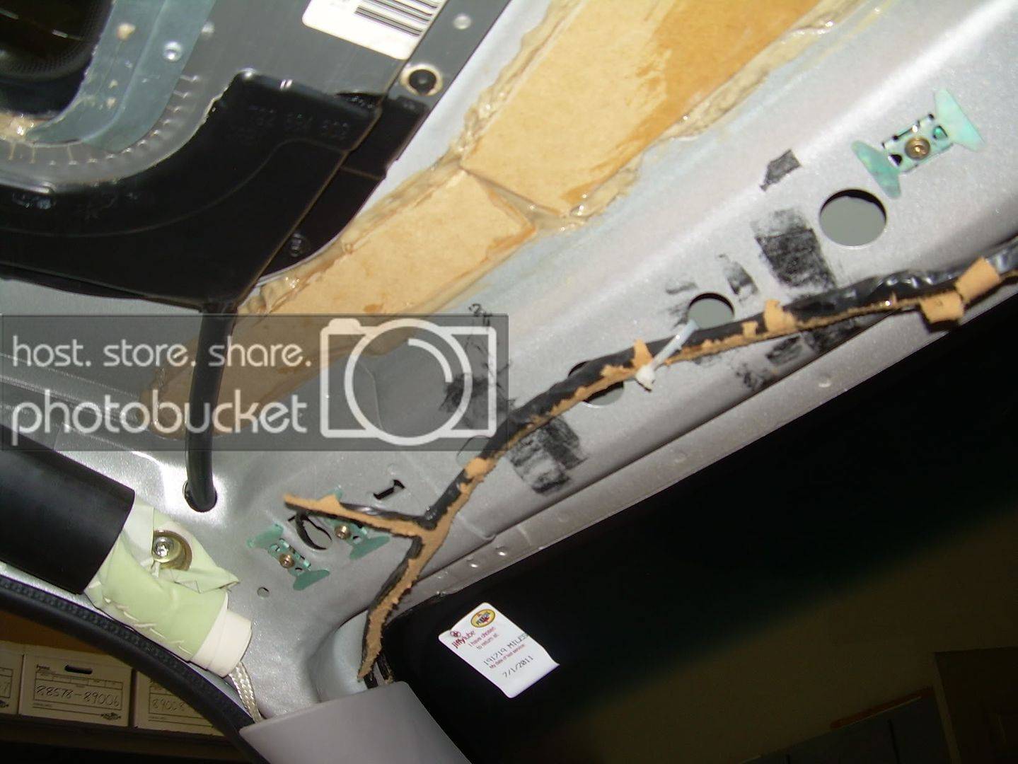

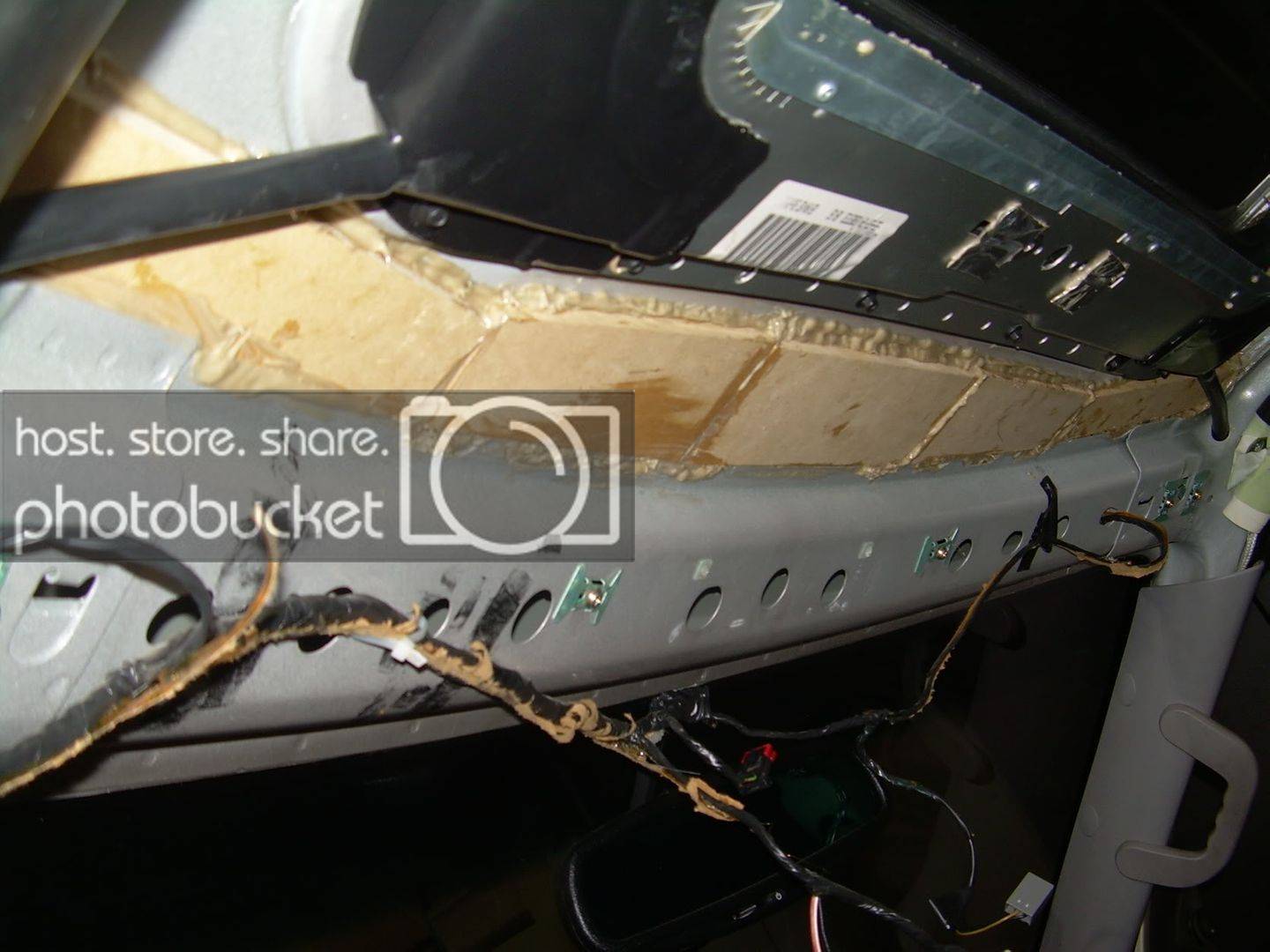

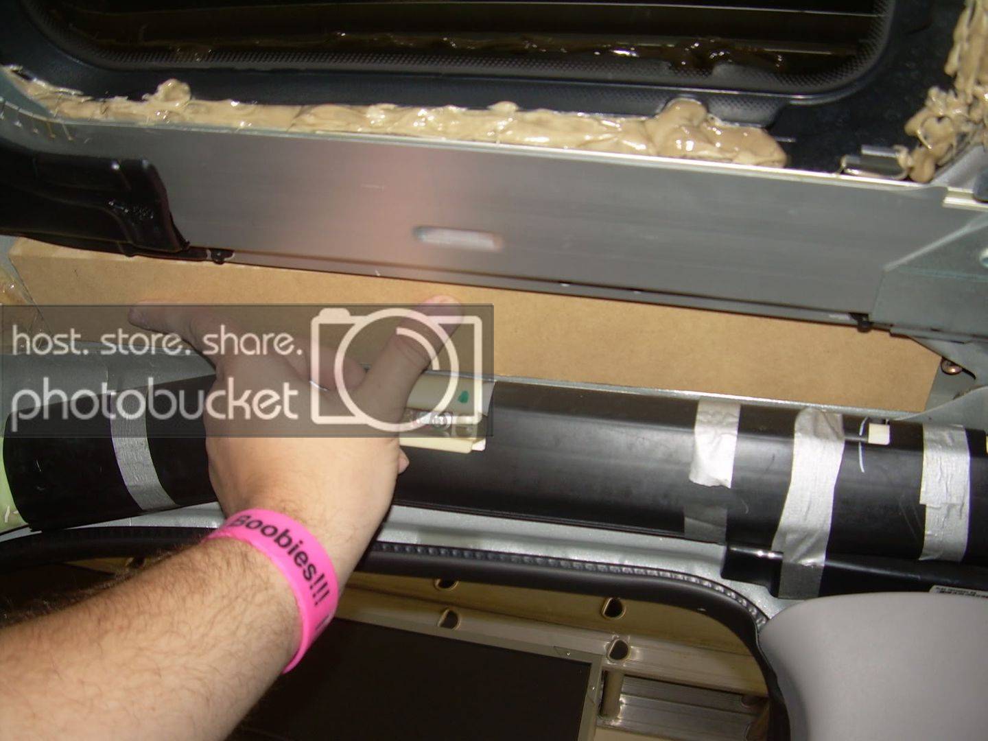

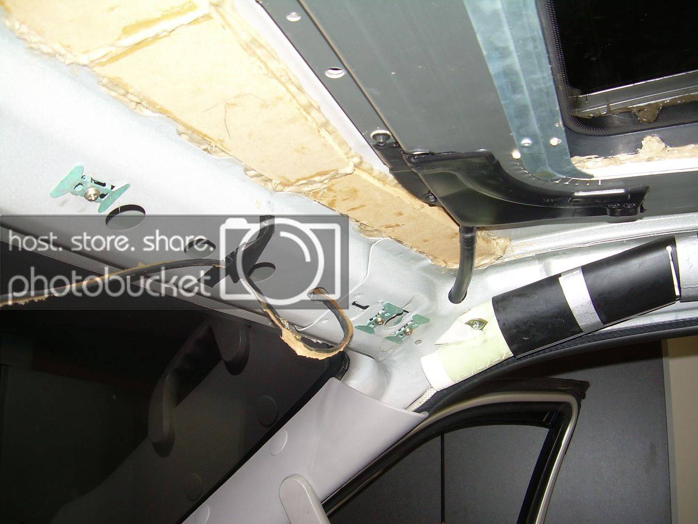

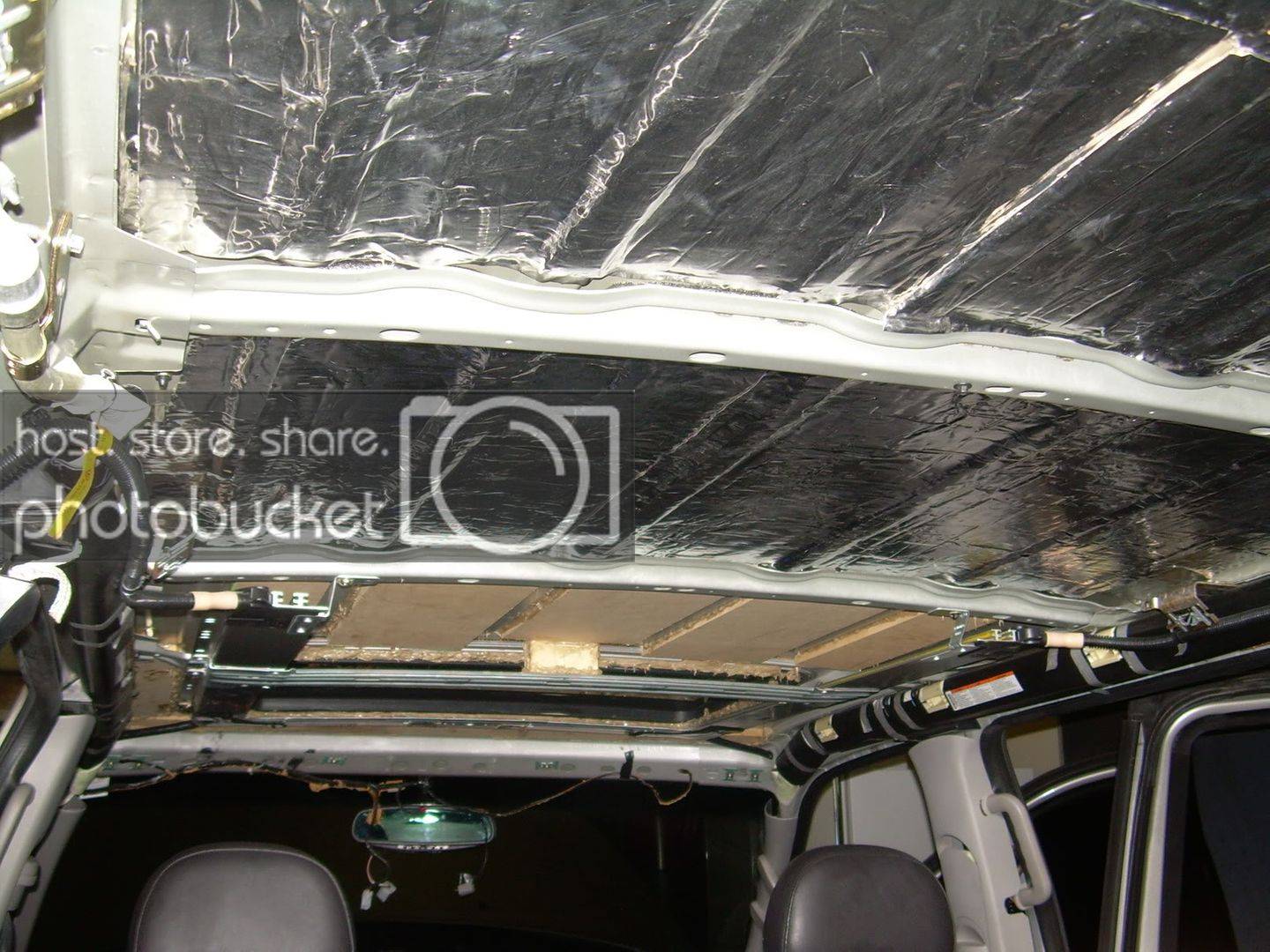

This is what I've done today so far.
//content.invisioncic.com/y282845/emoticons/boobiez.gif.bcca53c4e1c9539300cad4d7d1b9dd4d.gif:boobiez://content.invisioncic.com/y282845/emoticons/boobiez.gif.bcca53c4e1c9539300cad4d7d1b9dd4d.gif:boobiez://content.invisioncic.com/y282845/emoticons/boobiez.gif.bcca53c4e1c9539300cad4d7d1b9dd4d.gif
Ok, as you see it here, there are 4 sections. The 2 sections closest have 25 square feet of Audio Technix deadner. The closest one has 2 layers, the furthest has 3 layers. I did that because I don't want to pull the headliner off again, so I did it right. No questions about it now.

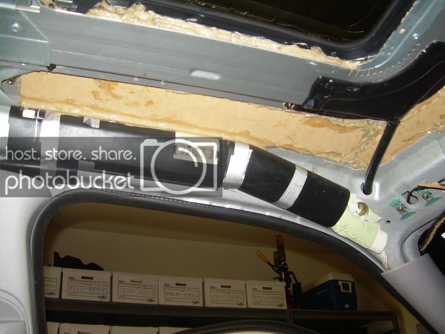

The 3rd section away, has 5 'runs' of .5 MDF between each of the cross braces. There is still more bracing to be added to that.
The first section, where the sunroof is, there is MDF all the way around the sunroof (almost done) and the sunroof is sealed shut. Not sure if I will add anything else to that part yet.

The AT deadner is 80 mil.
