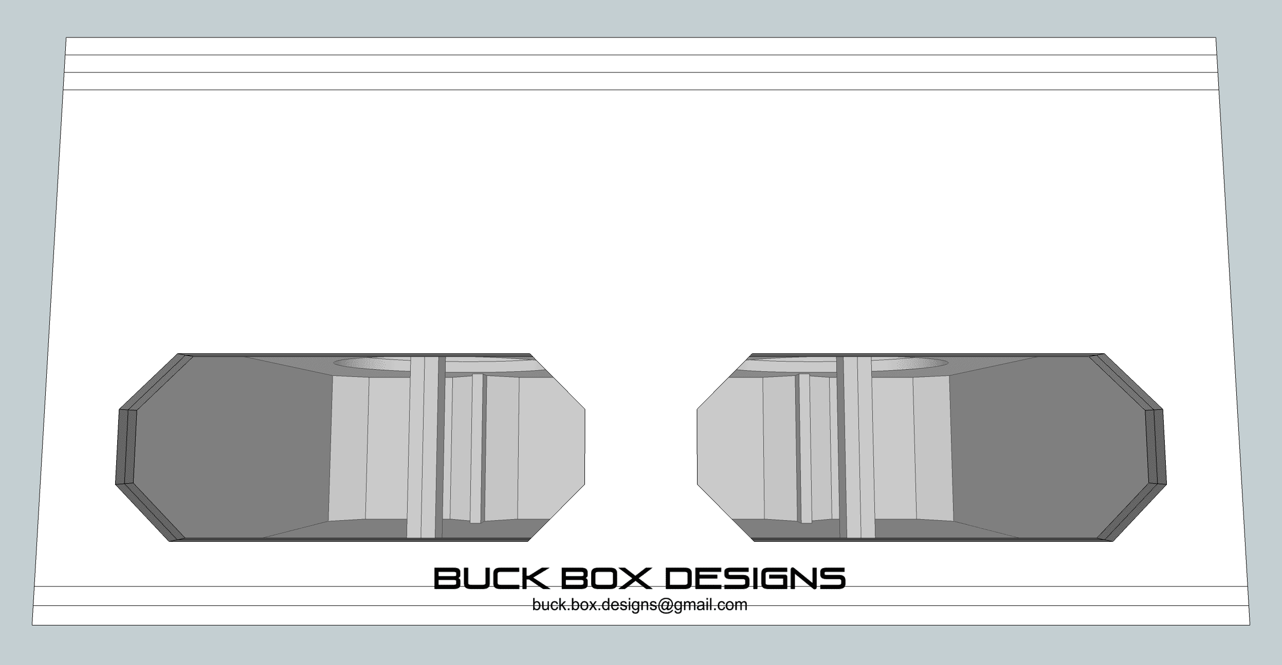

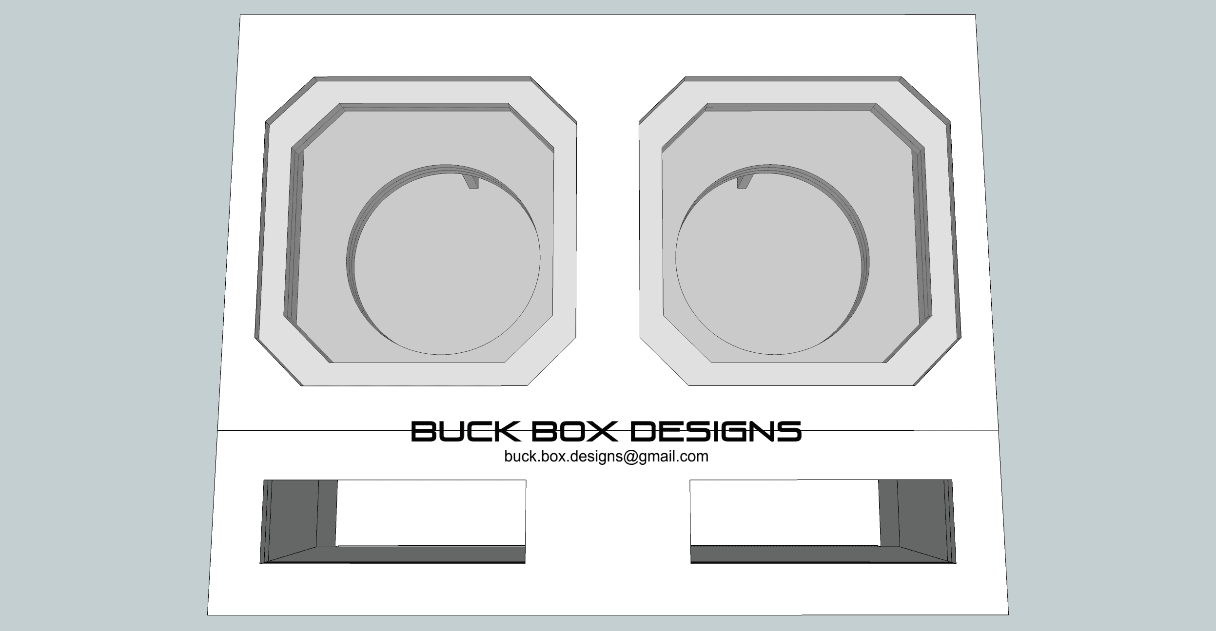

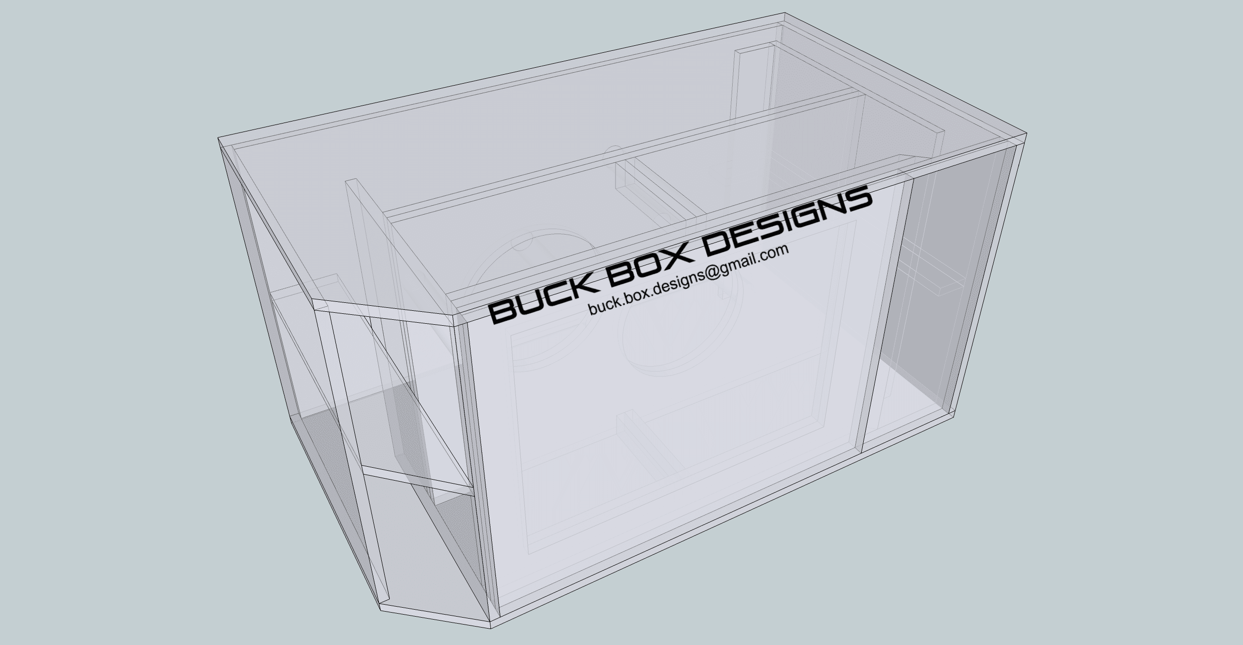

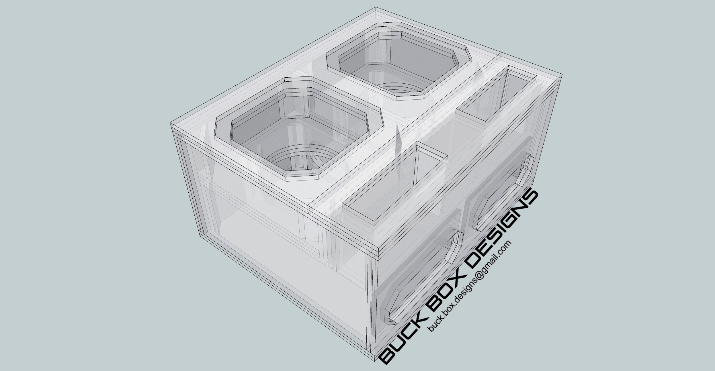

I went a little Buckwild on this one. Sometimes a Buck just has to go wild, you know? I really like these subs. Really really like these subs, from how I see the t/s parameters.
Subs: 2 Adire Audio KH3001 15's (3000w RMS per)
Box: 4th Order Bandpass with fully removable port and multiple windows. It's designed for daily heavy bass, going in the back of the cargo area of a large American SUV.

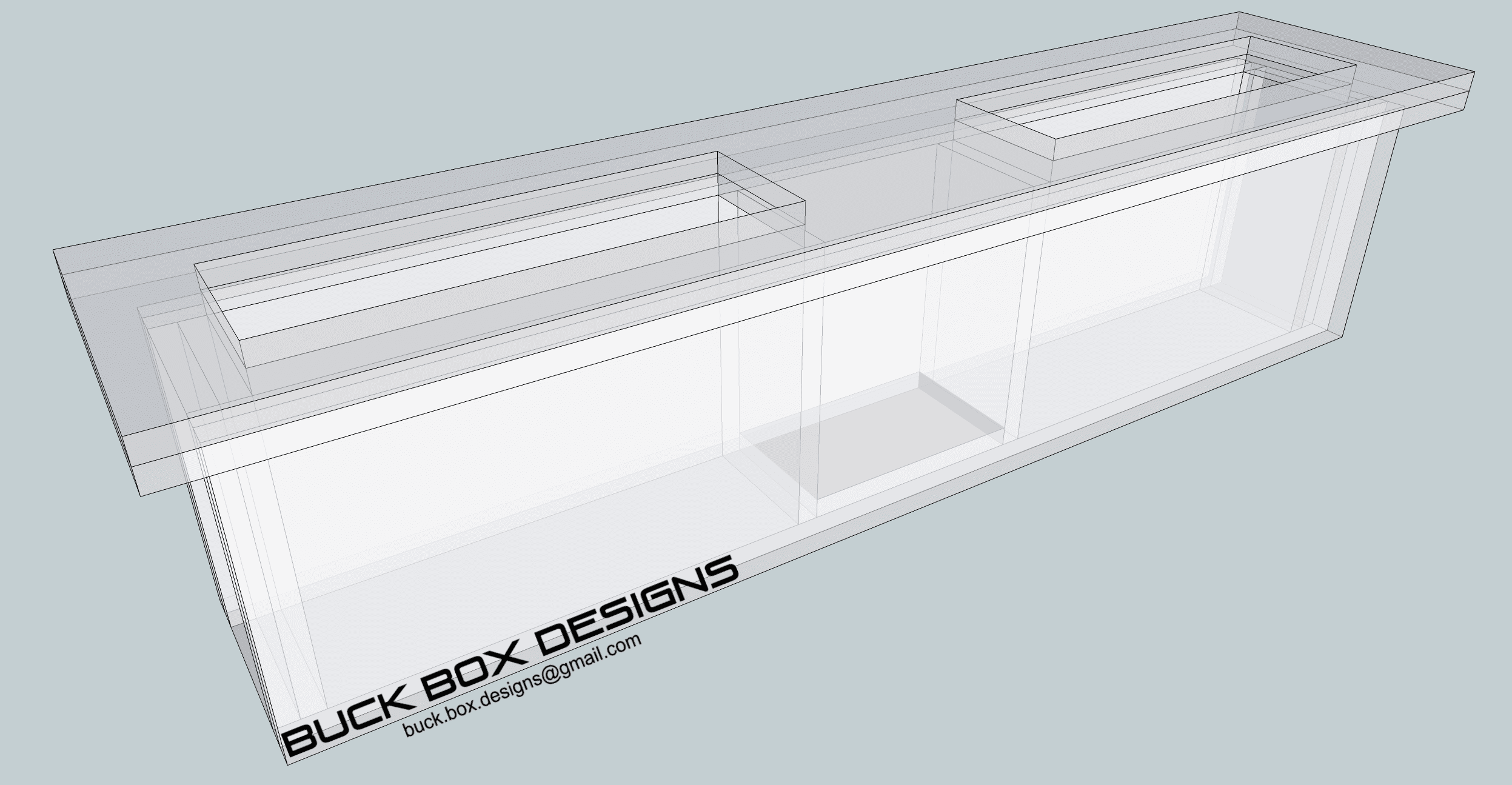

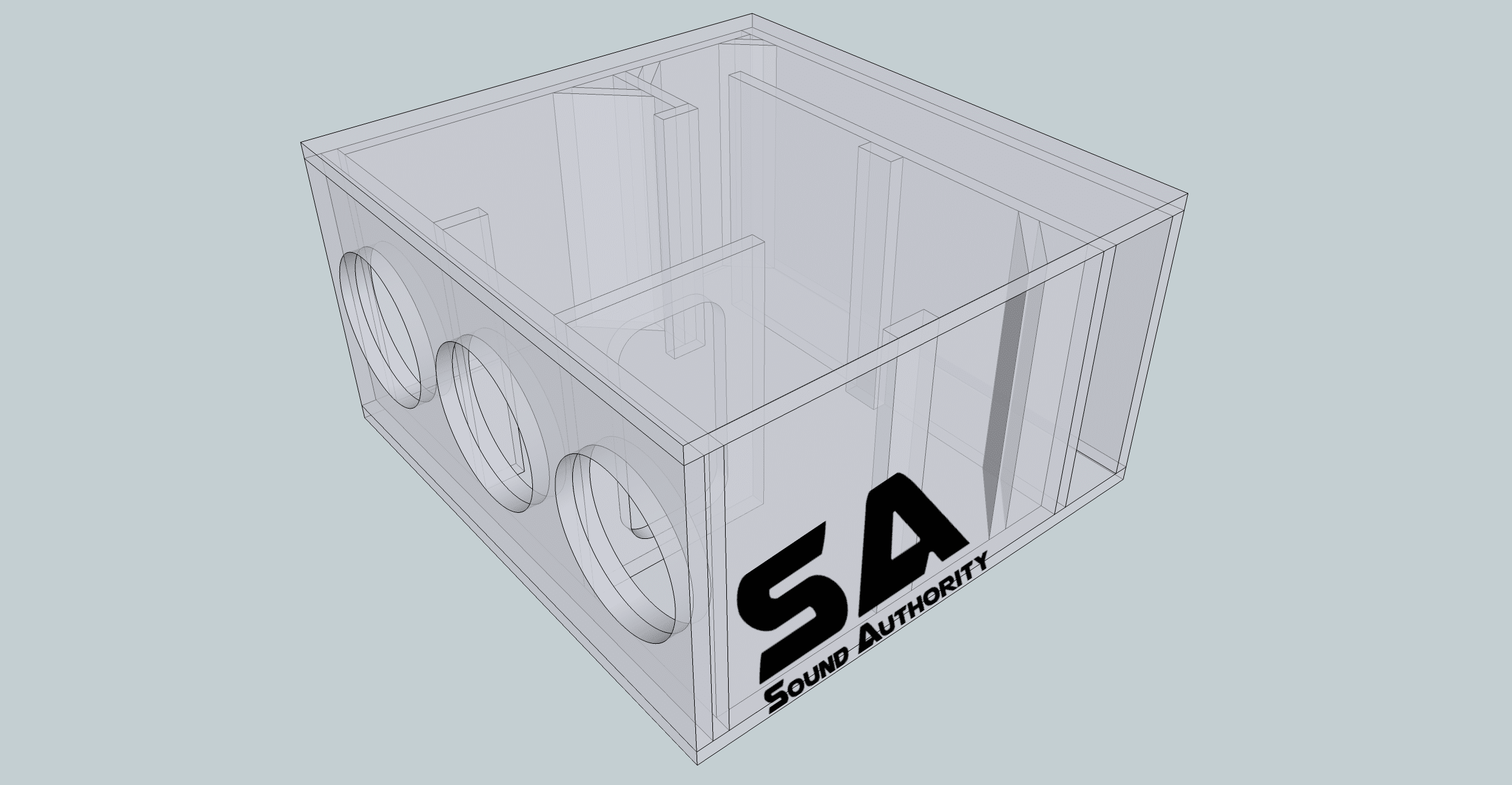

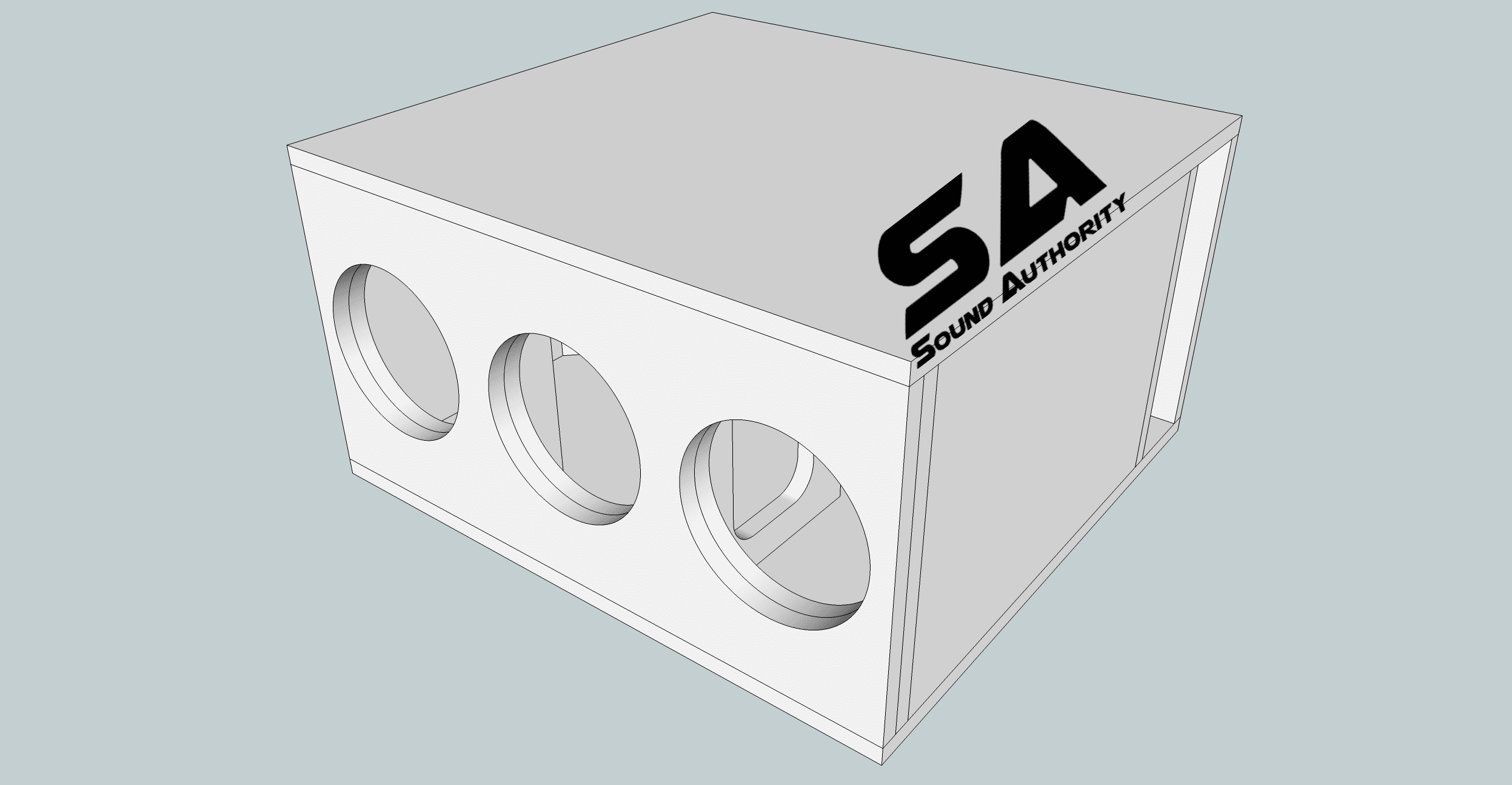

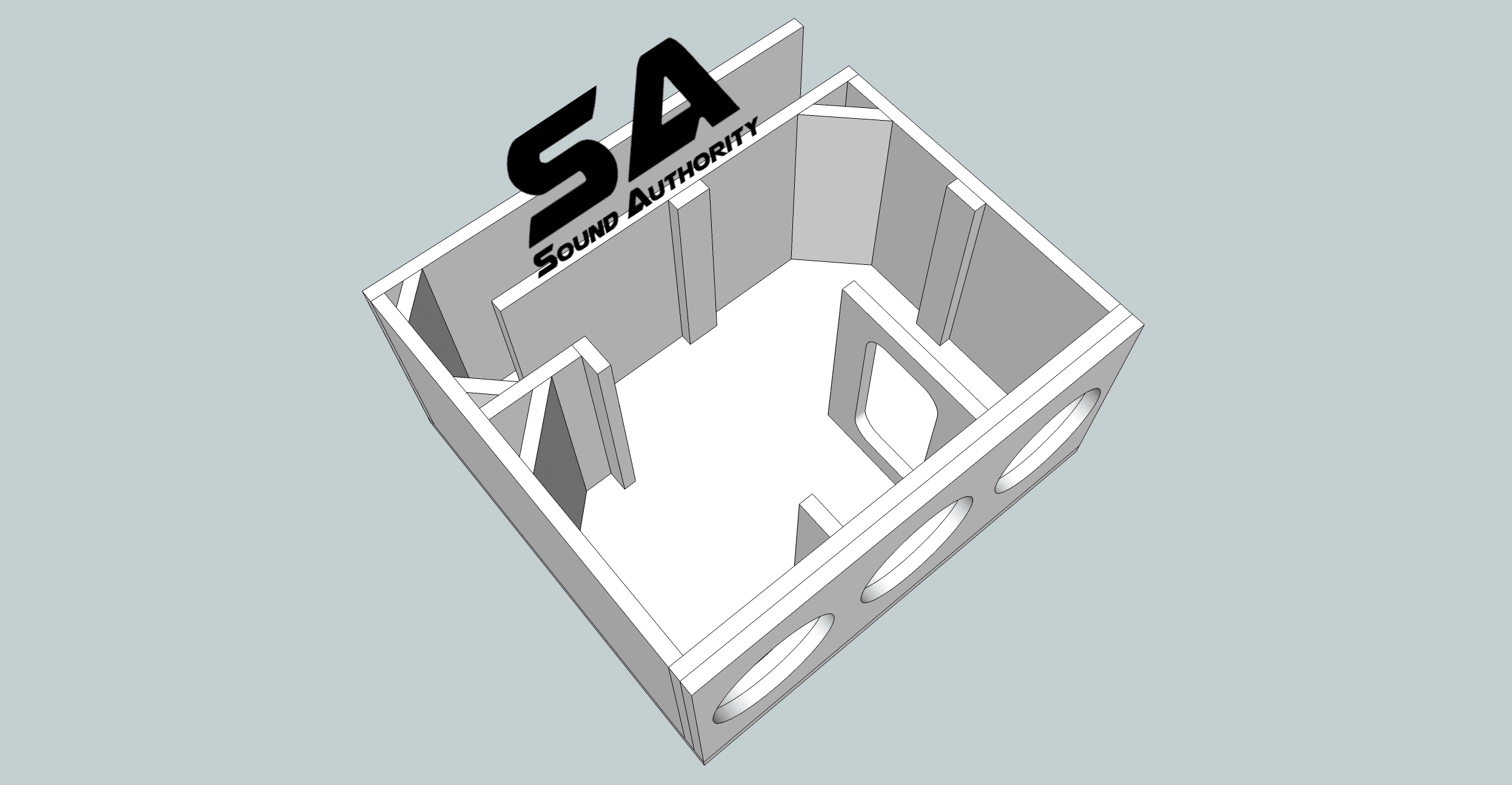

3 B2 Audio Rampage 8's Ported, in a coupe trunk. These 8's may be the best 8's I've seen from a high powered t/s parameter looking. These 8's have a 300 oz motor, 1000w rms, 20mm of xmax....holy cow!!! These are some monsters!!! I'd love to do a monster series 6th order for these.

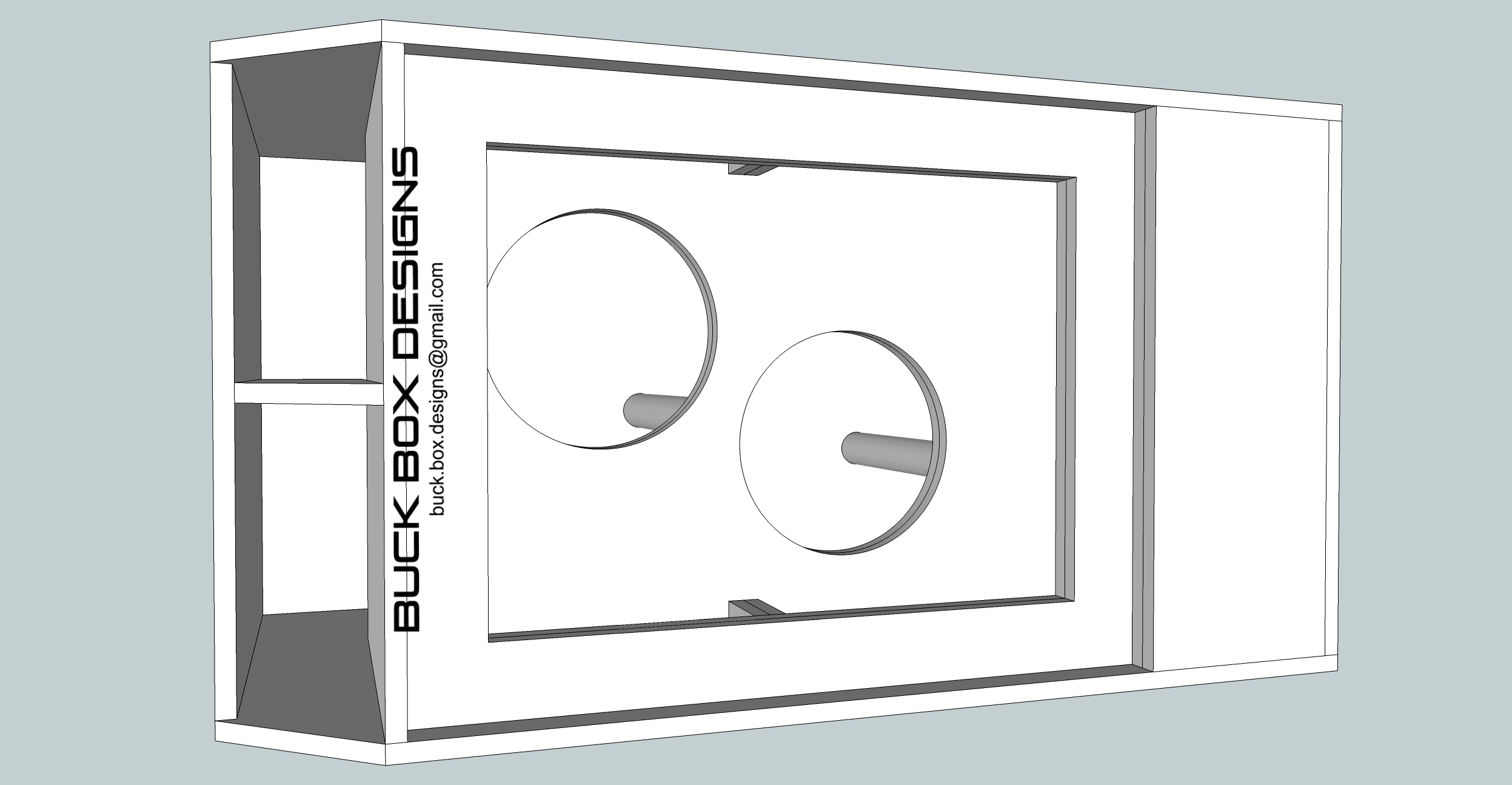

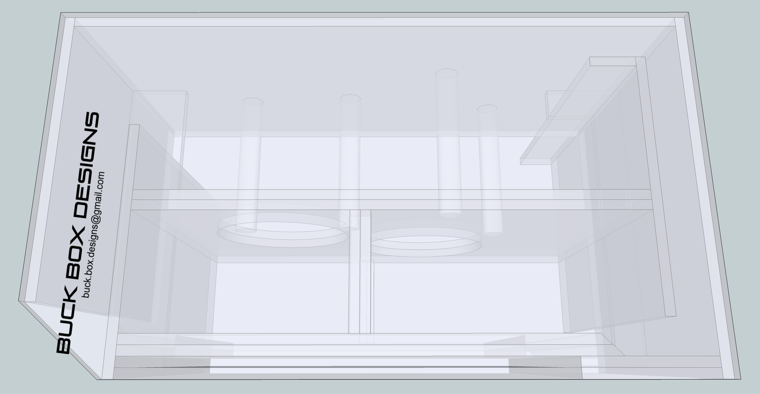

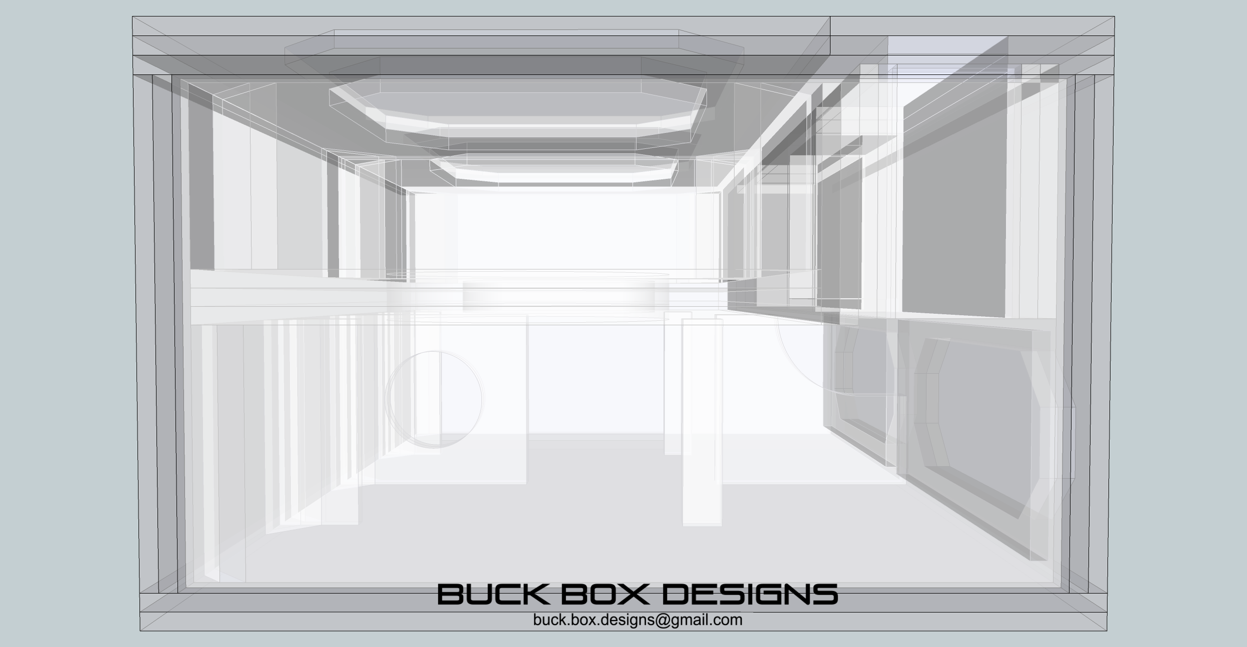

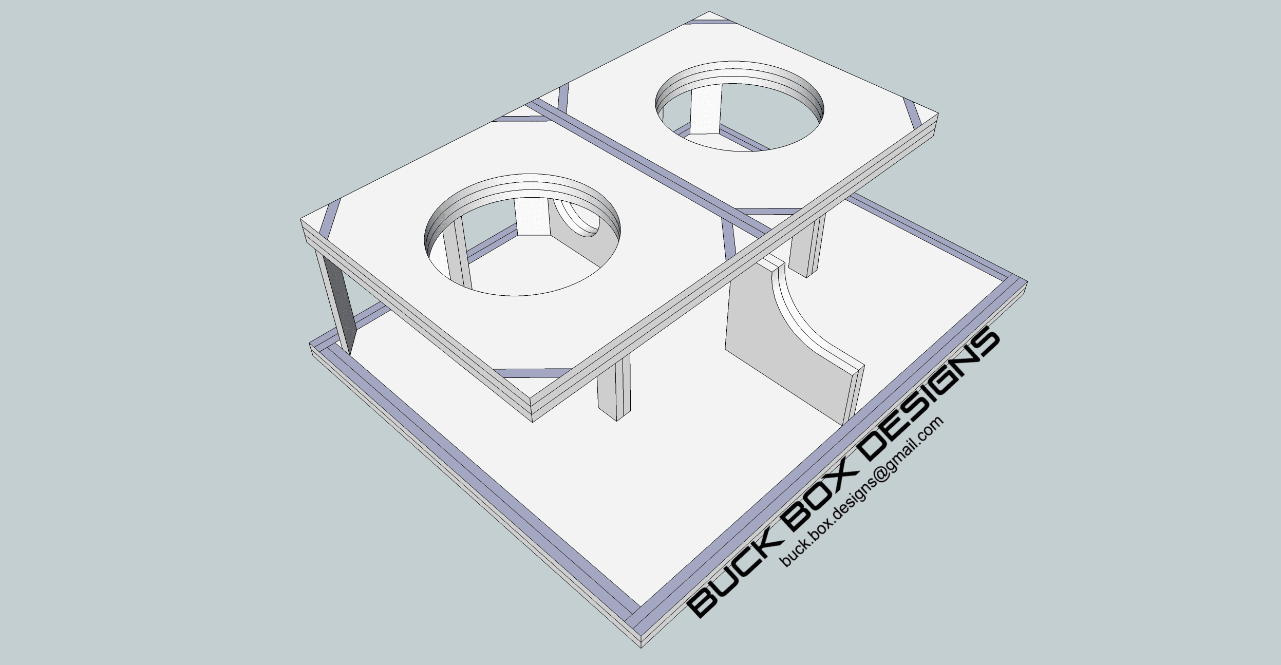

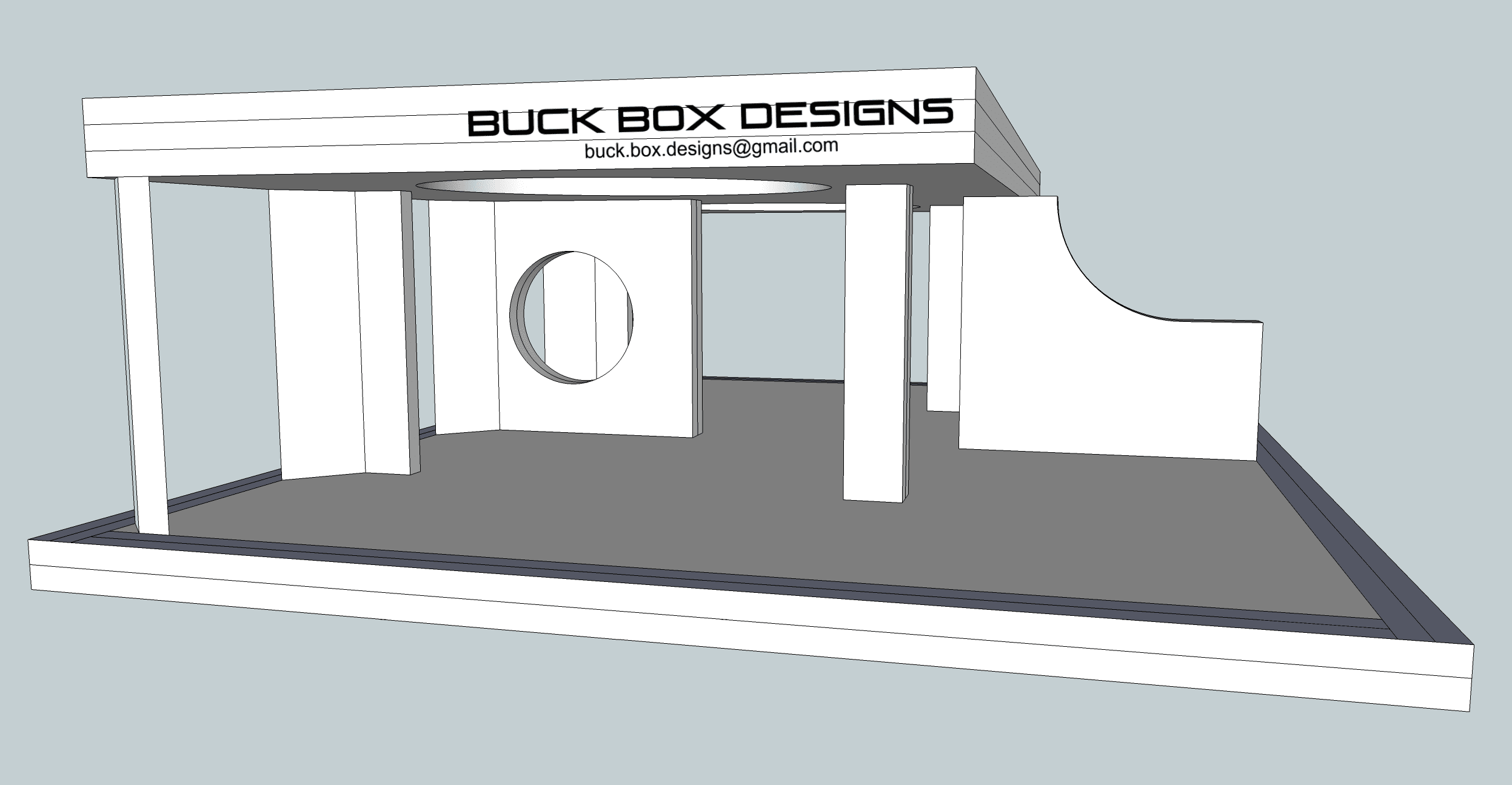

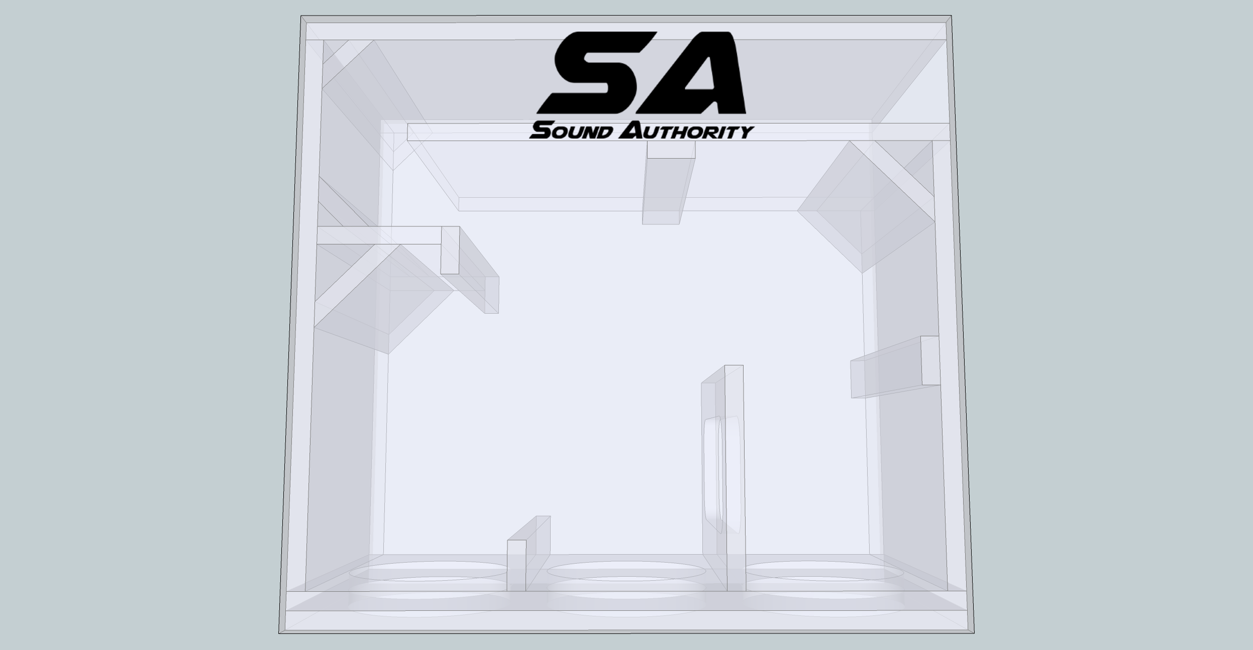

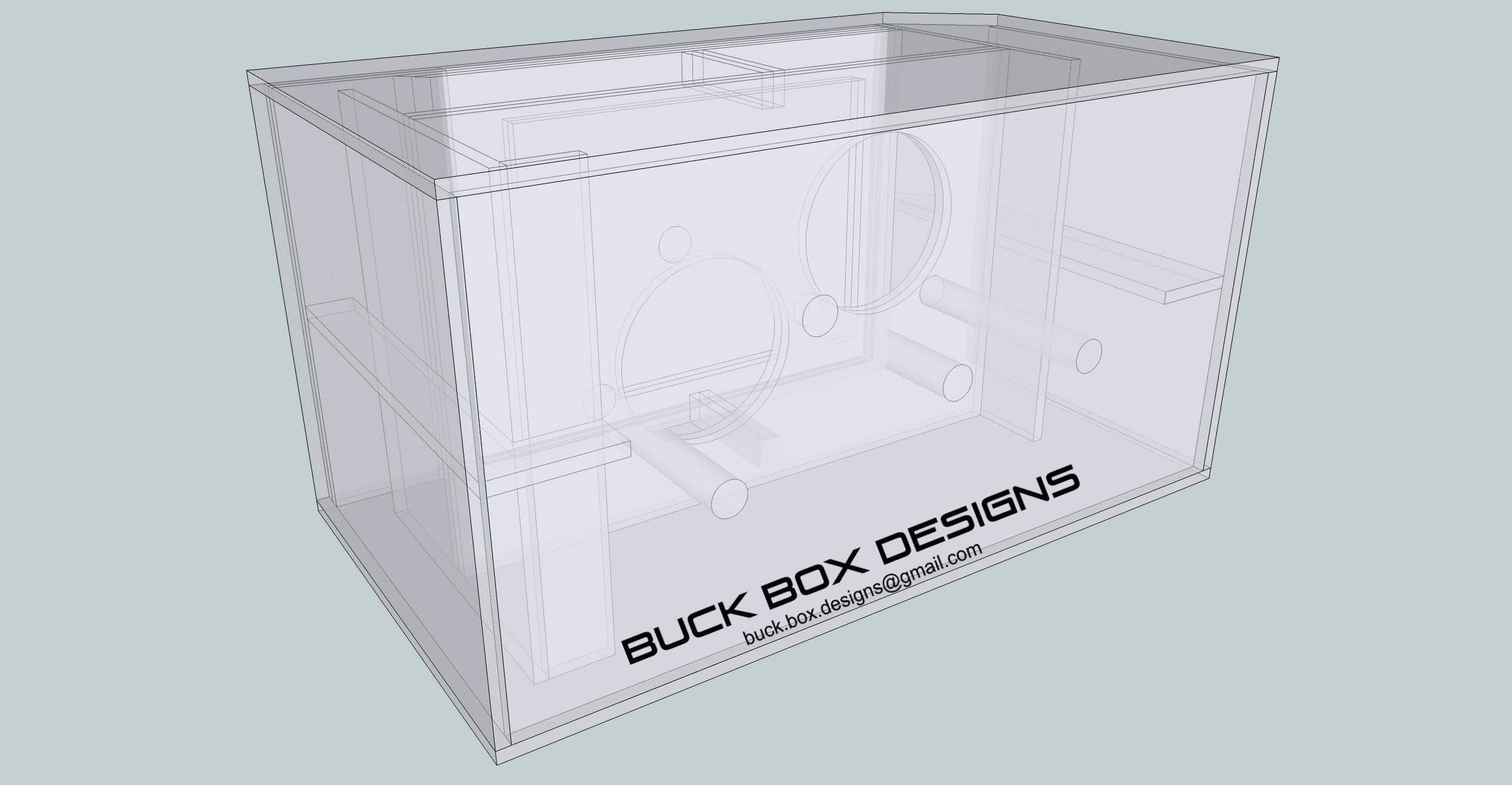

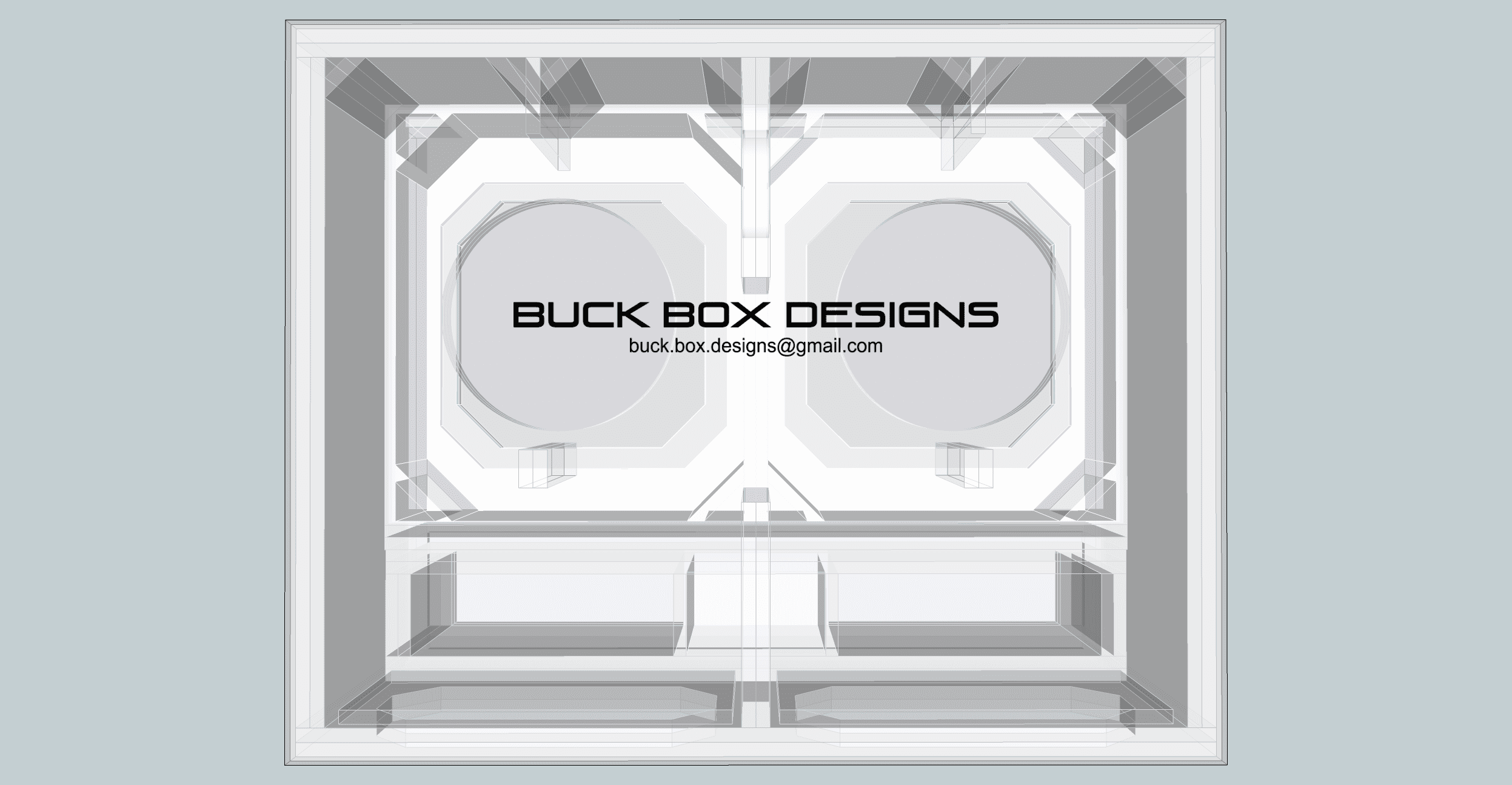

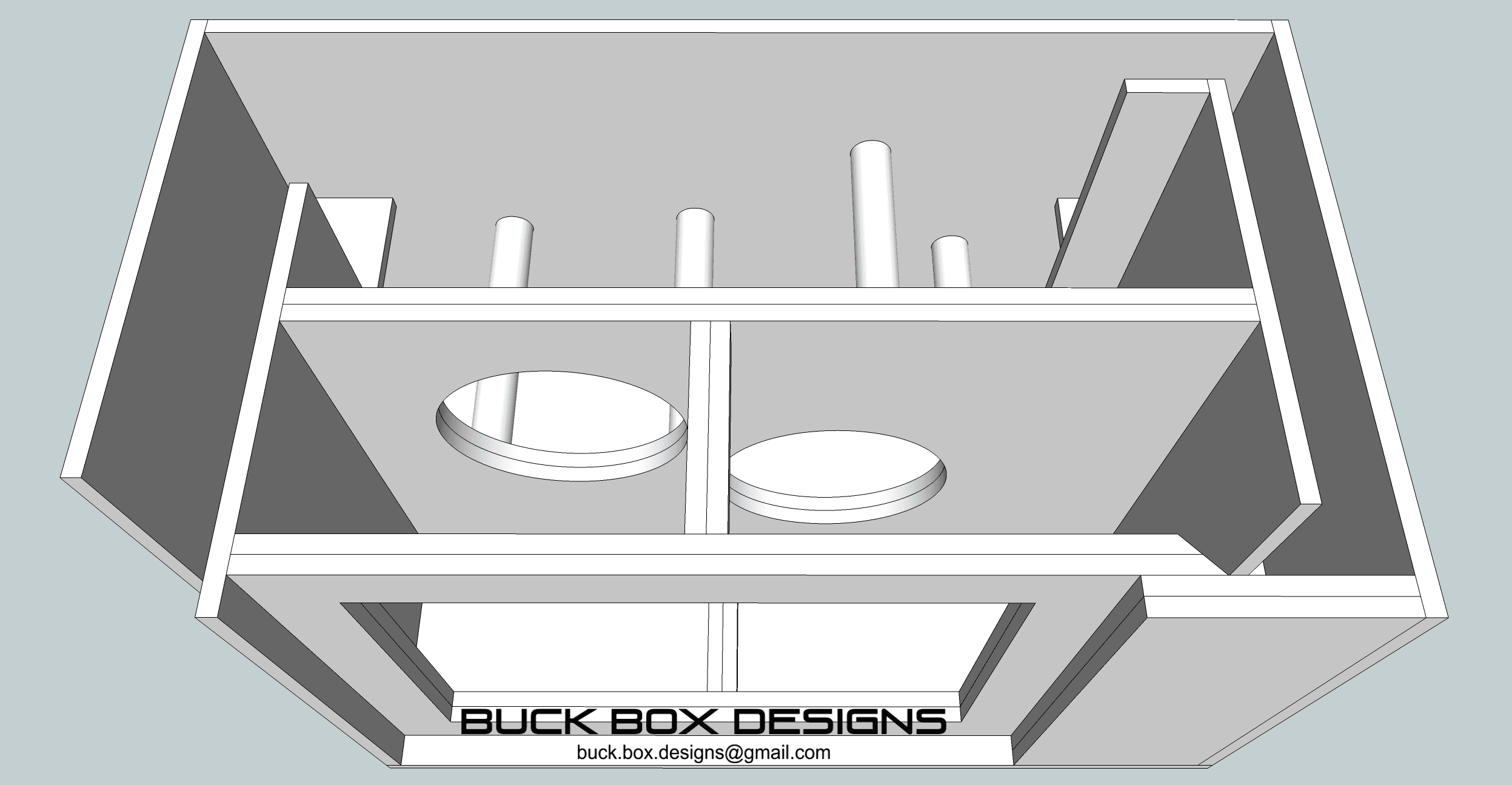

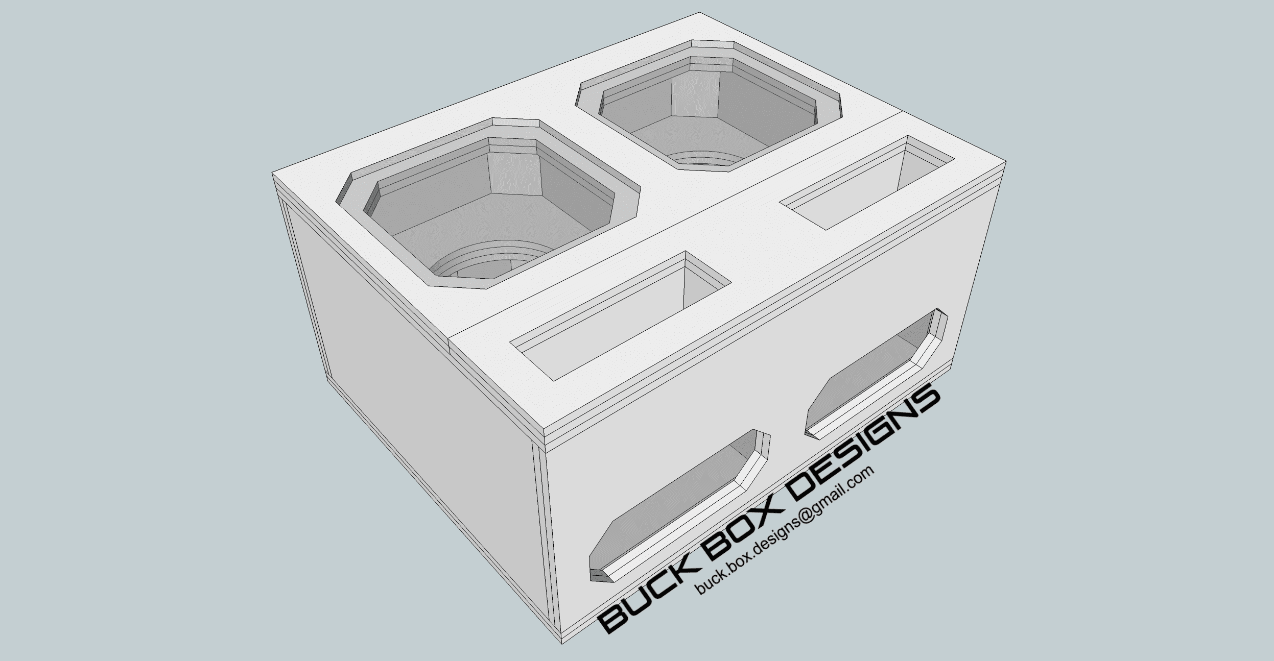

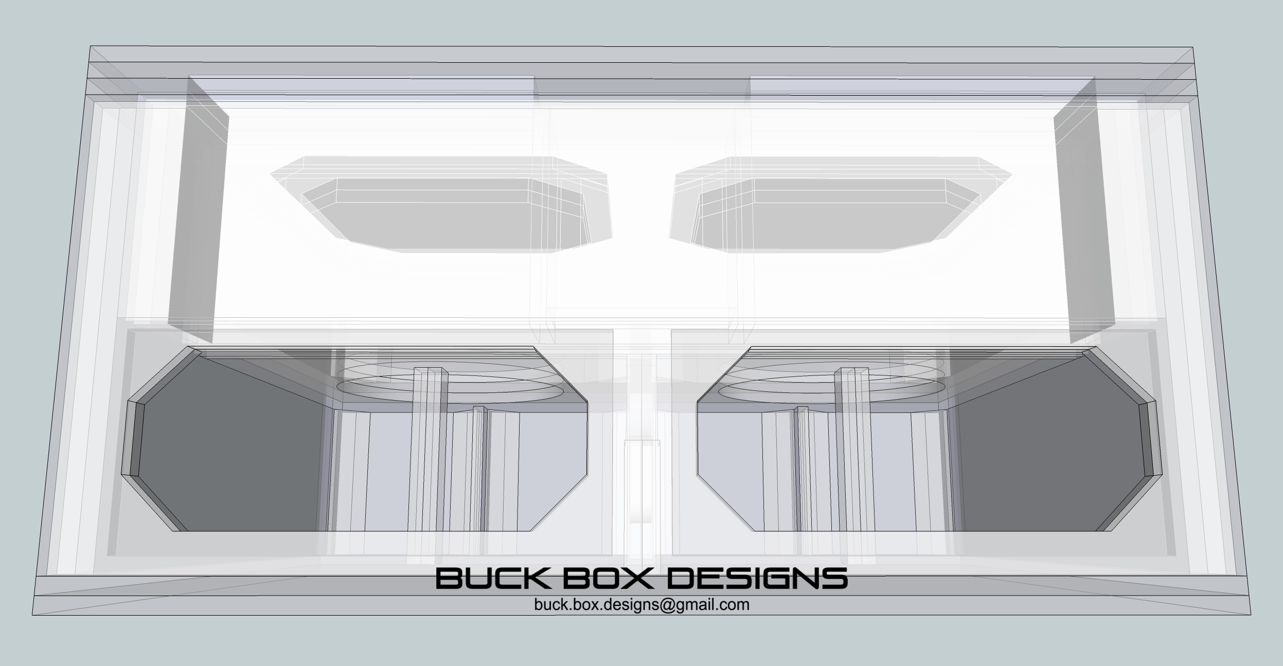

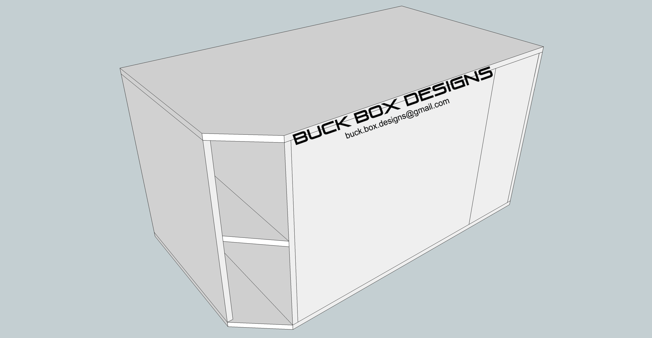

I was told somebody wanted to hit some lows, with pair of Sundown X-12's in a big American SUV. So, I said, hey, we should do a series 6th order, since you have the space, and you really want to do some wind-tunnel like stuff. This box is tuned just about as low as I ever tune boxes; it should get pretty wild. Front-center wall portion is removable for sub access.
Here's the series 6th order- power should be 4-5kw total, from what I understand. Enclosure can fire any direction; it's designed to fire backwards, but it could easily be fired up as well:

This is designed to slam the 25-35 hz region, or so. It should play down below 20 hz, maybe up to 50-60. We'll have to see how it does on different power levels. The box, in total, makes this act somewhat like a larger system. Sometimes there's some fine tuning with enclosure positioning, increasing power levels, etc, that can really boost systems like this over time. This box is designed somewhat to support higher-than-RMS power levels. So, we'll see how it goes. The X-12's already seem underrated. I really hope I get a video of this one.
Aren't the X's more of a SQ sub? Wouldn't the ZV5's or ZV6's be a better sub for that box?
I would not call the X's an SQ sub. The X, Z, and NS, they are all a similar design style in how they're meant to play, IMO. They are all long throw and have big fatty high role surrounds. The X's are just the lowest power handling of the bunch. Any of the Sundown subs I just mentioned will work in that box, at least airspace wise. The Z is just a higher powered X; you can easily make that comparison. They act very similarly, just the Z is heavier duty, with the NS being a total monster.
