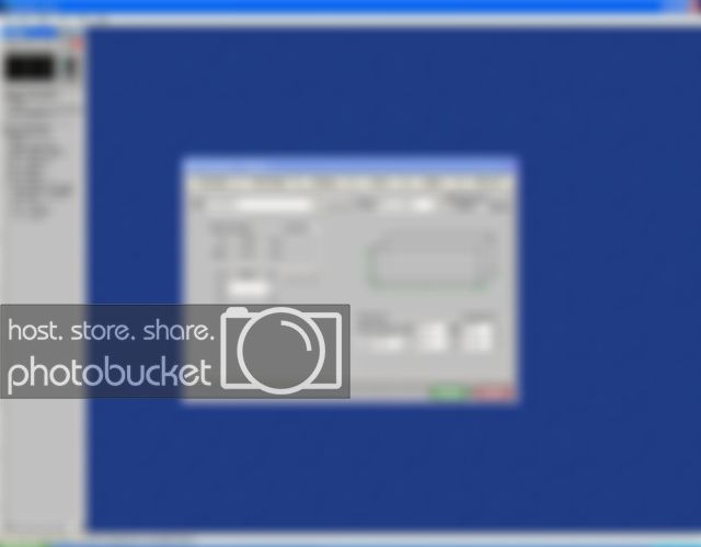

**** im ****n up today! //content.invisioncic.com/y282845/emoticons/laugh.gif.48439b2acf2cfca21620f01e7f77d1e4.gif ok so if you raise the box height to 16.75 that would be nice!
check out the screen shot
edit:
sry its tiny! so basically with the same size port just the box 1" taller you achieve 3.354 ft^3 before sub displacement and a 36.9hz tuning.
the port would be 33.5 long like your original.
