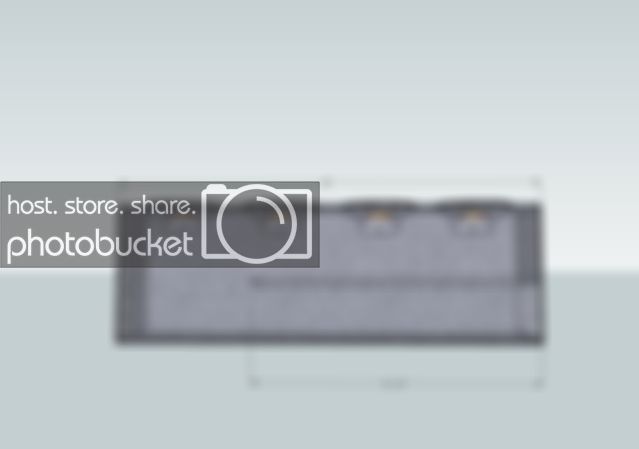

Box for (4) 1508's
I have a box built on sketchup, but my stupid school blocks all file hosting sights.
Can i email it to someone to host? I need you guys to check my tuning.

heres pics for him guys
gross volume : 4.41ft^3
- port volume: 1.41ft^3
-sub displacement: .3ft^3
2.7ft^3
With a 11.25" x 6" port, you have a tuning right around 40hz, according to the carstereo.com calc.
