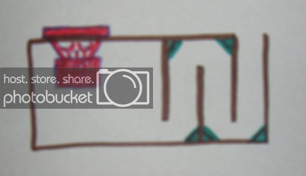

what about doing a port like this ?
dont make too much fun of my drawing - took me like 27.625 seconds to draw up
here at the computer.. haha - just here for refrence guys.....
^Yea, you can snake the port and make it as long as you want (so far as the external dimensions dont get bigger than the space you plan to put it in //content.invisioncic.com/y282845/emoticons/crap.gif.7f4dd41e3e9b23fbd170a1ee6f65cecc.gif)
