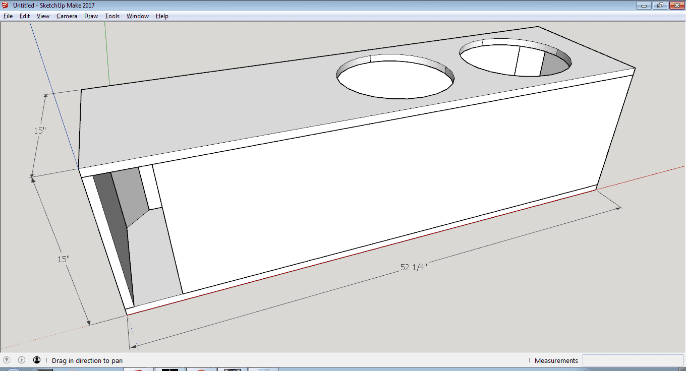

Ok finally had a chance to go get a sheet of mdf and talked to a couple of people with the XRs and I did some more thinking and measuring and the box would be better for me if it was about 15" deep 15" tall and how ever long for 2.25-2.50cf at 33-35hz.

This is 4ft3 net tuned to 33hz... would you like to see more?
Well, lemme know when you get the second sub then... I got that one all ready. As for a single sub, try Torres box calculator or Explicit Audio Ultimate Car Audio app, and look for 2ft3 net, around 28in2 ported to 33hz. I'm sure you can figure out the program pretty easily... good luck!
