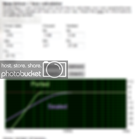

Im new at this, but based on the EBP of 86.5 they would prefer a ported enclosure. Of course this graph doesnt take into effect car acoustics.
