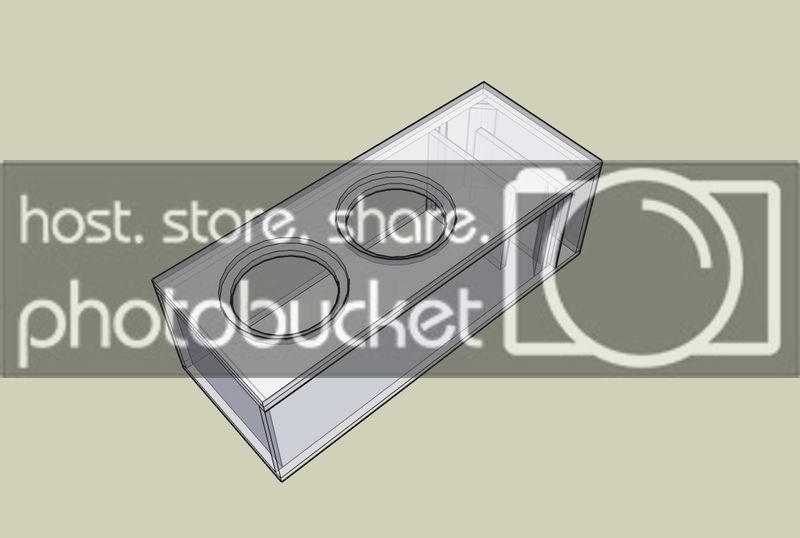

I got a design from a guy already, but wanted to see if anyone got a better design..
It is going to be in my 1995 ford explorer..
I would like it to be 2.5 cubes tuned at 32 hz (ported)
Max dimensions:
Length: 40 1/2 inches
Height: 18 inches
Depth: wont matter (shouldnt be too long because it is a pretty small box)
I would like the subs to be on the top, and the port on the side facing towards the hatch..
Any help would be very much appreciated, Thanks in Advance

Here is what mobeious came up for me..
so any input?
I really like his design, but wanted to make sure that I got the one that I like the best

dont know if u seen that but thats why the port in the middle wont work
