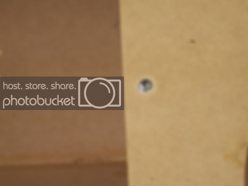

Yeah from BJ's link...this is what you want to do:
i put mine about 1/2 way through the double baffle. the only 1/4-20 bolts i could find with an allen head (those thieving bastards run around with power drills with phillips head bits, might as well go with the allens) only had threads on about 2/3 of the bolt so mounting it flush with the outside of the box wouldn't work. don't see why it would make much difference either way.
and actually, the mounting holes in my sub were just a hair to small to put a 1/4-20 bolt through. a 1/4 inch drill bit solved that in no time flat //content.invisioncic.com/y282845/emoticons/biggrin.gif.d71a5d36fcbab170f2364c9f2e3946cb.gif
