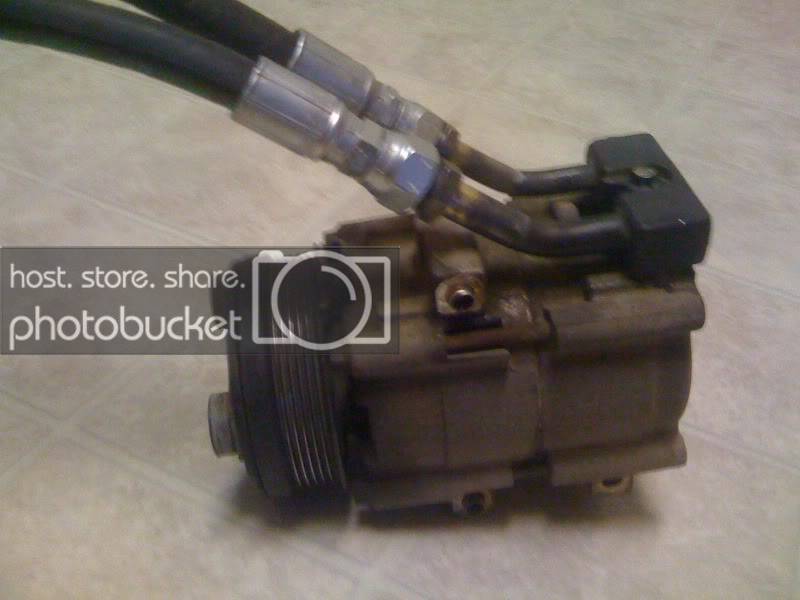

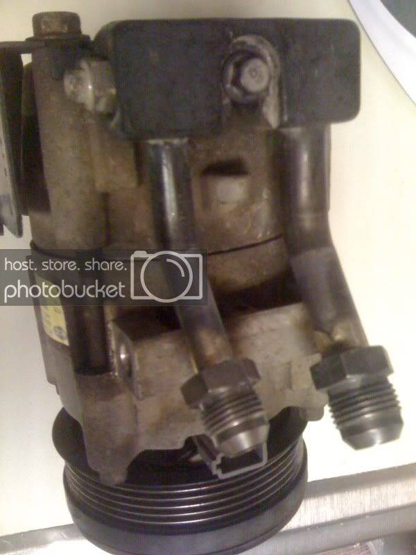

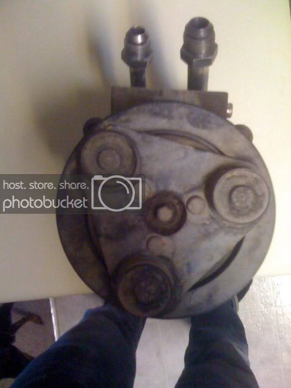

Im now converting my stock ac compressor to an air compressor heres some pics

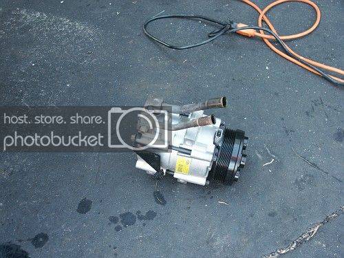

The stock Ac comp (not mine this one is way too clean)

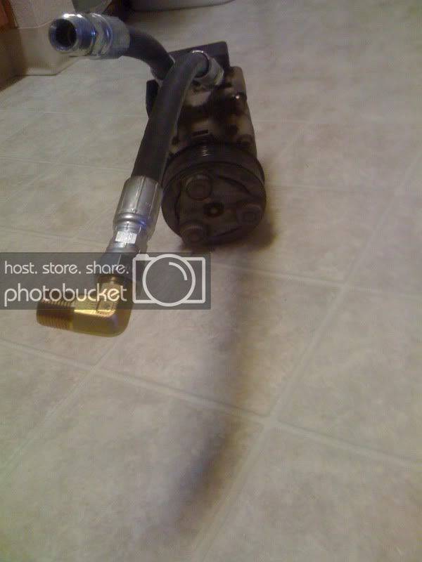

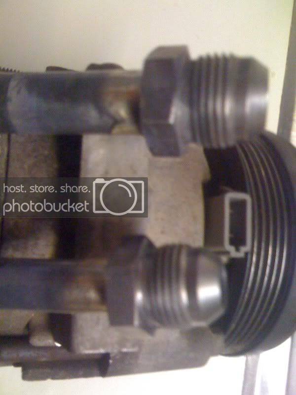

Had JIC Fittings welded to the end of my stock manifold

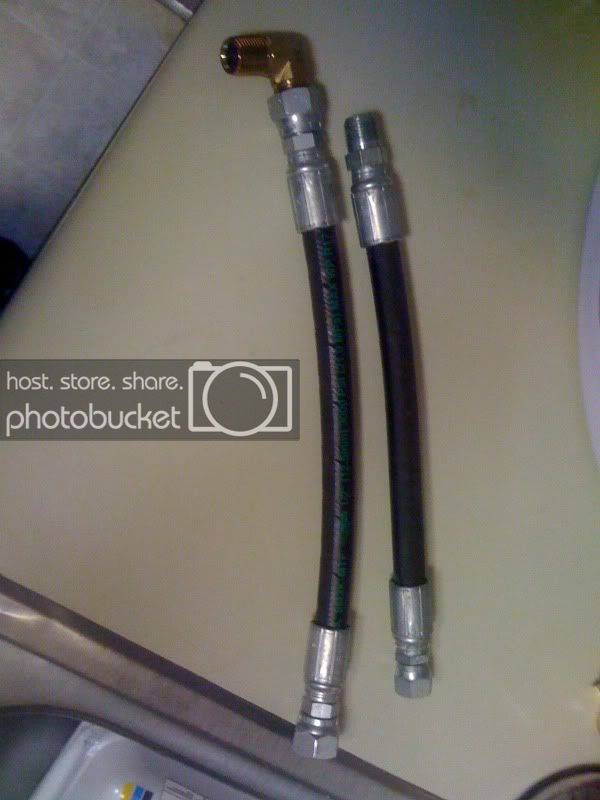

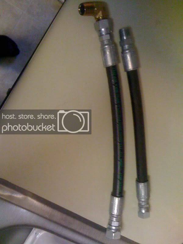

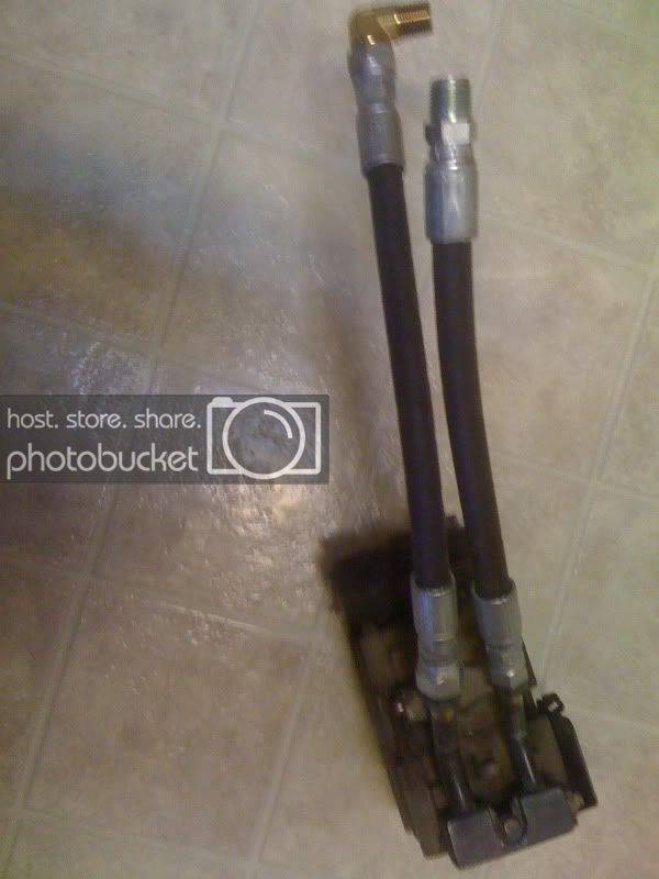

Went and had some hydraulic hoses made JIC to NPT

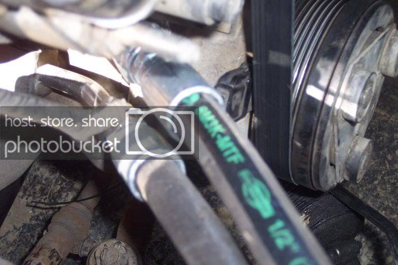

the hoses on the compressor

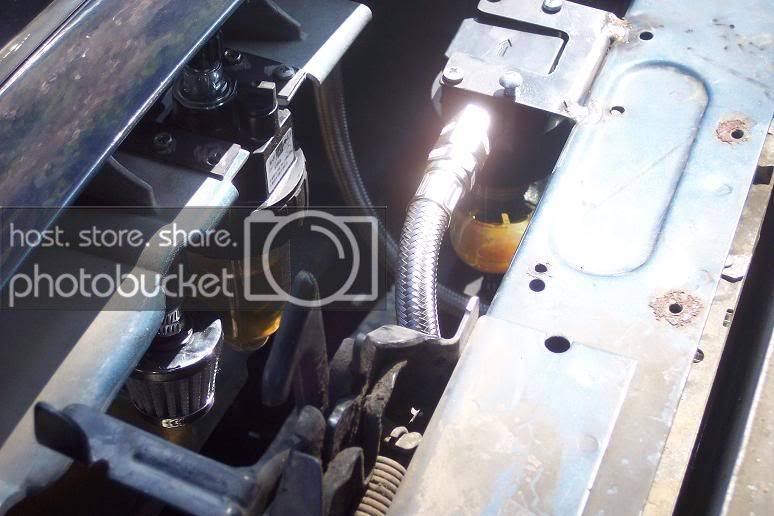

Oiler and oil/water separator mounted behind my front grill

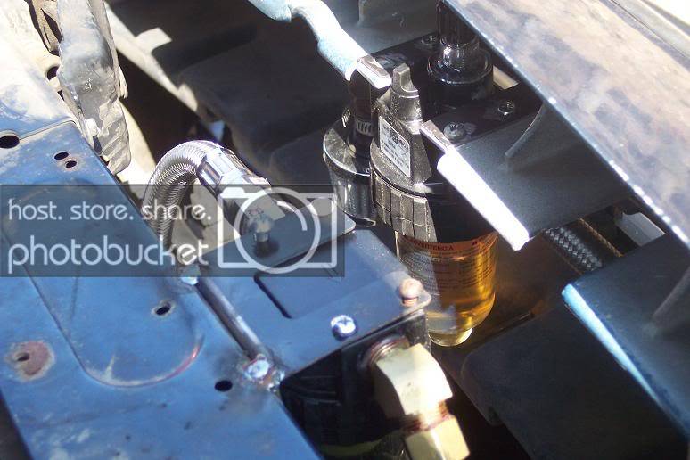

This is what you see of the oiler with the cowl back on

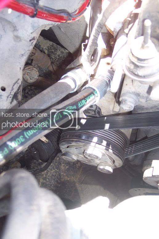

Compressor mounted with new manifold
This is so much more efficient than my 2 electric compressors fills my 2 5 gallon tanks in 2-3 minutes instead of 20
