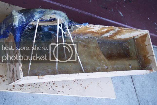

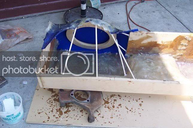

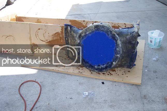

ok 3rd layer is done!!!! ive gone through 1.25 gallons of resin already and close to 50sq ft of mat. ill have to stock up when i get ready to add the mdf ring in. and i guess ill use some cheese cloth to get the beginning shape. so just one more layer on the inside and that should be good and sturdy!!!

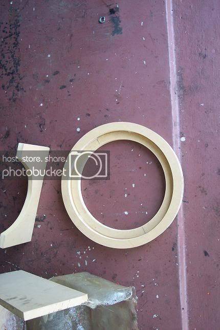

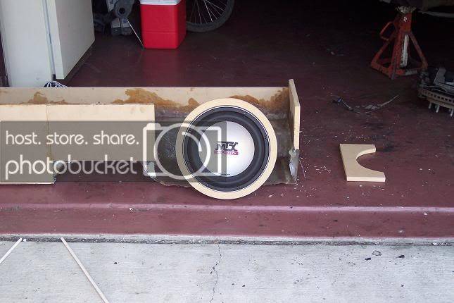

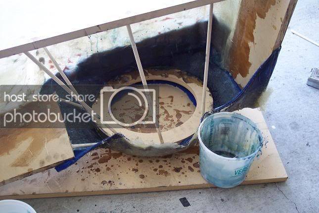

1" mdf ring 2 layers thick for a flush look.

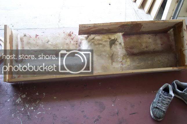

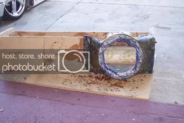

box out of the truck

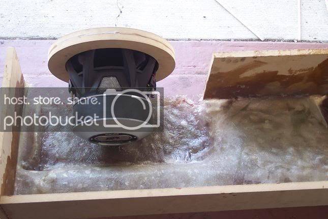

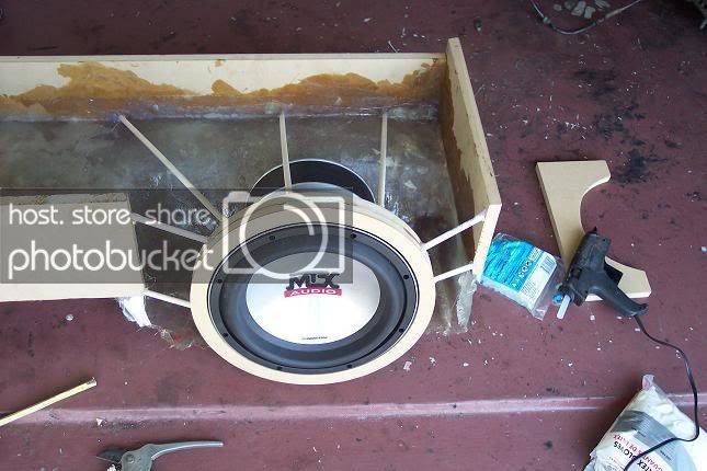

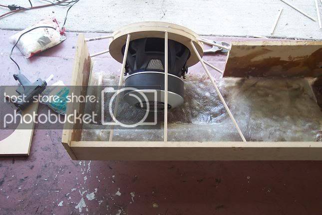

mock up of how the sub will sit

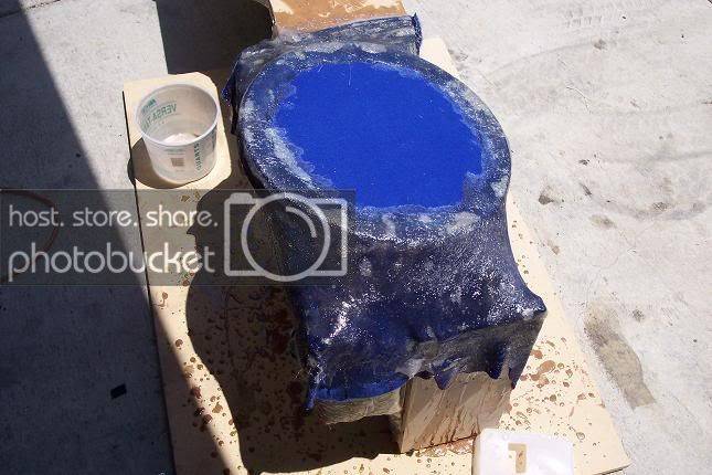

a lot of the flece will be cut back and the dowls removed to make way for the top of the box. looks a little rough right now but it will get cleaned up later.
