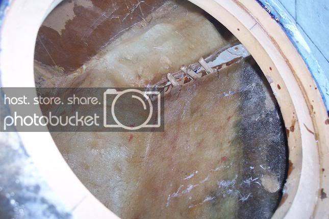

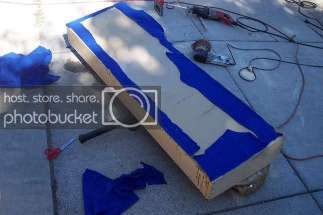

might be late. but Kitty Hair would have been better to fill the gaps then using the fleece
yea im going to lay that over the top of the fleece. some of the gaps were kinda big thats why i went with fleece first and i didnt feel like messing with fiberglass at that moment either. lol.

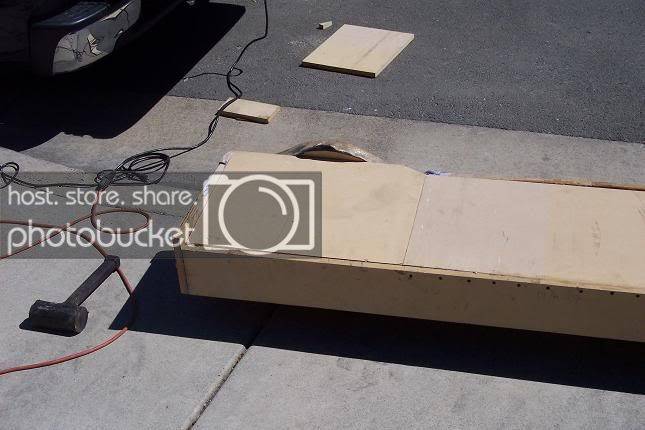

so heres what we got today

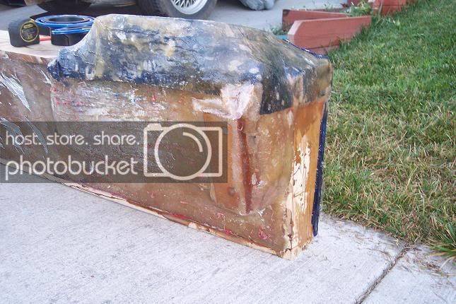

this is where i planned for the stock bolts of the truck the ones that usually hold dont the seat to come in through the speaker box. as you can see i took a piece of wood for the bolts to go through and then using wooden dowels i hot glued the piece to my box to figure out the depth of the wooden bracket.
here i covered the bracket with fiberglass

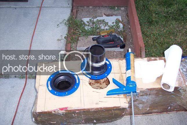

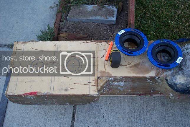

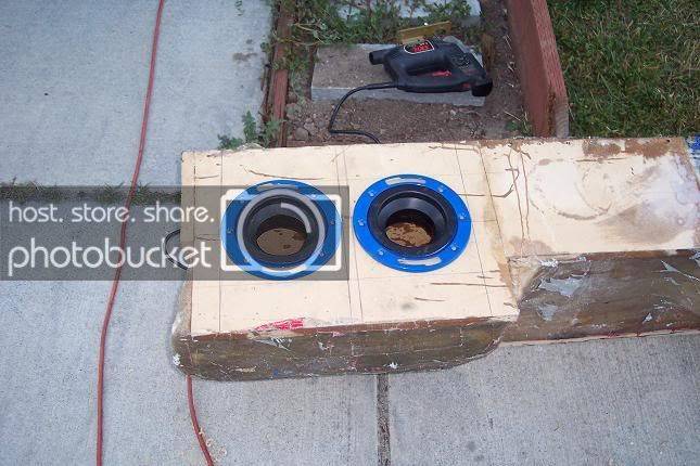

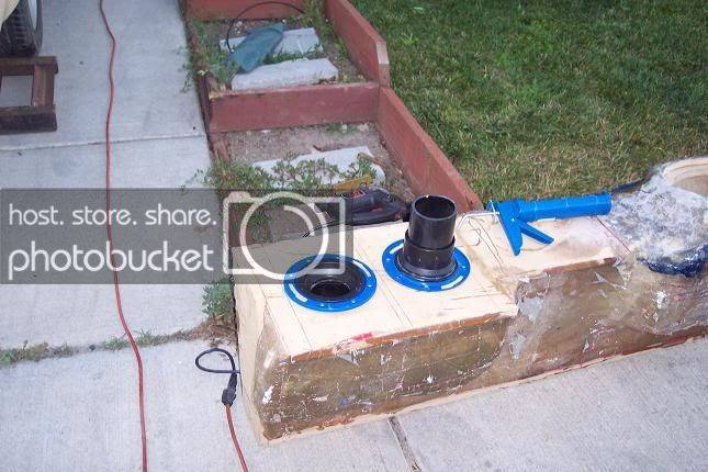

laying out my ports. got some nifty stuff from the hardware store to make my ports out of
so i went to the plumbing section of the hardware store to find some pipe to use for my ports. i cant remember what the stuff is called its black tubing not pvc well anyways as i was heading out i noticed the plugs used to mount in floors so the description said and i really liked the shinny blue ring on them so i decided i would use them as the flare end for my ports making them much easier to attach to my box.
here i cut the tubing and inserted into the plugs the measure 5.52" long and have a 3" inner diameter.
and here i sealed everything up with liquid nails for one to hold everything together and two to stop any air leaks.
