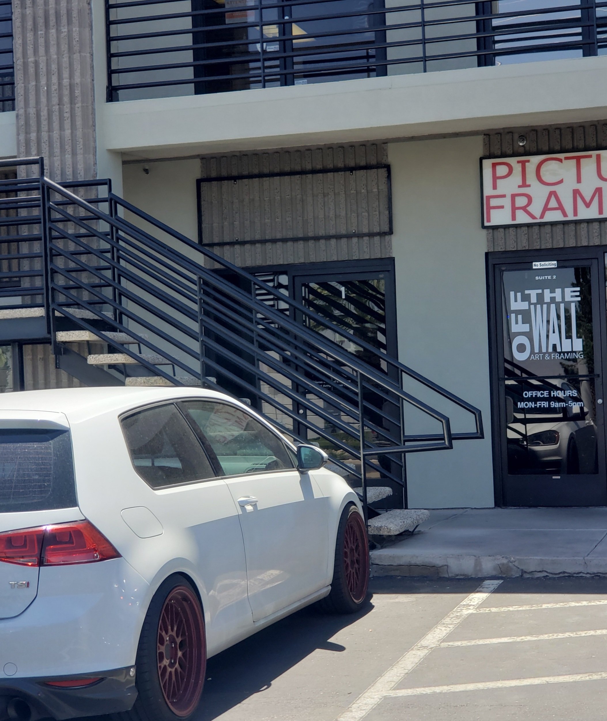

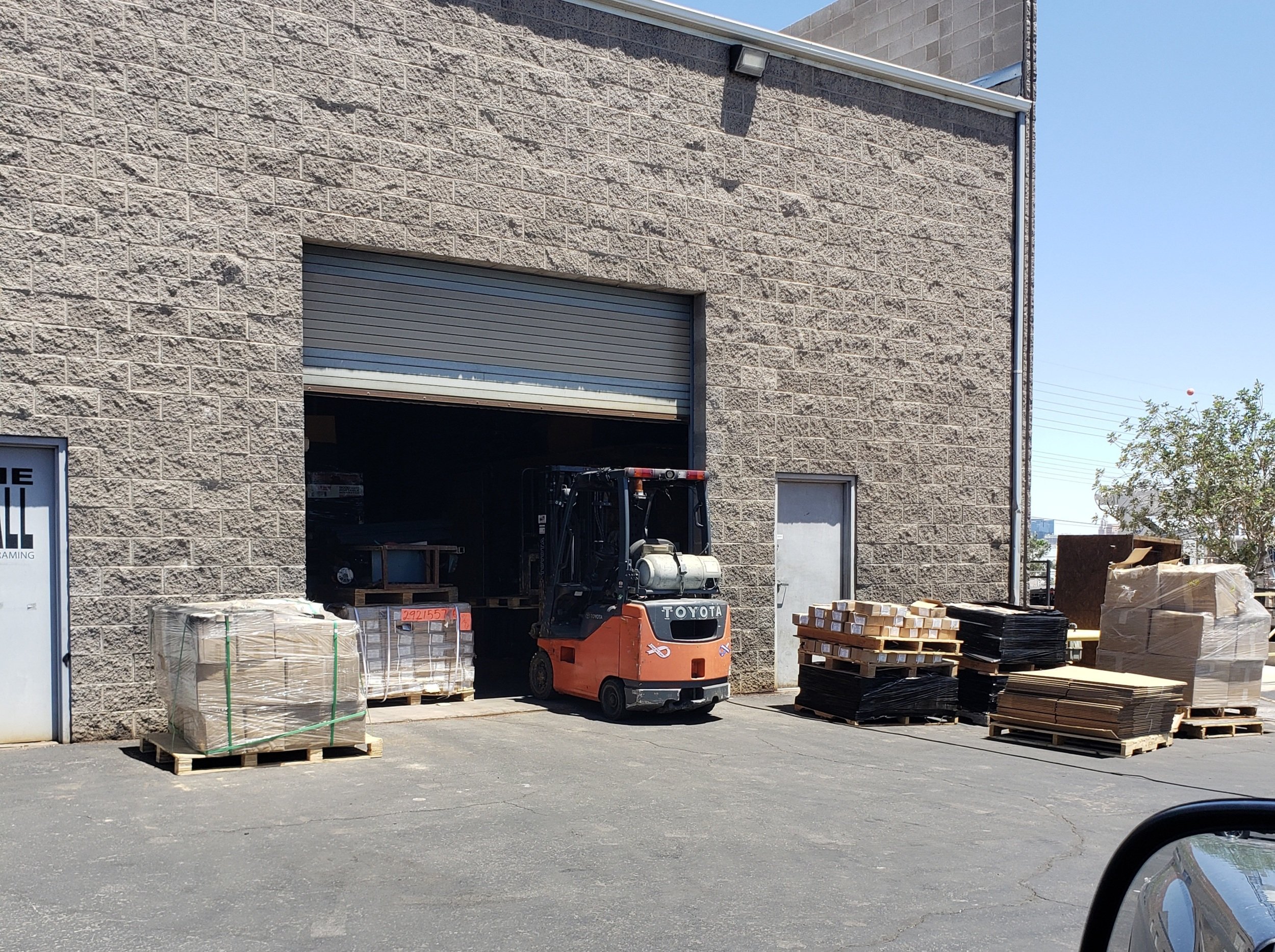

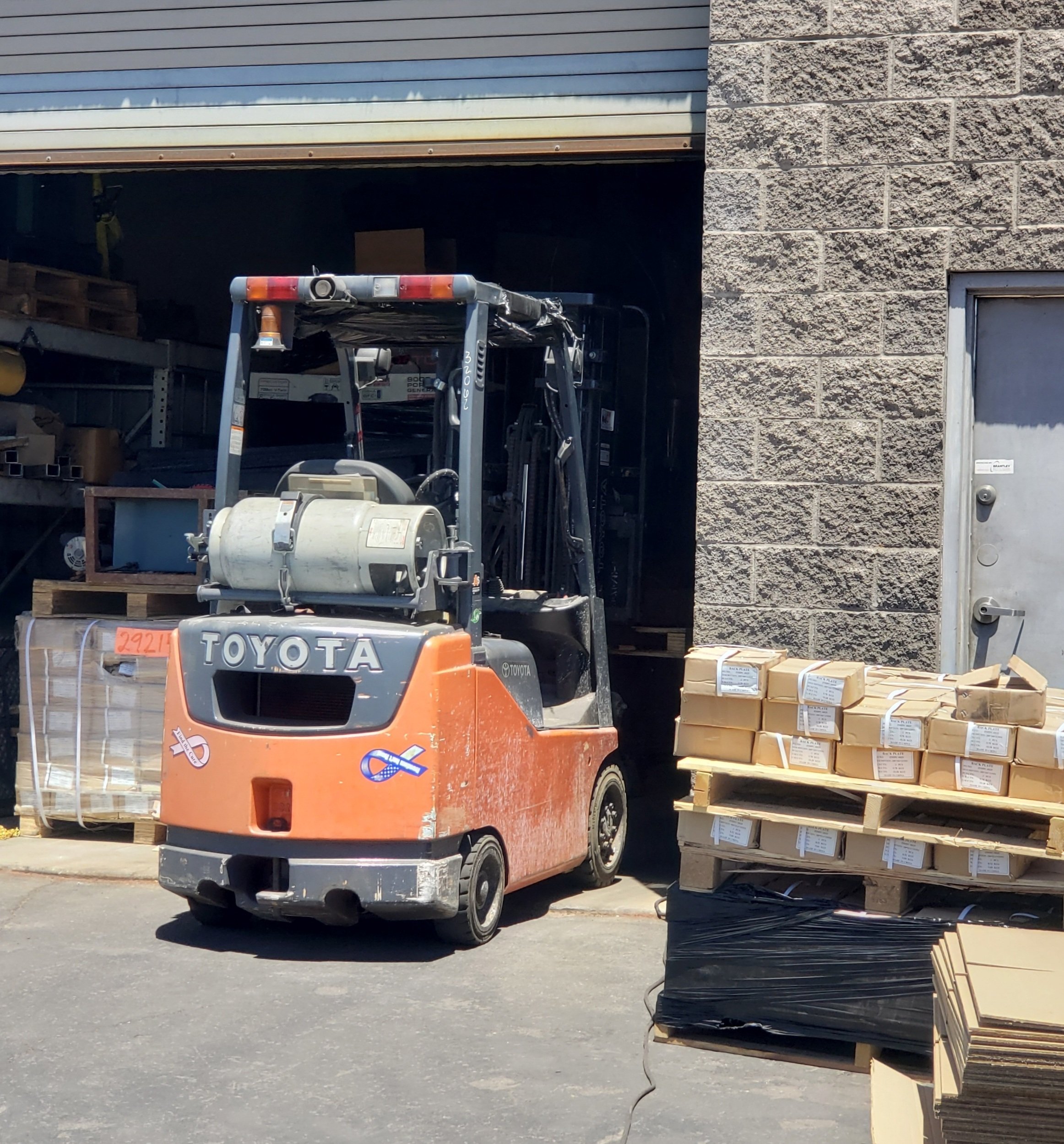

Does Fi’s build house still look like that? Did you go by there the next day to take a follow up pic?
This is from today at noon local time. Fi is suite #1 downstairs.
