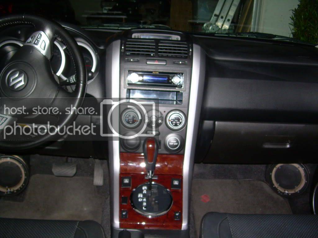

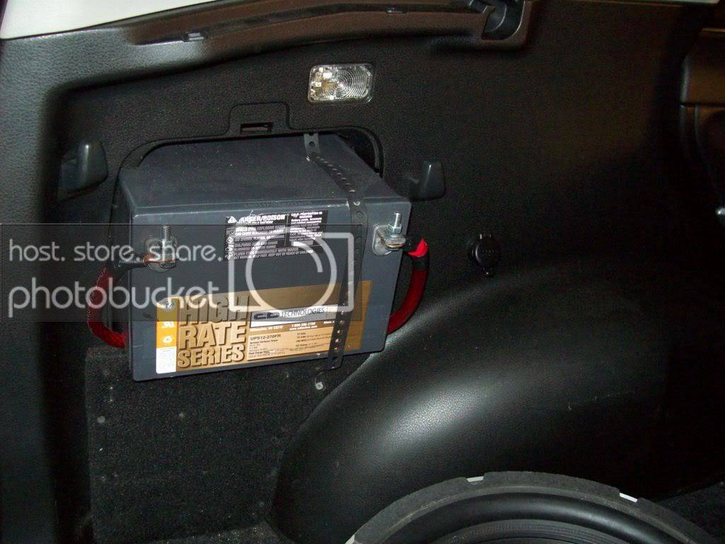

Alright, I figured I had enough of the equipment I need for my next build to start a build log. The vehicle is a 2006 Suzuki Grand Vitara. I'll be adding another amplifier for my fronstage in the near future as well, it'll be way more power than I need but there's nothing wrong with that //content.invisioncic.com/y282845/emoticons/biggrin.gif.d71a5d36fcbab170f2364c9f2e3946cb.gif The system will consists of:
3-Way Active Fronstage Setup:
Pioneer 800PRS Headunit
Rockford Fosgate 3sixty.2 Processor
Focal Reference 8's (Midbass)
Hybrid Audio L4's (Midrange)
TBI HDSS (Tweeters)
Amps:
PPI PC21400.2 (Subs)
PPI PC4800.2 (Midrange and Midbass)
PPI PC2400.2 (Tweeters)
Subs:
2 Older Round Kicker Solo-Baric 15's

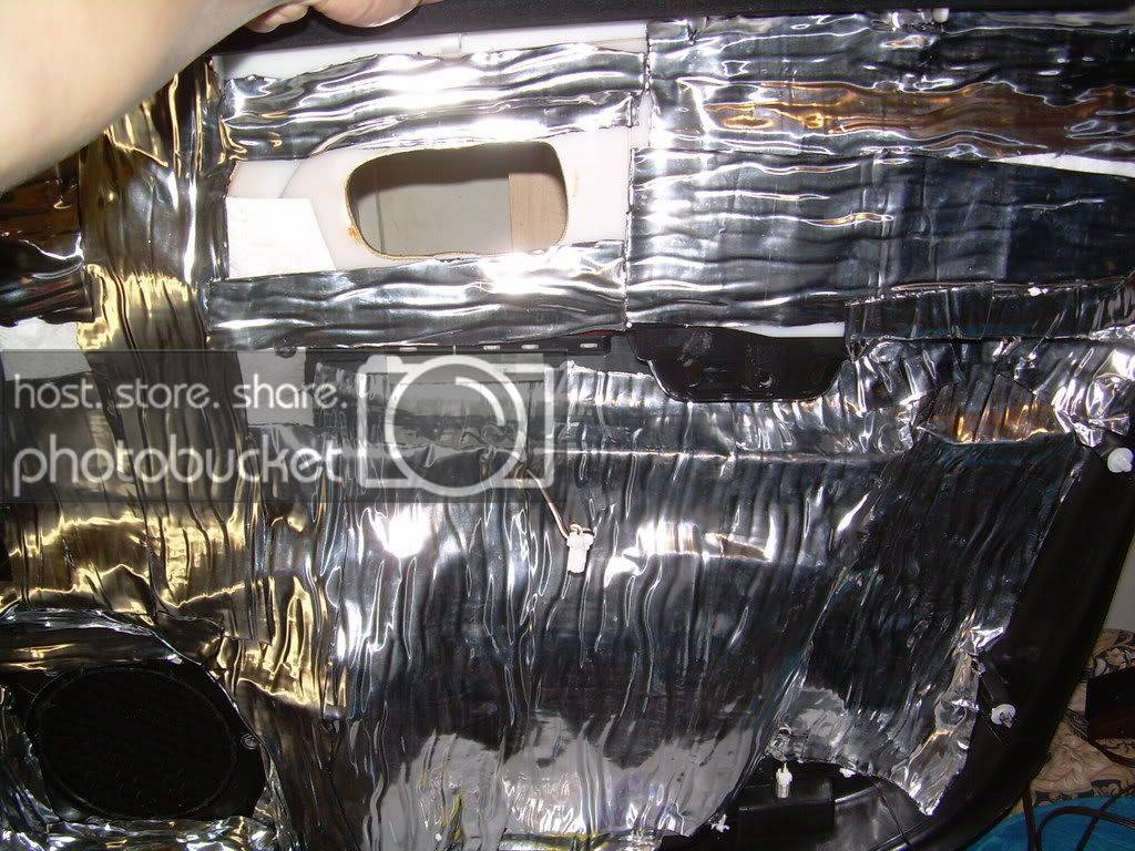

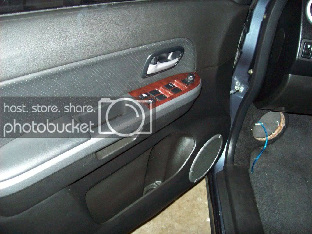

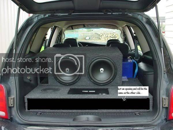

I had a lot of my car deadened already with Raammat and Ensolite but I'll be getting some more soon for a few more areas I need done. Kick Panels were made for some 6 1/2" Germaniums I had. I had to make a little baffle for the L4's to fit and I'll need a little carpet to finish those off. My doors will most likely need some modification to fit the 8's but I won't get them in til next week. And last but not least, Fastimes is building me a sealed box for the 15's which will be 1.6c/ft for each chamber with a slanted back so it fits flush with the back seats. He is also building the amp rack and will resemble the pic. that I've attached.
The goal for this build is very good SQ with the ability to get plenty loud. My 15" MX on a Stetsom 2k6d did a 144.x legal and if I can get around that I'll be happy. Feel free to critique my system (please don't be a dick about it though) and let me know of any suggestions you may have.....Thanks
