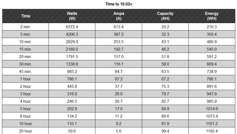

Odyssey battery always lists larger draws in their spec sheets. I always appreciated that about them. It looks like they just use Peukert, but still good info for reference.
