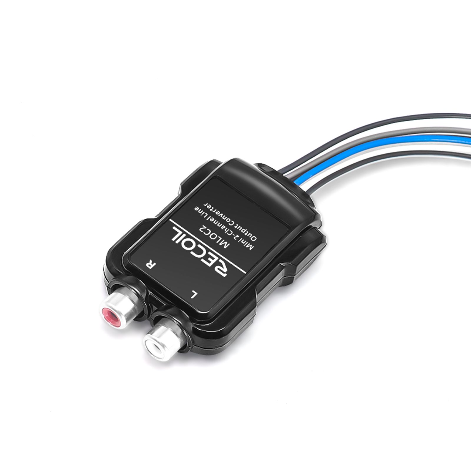

I was thinking that most powered units have a built in LOC, but, whatever you do, don’t get the SOSCHE, it does not test clean at any level. The kicker Kicker KISLOC2 is a cleaner way to go, by far. It also does not require you to use the remote turn on from the HU. It generates the turn on voltage from the high level speaker inputs negating the need to use the HU. Here is the unit on Amazon.​
Amazon product ASIN B00I4EF1BC
Here is a YT vid that tells you what I’m talking about.
Just tap into a pair of speaker leads, run power to the powered sub, RCA’s from the LOC set your gains and you’re good to go.
Here is another one that gets great reviews

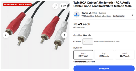

Is this the cable I am looking to connect to the Kicker and the InPhase SW please?
