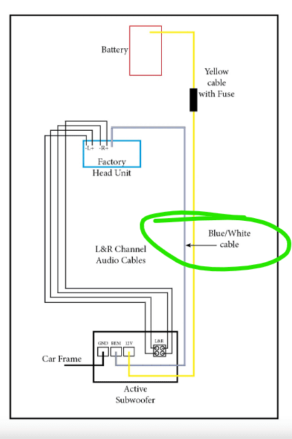

It's a InPhase Active Subwoofer and rather than clogging up the forum with more gumph and images, page 2 has the configuration and some images.

If you look at my wiring diagram, I still need to get to the back of the H/U to connect the REM connecting cable.
Where on the back of the H/U does this REM based cable connect please?

The blue/whit wire from the HU should be the remote turn on if you don't have an LOC.
As for the speaker leads, you can just run a pair of leads off the back of any L/R speakers from either the front or the rear speakers, it doesn't matter if it is the front or rear, just make sure you use L&R from either the front or the rear to the high level inputs on the powered subwoofer.

I now understand the speaker cable situation but have become so confused with the REM cable???
I was told the Blue/white cable came out of the HU and into the REM port on the SW (hence the diagram drawn as it was for initial confirmation).
You are now telling me differently, so please can you explain?
Plus, it still doesn't answer my initial question about what cable/port does the blue/white cable connect to, with the back of the HU?

Please provide the make/model of the head unit you are going to use so I can look at the wiring diagram. Your diagram above is correct as only as the HU has a REM wire coming out of it.
