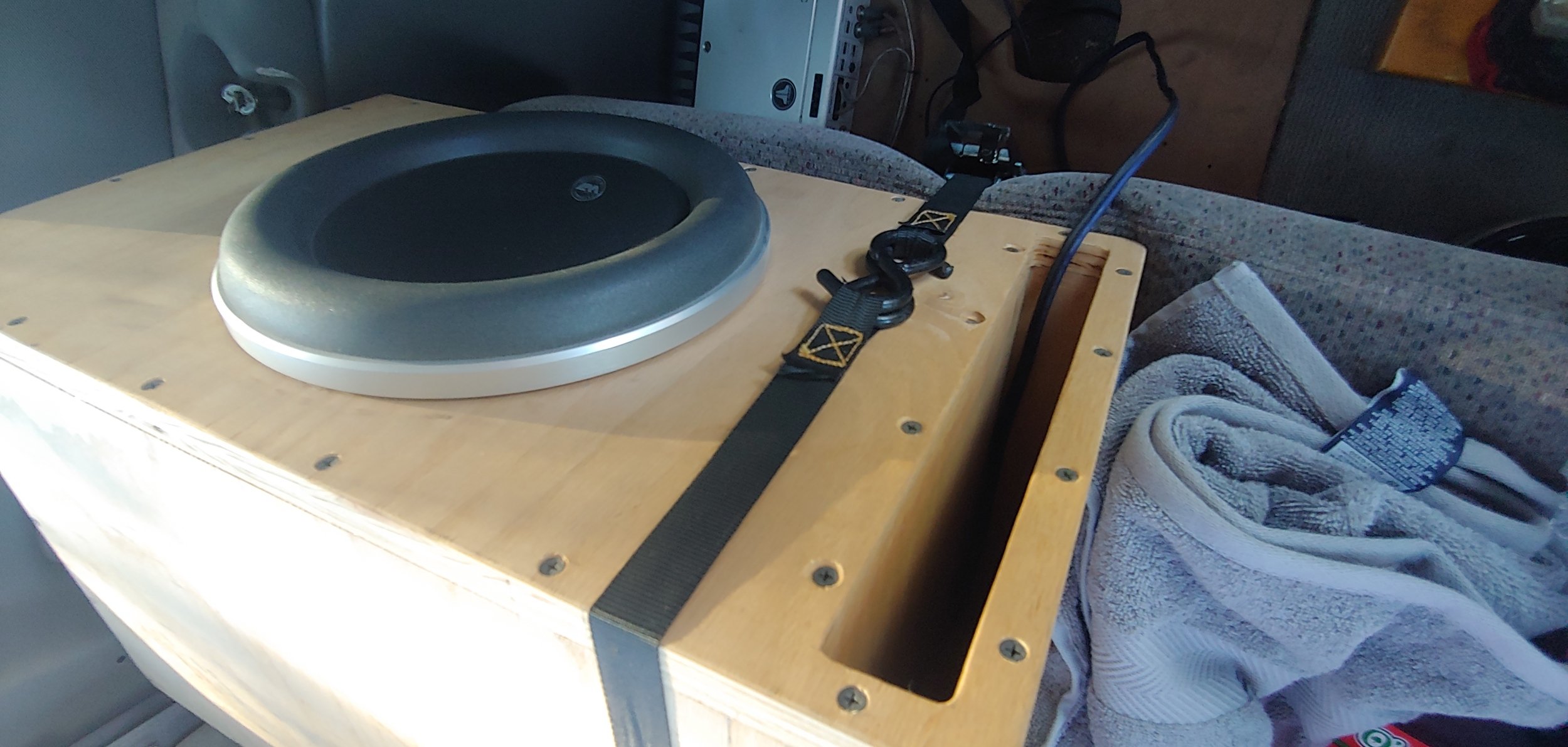

I have to use these to keep my subs setView attachment 44067
Safety takes precedence over all else. I ratchet strap my sub to the back seat. Looks cheesy but I do not want it slapping me upside the head.
