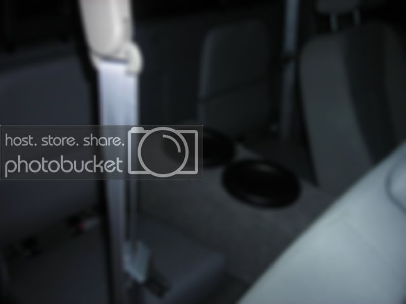

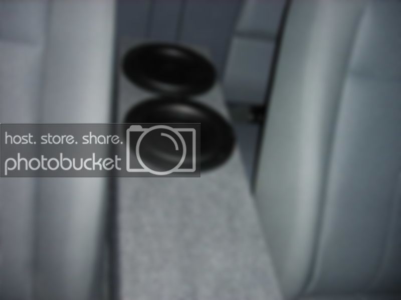

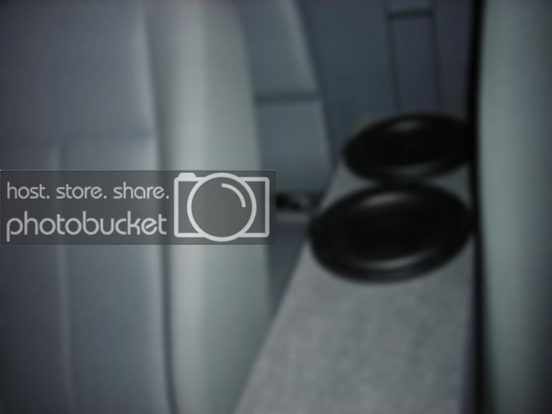

Just as the title says. Also, thanks to everyone who helped answer questions I've had about this project. Been thinking about this for a long time...finally did it.

Overall impressions of the Assassins is wow. Very clean all over. The box is roughly 1.2 cubes after sub/port area. Tuned to 38 hrtz. Each sub getting 200 W. I listen to everything (blues/rock/country/screamo/little rap crap). It sounds amazing. I even threw in some Jeezy to see what they could do. Unbelieveable how low these things hit. I'm very impressed with the overall SPL. Oh, and that was my first carpet job on a box. Not perfect, but not that bad either.
Thought I would share...thanks for looking.

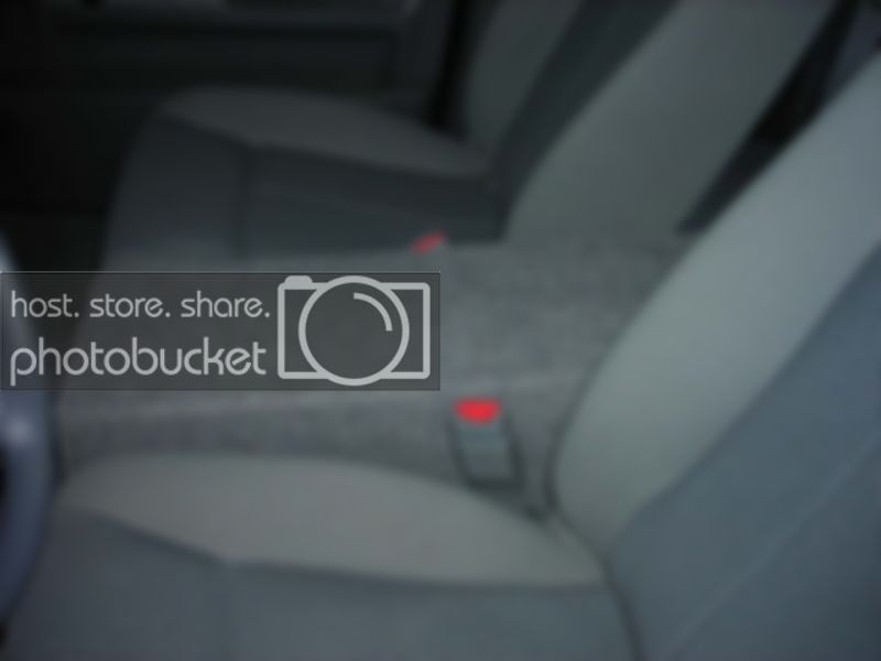

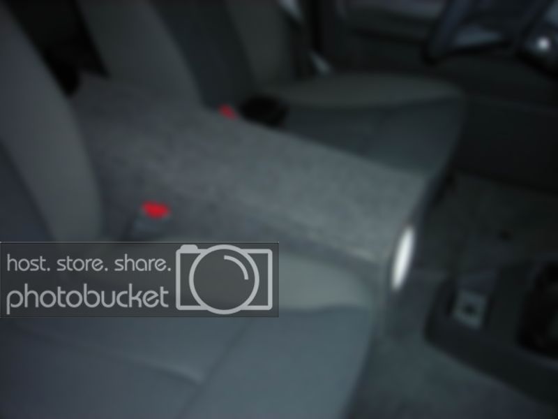

if i were you i'd put some strong grills on those subs. wouldn't want someone in the back seat resting their arm on them etc. also is the box secured down? looks different i'm sure it's loud though...good job
99% of the time, just me in the truck. Sometimes, kids ride back there. No real room for anyone else. Good suggestion though.
As for securement, if you look at the 1st picture, between the seats you can see 2 black metal brackets that my center seat/arm rest used to mount to. There are actually 4 of these, and the box is now bolted to them.
