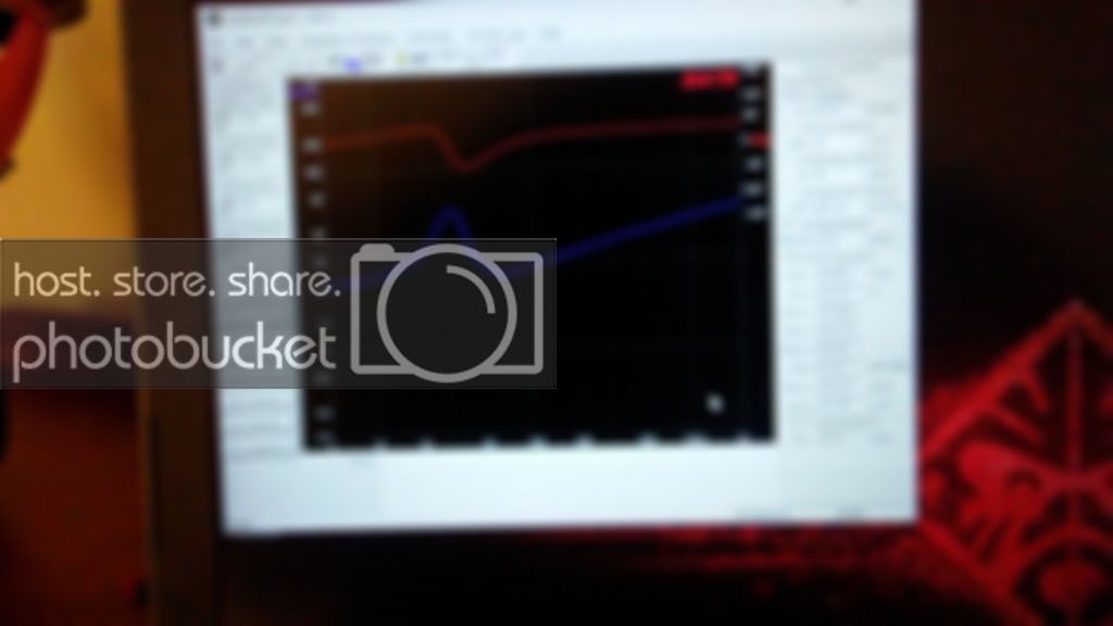

i finally got a chance to do some parameter testing and i was very surprised the QES was that high. it most certainly isn't a laid back sounding driver. i opted for the y30 magnets as recommended but i might use the y35 grade instead.

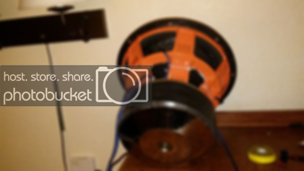

Here are the parameters of the broken in rebuilt woofers..

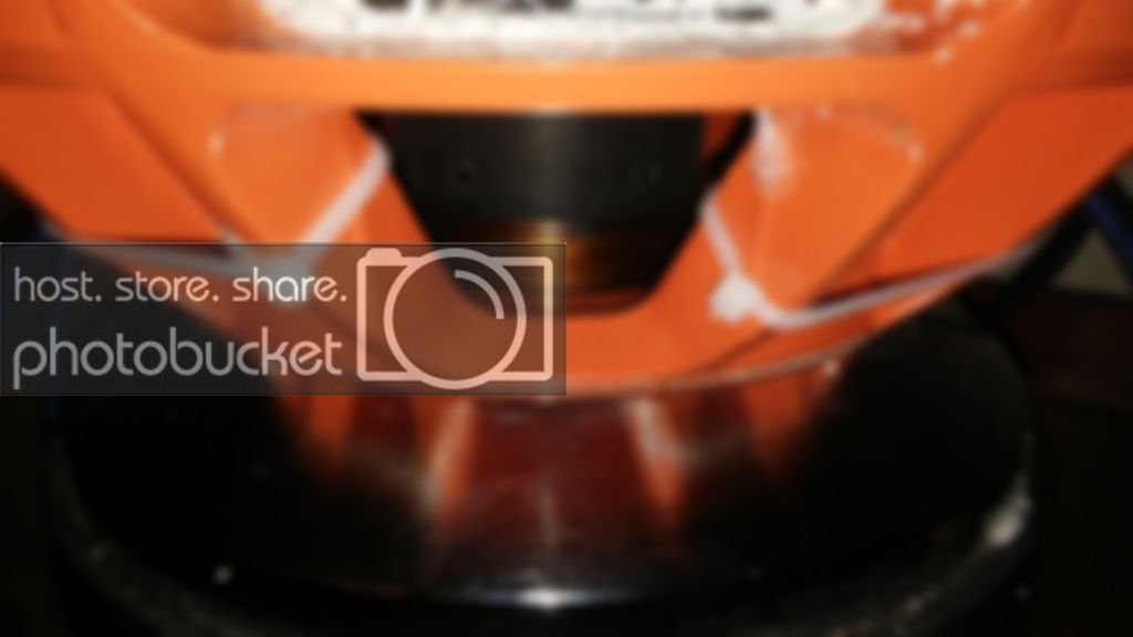

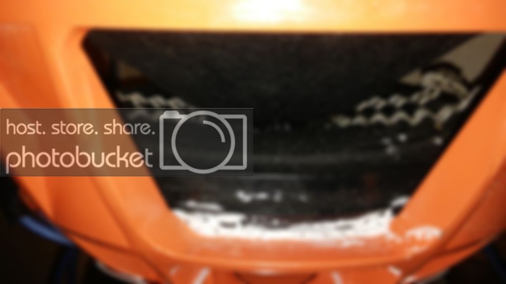

disregard the tie wraps and the extra glue. i put extra to make **** sure it would hold.. lol the leads are soldered IE direct connect. those cheap *** banana bindpost are a NO NO unless its copper plated..
