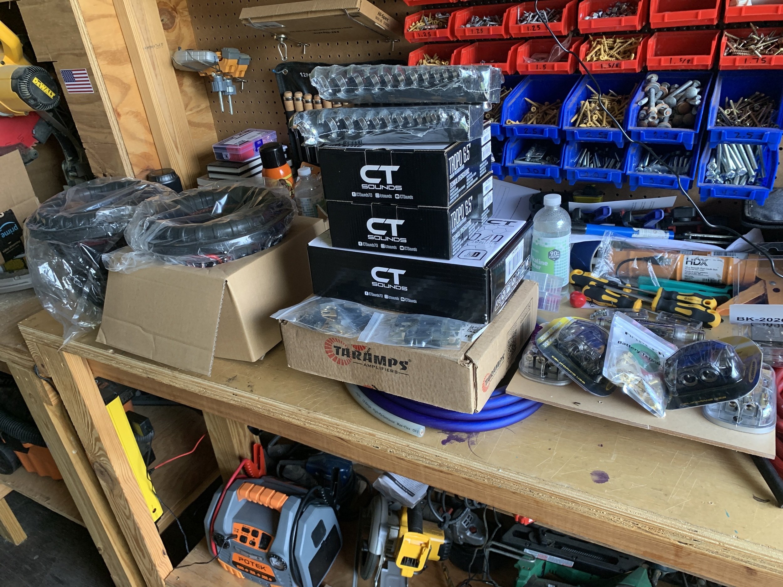

should be like xmas today after the mail runs. the ct amp and most of the other goodies should be in today. waiting for the alternator, hopefully soon. if it doesnt rain this whole weekend again, i should be able to start the big 3 and maybe go ahead and run the power and redo the ground wires. the other sub should also be here today. my only concern is getting to the tension arm for the alternator. looks like i may have to drill a hole to get a t50 onto it. dont know if i could get a wedge bar in there or not,, its tight. may also have to cut into the grommet some more to pull the new 0 gauge through the same hole as the 4 gauge. thinking of running the 6 channel rcas also, i already have 3 3ft rca extensions if i need them for new amp rack. if i can manage it, i ordered some abs plastic board to maybe mount the amps behind sub box to save on running long lengths of cable.
all subs in, 6.5's in , amps in, dist blocks in,fuses in, terminals in. still need 0 gauge to come in and alternator and sub box, plus a couple of inlines and then i should be ready to start. also ordered some more carpet and some killz mat.

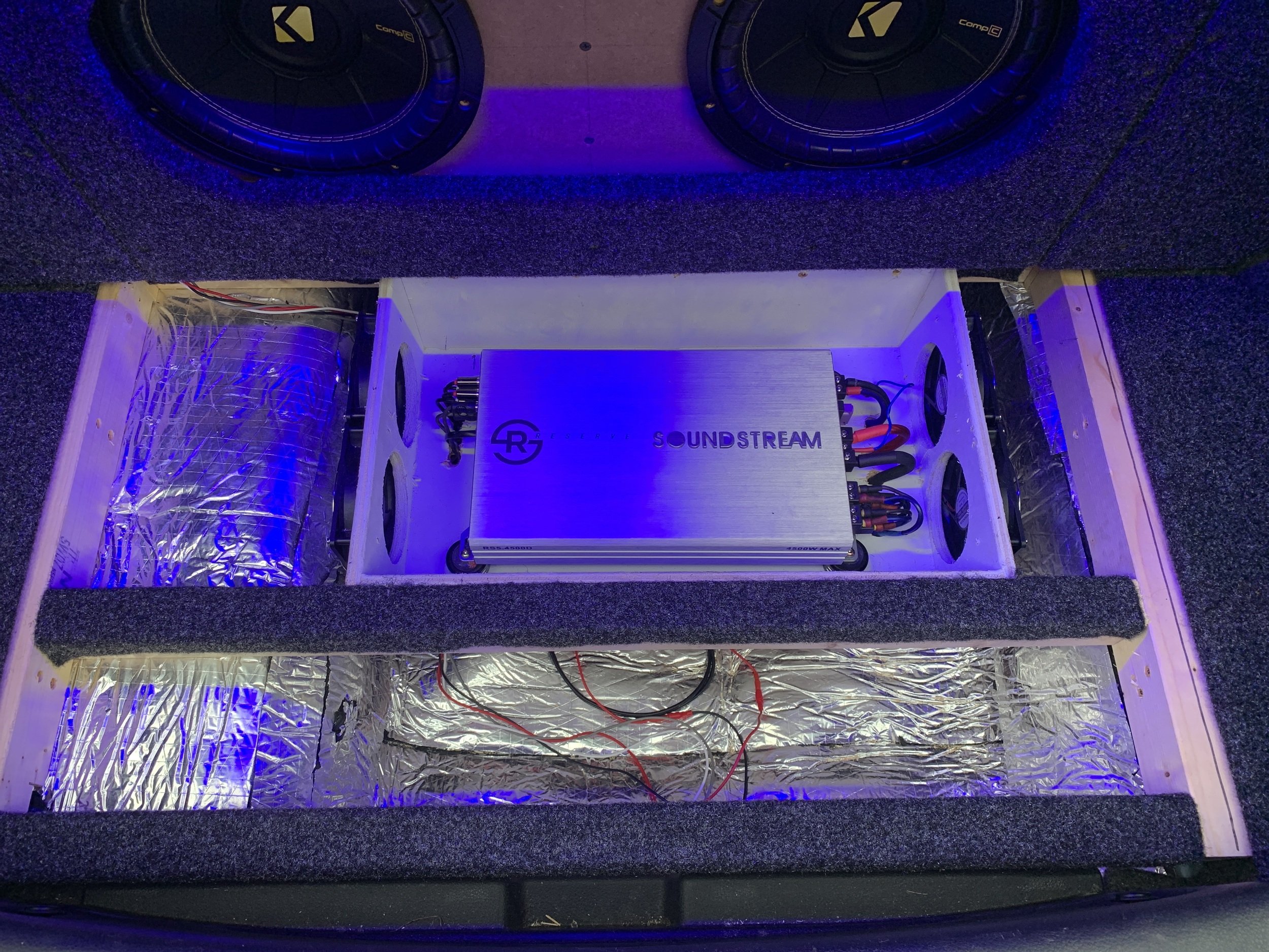

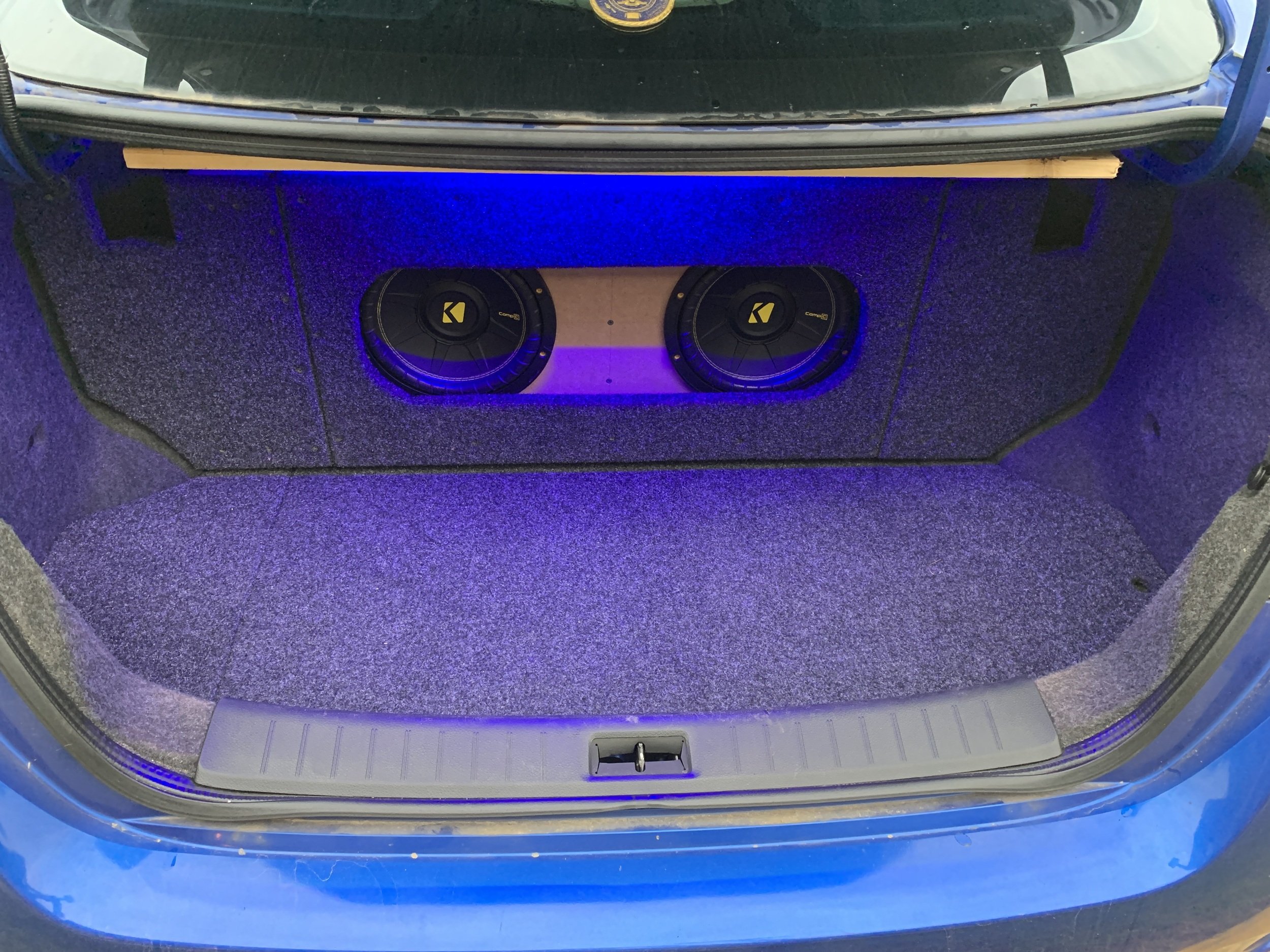

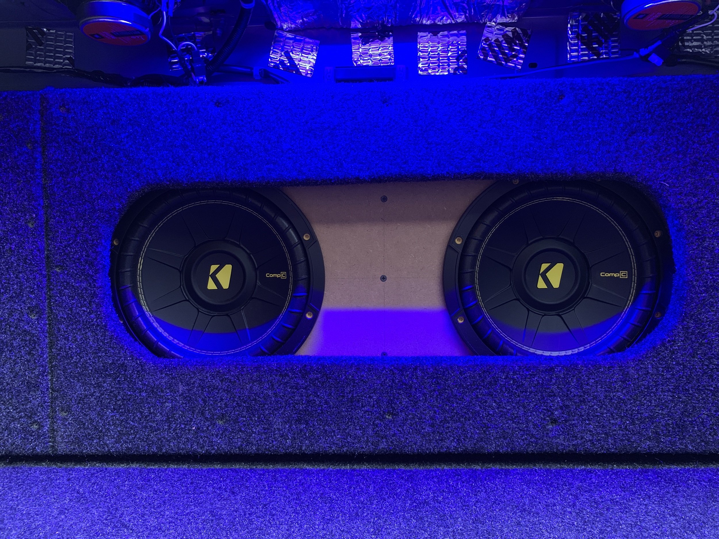

yes, i went ahead and ordered the sub box yesterday . glue it and screw it kit( dual 10's high output) but instead of mdf, i went with the 13 ply birch, that way, i can either carpet it or stain it. i may have to put the box on a riser so i can get inder the false floor to do the wiring. or i may be able to make some abs plastic frame racks. its all experimental. will have to make new face plate for the new box, but i should still have some mdf left over from the other experimental box. i made it taller and wider but kept it thin.

First Pic.. I see some Azz of some rear deck speakers that need to be capped off.Those XFL subs will push those cones beyond max and will destroy them. If you going to keep them.. and use them.. make some caps from plywood or MDF and seal them off from the trunk air space to keep them alive. 👀 👀
