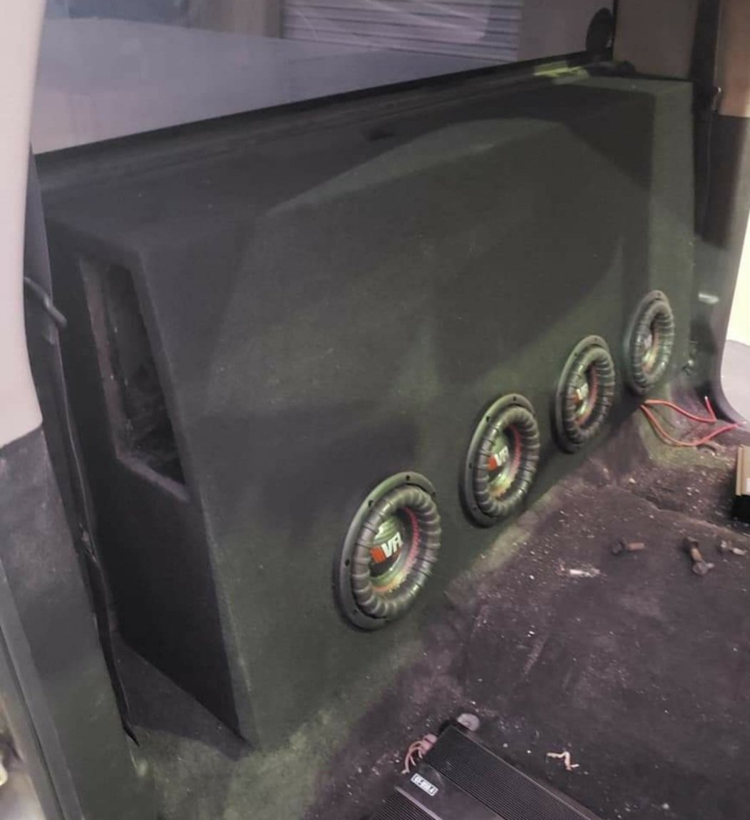

4- VFL8's on a Sundown SIA3500 in my truck. They can handle the power, get low, and do numbers. The 10's are 800 rms but I know that they can easily handle 1,200-1,500 watts.
Yes. I have seen your build and some of your test scores you posted. I do not doubt that the subs perform well. All my A.B. subs do very well. I dont remember the VFL series in the 10inch made in a DVC2 or 1 ohm version, just the DVC4s though.
