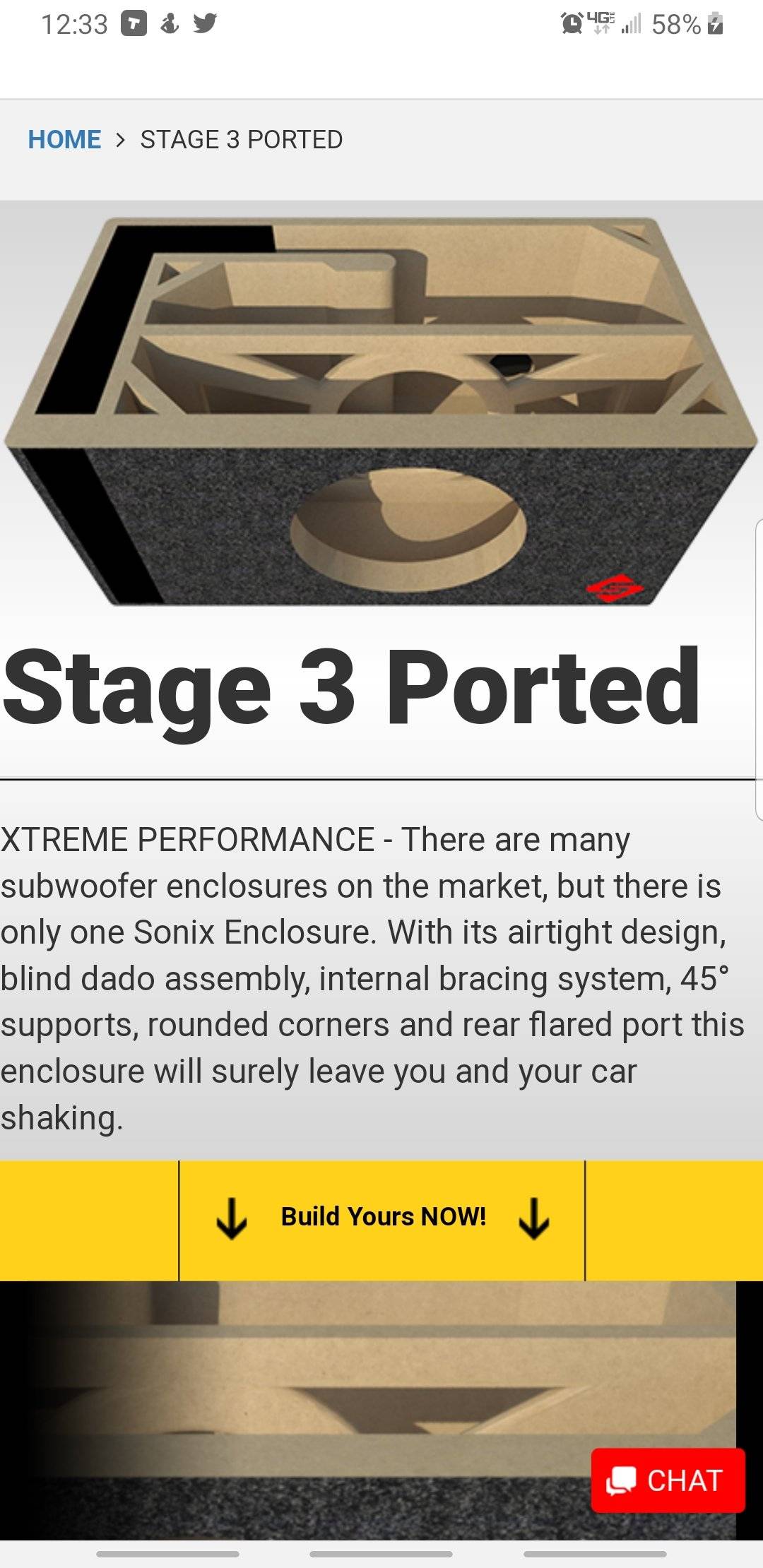

There is some good prefab boxes being built. These boxesooked pretty legit to me, but who am I? View attachment 18413
really not much info there. looks nice though. Do they at least give you the port area? Total or per ft? There is such a thing as too much or not enough. Do they give the dimensions plus bracing so one can check it before they order? I'm not familiar with boxsooked why I'm asking.
Personally if I were to buy a pre fab I'd want to know as much as possible about the box so I could at least model it to get some idea of how my sub would do in their box.

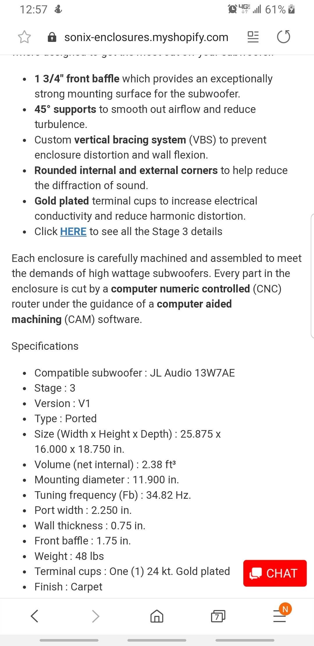

These were the specs for a 13w7 prefab box. Is that a legit prefab or a piece of shit like all prefabs? Asking for a friend 😂
These were the specs for a 13w7 prefab box. Is that a legit prefab or a piece of shit like all prefabs? Asking for a friend 😂View attachment 18414View attachment 18414
I'm in the middle of moving plus 1300 miles from home or I'd model it for ya. Helps to know what amp will be used rms power and ohm load. Car suv etc?Maybe someone can take a look.
At least they're giving that much information on the enclosure.
Not sure I'd call it a pre fab since it's subwoofer specific but no idea how it looks on software program.
Idk about the advertised volume/tuning.. I hate checking prefabs.

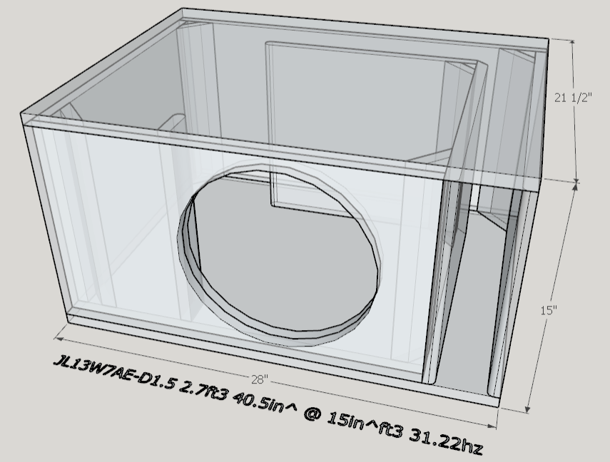

This is a design I did for a member that wanted a big bottom end response (that sounded wrong) and the member was very happy. IIRC it was a RF T1500 powering it.
