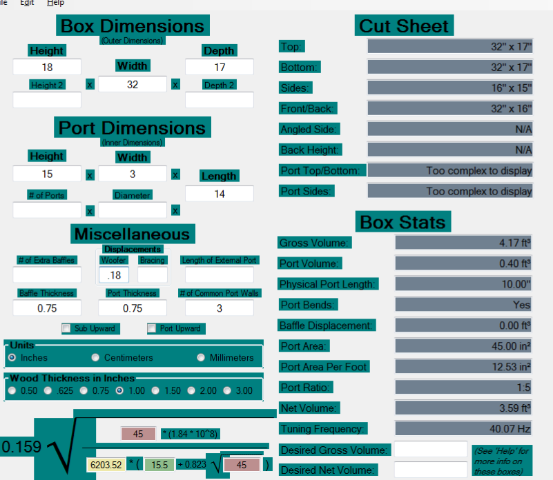

I called American Bass, and they suggested a box 32" L X 18" H X 17" D, with a 3" W X 15"H X 14" D port. I was told to make the whole box out of 1" MDF. I told him the amp I am going to use is the XTR2500.1dz. He said that he wouldn't be responsible for what it's going to do to my bug. Does that box sound pretty legit?
32"L X 18" H X 17" D. Port= 3" X 15"H X 14" D
Was informed to make the box entirely out of 1" MDF.
Any thoughts? Any idea what the tuning frequency would be with this box?
That's ^^^^ quick and dirty btw... I probably would do it different on your power but what are your goals?

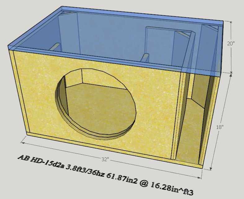

Personally I'd tune mid 30's and enjoy (metalhead), I'd compromise tuning wise (just me) and focus on electrical, a 1965 Bug can't be too easy to put decent electrical in. Idk for sure but I think that sub excels with a higher tuning, it can dig but Spl is what it does well I've heard. Take something geared for Spl and tune low and usually you'll lose output... jmo. I'd try something like this if it was mine on your power...
Sub/port up like My63Bug had, that did pretty good iirc and it was a convertible/softtop. Anyways... I'd try something like that ^^^^ if it was mine.

Is there any reason that the Orion isn't a good choice? I thought 2,984 watts @1 ohm would be plenty of power to run this one 15. I would like it to hit really low and loud. But, I'm not sure the box above will do the trick at 40hz. Wouldn't a box between 30-32 hz. be better? I measured my bug and have room for a box with a width of 35" X 15.5H X 18.25 D. That would leave 4.19 cu. ft. net. With the sub at .17 making it 4.02 net. What would I need to do to tune the box down to 32 hz.? Thanks for all your help man! I'm an old man getting back into the game.

My ride currently has zero sounds. I'm 50 years old and my first system was in 1989 at a cost of $5,500. All Rockford, Nakamichi, and a Sony HU. I mounted the roof rack with little vinyl hose pieces over the metal standoffs. So, no metal to metal contact, we'll see though. Do you not like my amp for some reason? My current bass setup in my Dodge standard cab is two American Bass VFL8d4's. The Amp is a Difital Designs M.80, 900 watts @1 ohm. They are in a custom made ported box behind the drivers seat, firing up. I want the setup in my Bug to be loud and be heard. My truck bass stays in the truck, but those little 8's are bo joke. So, it sounds like I need 4.25 cubes net (before port and speaker) tuned to about 35hz. Any thoughts for this old man would be appreciated. What's wrong with my amp for my setup?
