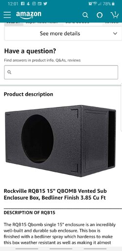

So, best bet is stick with what AB says. Do you think a prefab can stand up to the 15 and the power? Or, do I have to build a box?
Like this one,
Your best bet is to enclose that monster tuned to your taste and sized/ported for your power, configured for your vehicle and please... No prefabs.
Be clear on your goals with your designer/builder.
Like this one,
That 36hz tuned enclosure I drew up above (post #9) would destroy that Skarbage prefab especially with all your power.
Like this one,
Sorry, I sent the wrong one. I meant the Qbomb15vl, 3.85 cu. ft. Tuned to 37 hz.

Like this one,

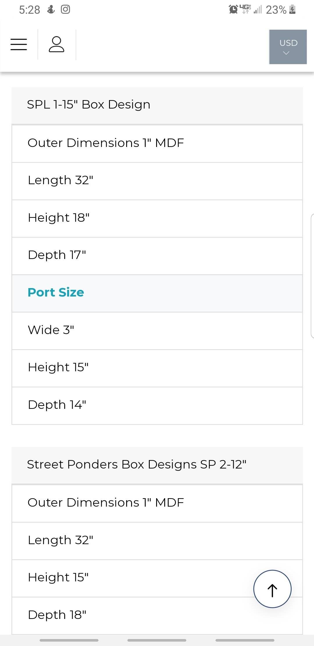

Las Vegas doesn't have any really nice car audio shops. There's one, but he wants $500 to build a box. Otherwise, it's fly by night Hispanics who basically guess. No programs or box building apps used. I designed the one in my truck, pretty basic design. This is what I found from AB for the HD15d2.

I ran the numbers you gave regarding that design in Torres... it looks like an SPL oriented design, NOT for mad lows but will pound. Under 30hz will probably be lacking... especially on your power. What's your experience level?
