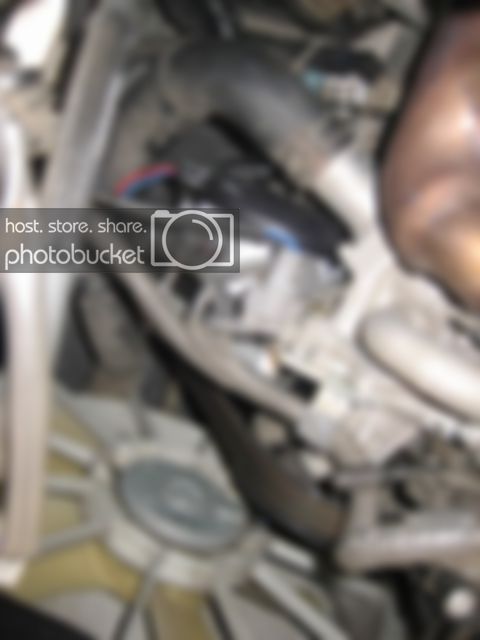

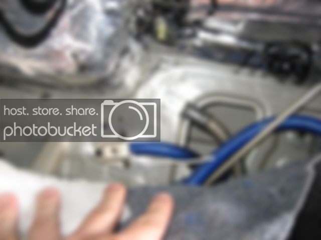

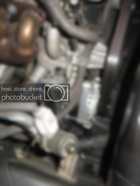

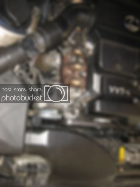

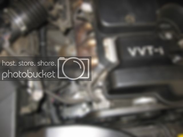

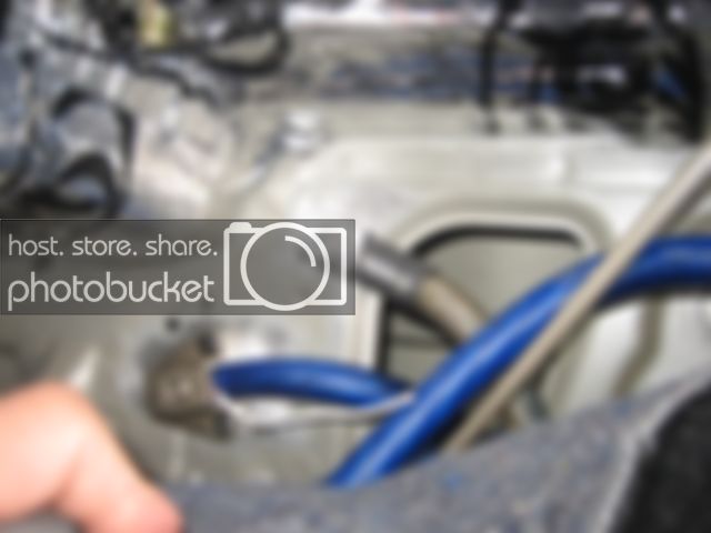

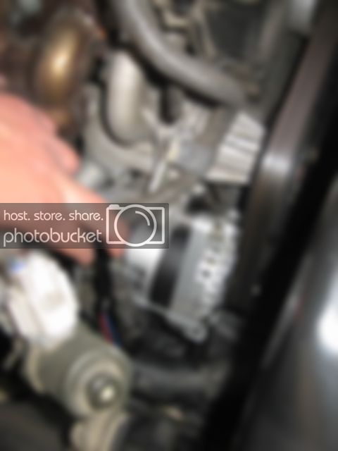

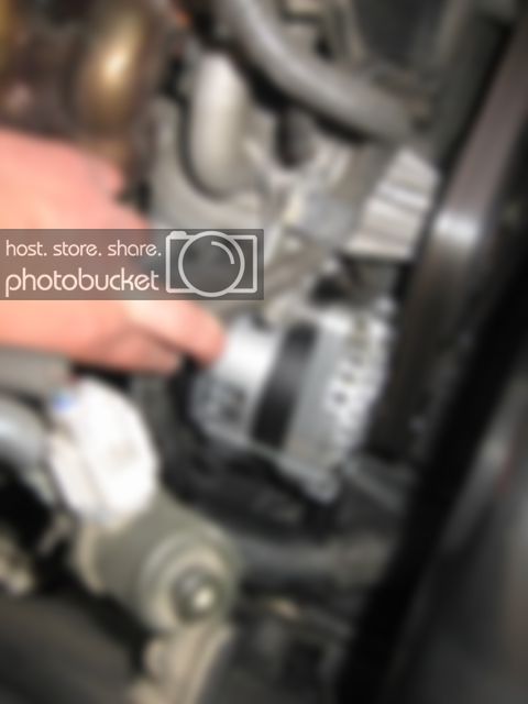

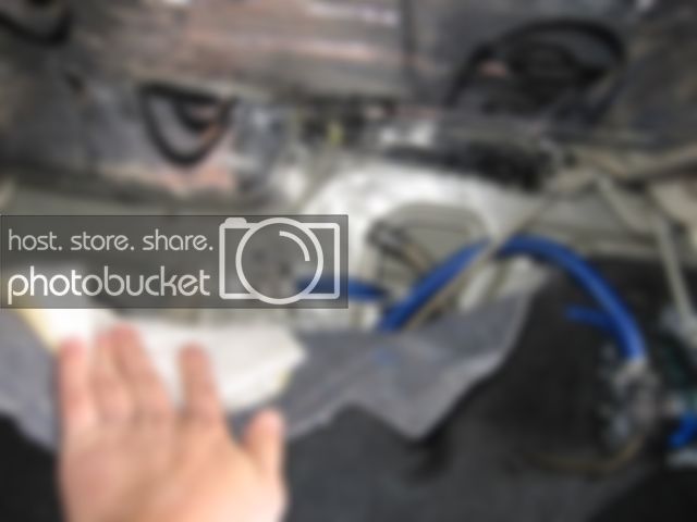

aite some people were telling me to check my grounds. and ive checked them, re-sanded them and made sure they were nice and tight. i feel like they are good grounds but here are some pics, might be a little hard to tell but i guess doesnt hurt to get an oppinion on the grounds (lol yes i know its just a ground but this dimming is driving me nuts) need to make sure verything is good. especially b4 i go out and buy a new battery.
grey= sub amp
blue= capacitor to full range

Was hard to tell if you upgrded your alt wire? Sure you did. What about your upgraded ground to chasis or frame from battery? All those connections are juat as important as the ones close to your amp, this si where your ground is originating from. You also said you did not wanna make runs to the back of your rig with the big wire, what size is gopin back there now for you amps?
