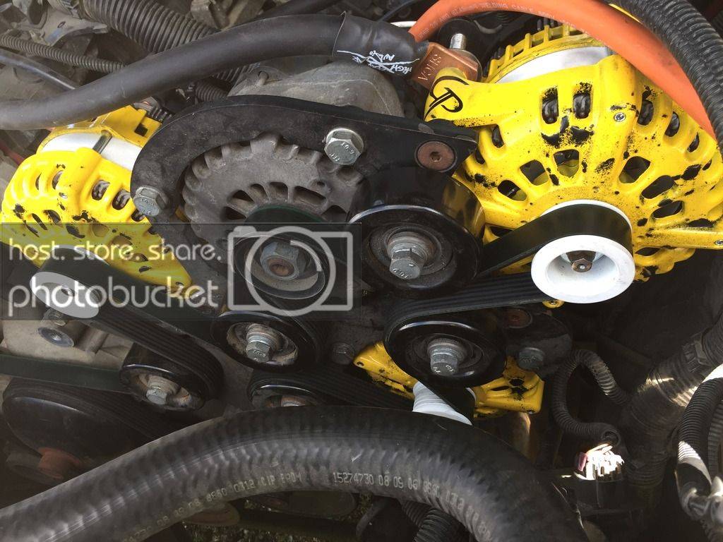

Got the alternators mounted and pulled all my old wiring. Unfortunately, because I got the triple output posts, I couldn't group all the GP alternators together. The post off the edge hit on the bracket, so I had to move the stock alt over. The stock alt's post is off the back. Next, I'll be wiring them up with the blue box regulators.

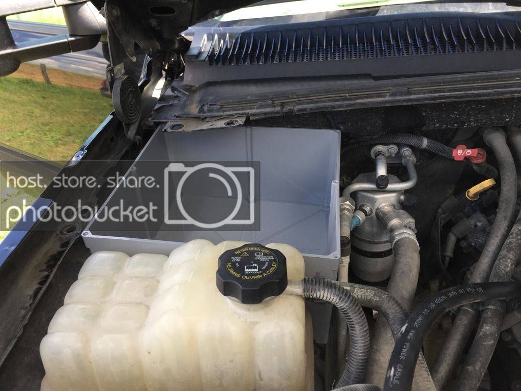

At Lowe's, I found an outdoor electrical junction box that fits nicely where the second battery would be if my truck was a diesel. It's plastic and will do nicely to contain all my fuse holders between the caps and alternators.

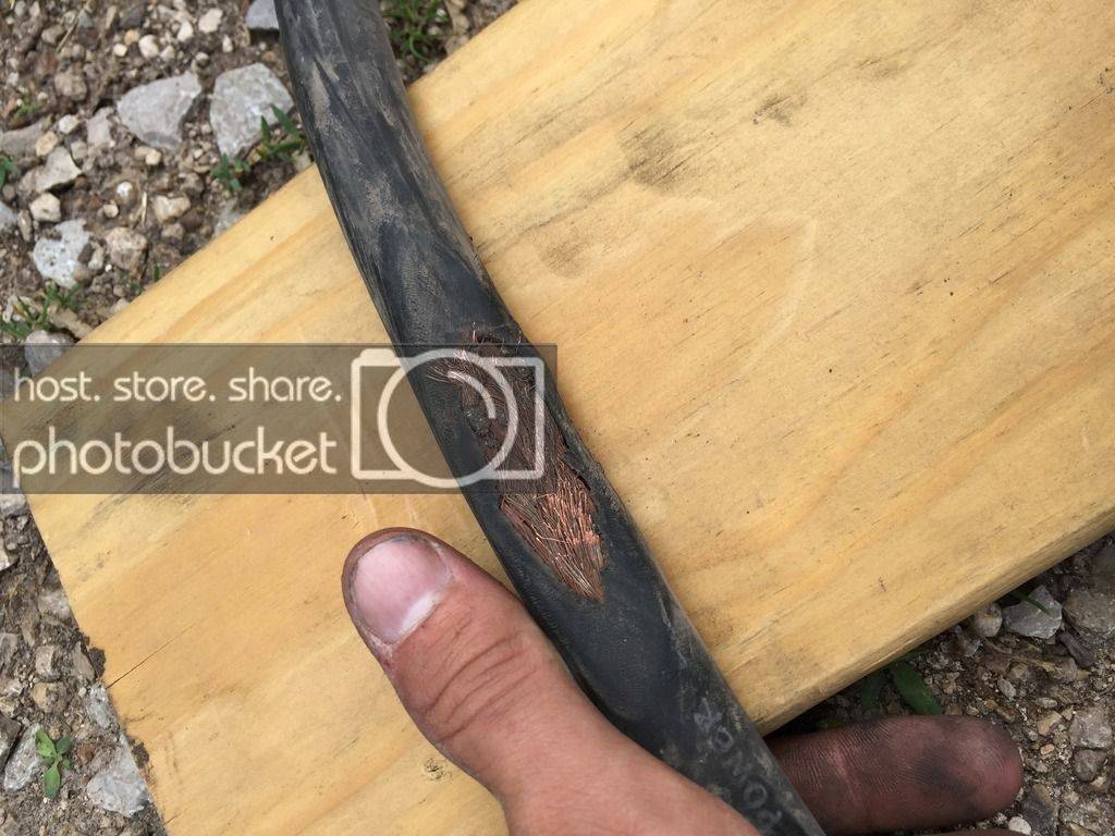

Pulling my oldest ground wire, I found that the insulation wore off under my truck //content.invisioncic.com/y282845/emoticons/eek.gif.771b7a90cf45cabdc554ff1121c21c4a.gif
Luckily, it was a ground and not a positive wire. It was in a spot I didn't think would rub
Now I've got to see how much of the wire was contaminated by air/water/salt around the exposed area. I'd like to reuse as much of the wire as possible.

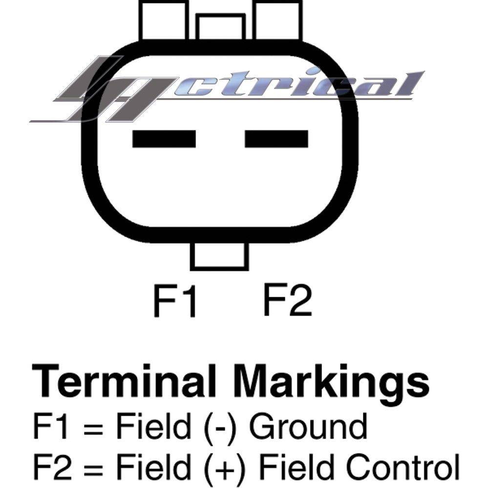

The regulator is not GM. It's similar to 99-06 chrysler alternators that were externally regulated. Here is the pinout. 1 is green and 2 is black

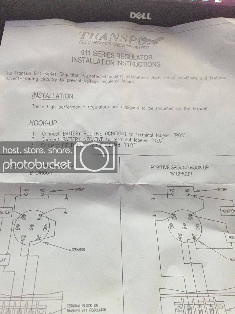

I'm sitting here looking at the printed installation guide that came with the regulator.
Field is NOT what excites the regulator. It is a three wire regulator. The positive terminal is switched power and the field terminal goes to the alternator.
Tell me this: If the positive and negative are connected to constants and the field terminal is connected to switched power, then what goes to the alternator?
The information I need is what to do with the alternator plug wires. My best guess would be to run the "field +" wire to the field terminal on the regulator and ground the "field -" wire.
To make it easier yes your guess is right..
