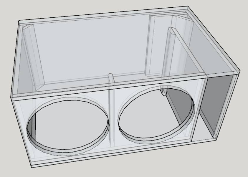

So about 112? To fit that, I'll have to run the port out of one of the sides because I've got the box about as wide as I can make it to fit my trunk. How about this:

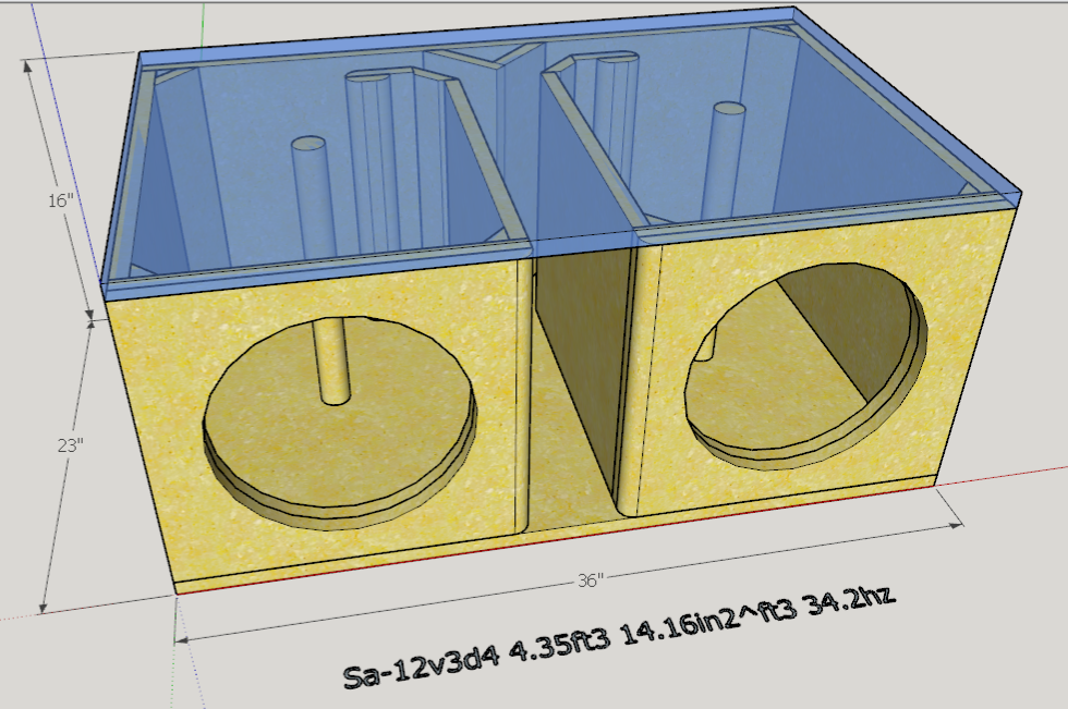

I took a look and modeled what I'd do if I had your space, vehicle and configuration problems and and was trying for a slot facing rear on a 2k amp. Op remember... you will need port clearance at the rear of the trunk as well.
Just under 6ft3 net with around 80in2 of port above. It's as much port as I could fit with a slot on the face and actually models up decent, not optimum but pretty good imo.
Just message me if you'd like plans for that enclosure.

I guess I got caught up tryin to see what I could come up with... The 15's enclosure was quite a compromise but something sized better will really do well. Just his budget will be the limit, he's got plenty of space for 2 12's easy.
this design did really well on a RP2K I was told.
I agree, a nice set of 12's ought to really do well in that space.
