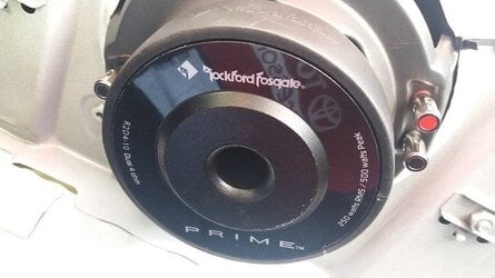

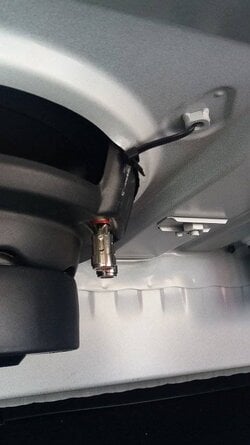

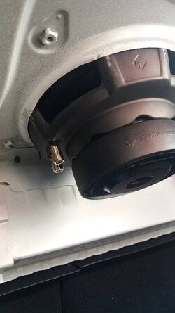

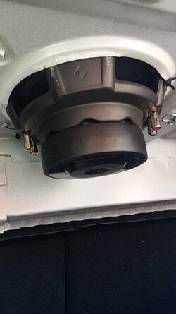

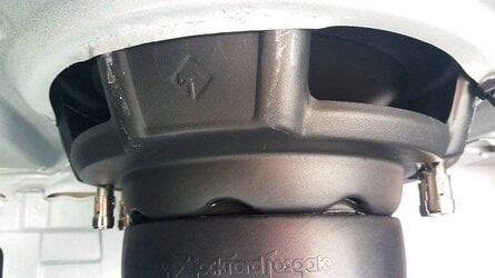

Hello,
I have a new camry 2019 hybrid and this model actually has a factory 8" cut I guess for a sub-woofer. I bought a rockford 10" sub. I didn't know that the cut is 8", when I got the sub and wanted to install it .. it didn't. So my wife's brother went to bending the cut edges to fit the woofer, I told him it won't work, because maybe if the woofer's frame touches the car's body that would be a problem, but he insisted to move on. And I thought .. ok if it didn't work then I just have to get everything back to original setup and sell this 10" woofer and get 8" one.
These are the images are attached.
Should I continue or uninstall the woofer ?

I didn't wish to continue the wiring because I knew something is wrong !!
So should I bend the edges more or change the woofer to 8" ?
Depends how fucked the edges are. If it's so bad an 8 inch will leak you need to just go to an audio shop and have them cut you a 1/2 inch wooden baffle that will allow the 10 inch driver to fit, or cut one yourself. The easiest option is to get an 8 inch driver if the hole isn't too mangled and just deal with it until you're ready to put down the $ for the proper option.

I’d be concerned with finding a woofer that performs well in a free air environment unless you are going to build a sealed enclosure around it.
Least difficult - stop listening to brother in law and find and open air 8 (u may have to use a baffle Now to fix your bro in laws handy work
More difficult - use a baffle and build an enclosure for sub.
Id make the brother in-law buy that sub that he scratched all to hell, and find out if the existing sub is a 2,or 4 ohm and get a replacement.Need to know how much power the internal amp is and find a sub equivalent to match the ohm load and power you have.Is there an issue with the old sub??
