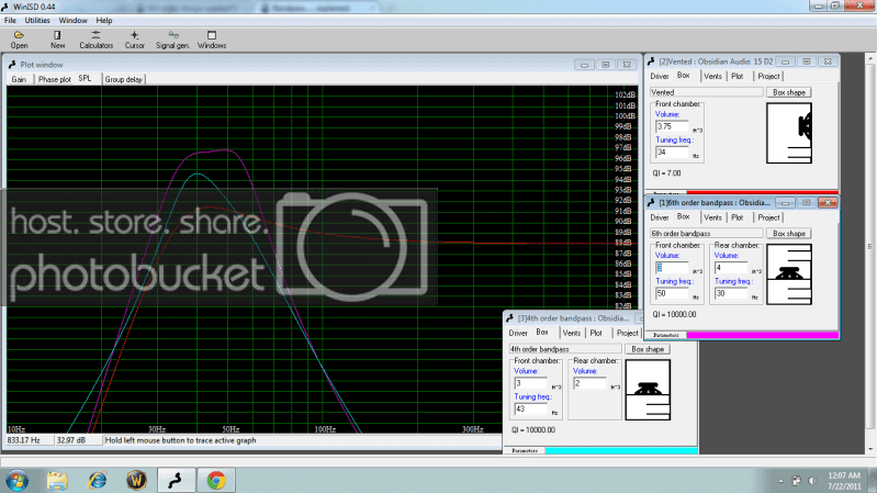

I've been running numbers through WINISD and this is what I've got so far:
full size 4thvs6th.png picture by scwolves10 - Photobucket
Also, how musical are these boxes? Is there a certain ratio for the chambers and tuning?

It depends on how much room you have to work with and what your goals are. If you don't have a ton of room to work with go with the 4'th order. However, if you have a large amount of room to work with you can choose to use a 6'th order and have a larger bandwidth. Keep in mind that 4'th orders also peak lower in-vehicle than what they are designed at. For instance, a 4'th order tuned to 50 Hz can peak at 38 Hz when installed in a vehicle. Also toss what WinISD says about ported or non-ported based on EBP out the window.
6'th orders can be more musical. But I think it's kind of funny when people ask about musicality in bandpass enclosures since BP enclosures purposefully shrink your bandwidth to gain output and a large bandwidth is what being musical and having great transient response is about. Having said that, the enclosure with the largest bandwidth will technically be more musical but not very many people are worried about the spectral decay of track 4 on the Stereophile Test CD 2 when they're designing bandpass enclosures. Bandpass enclosures are / can be very loud over a moderate frequency spectrum, which is exactly what they are intended to do. If it were me, I would personally go with a 4'th order unless you have a truck with a camper shell on the back and you don't care about taking up 8 to 10 ft^3 total for a single 15.
