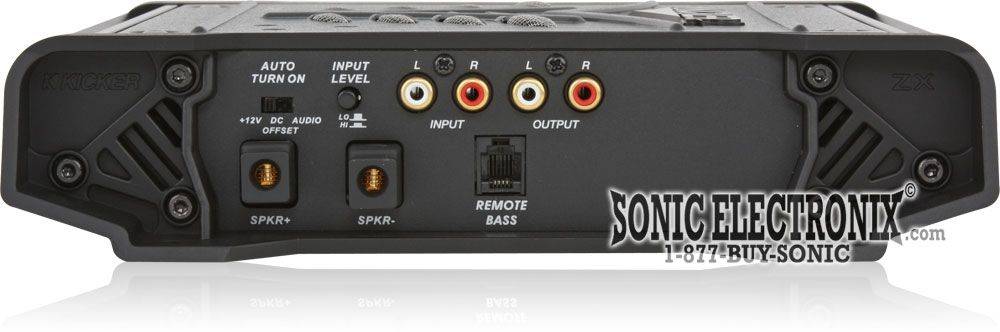

or maybe u guys can just tell me where abouts to set my gain since its a popular setup (half way turned, 3/4 turn, etc..).. i have 2 12'' Kicker CVR's (2ohms) at 50-400rms each sub with a Kicker ZX750.1 amp at 750rms.
also on my amp it says input level ( hi or low) what should i press it to?
The input switch should be set to low if you are using RCA's from you head unit. If you are using speaker level inputs for your amp, you would set it to high. Setting you gains is a different story. Do you access to a multimeter or an oscope? If you have access to a multimeter and a test tone. Just figure the output power you want and multiply that by the impedance load on the amp. I am assuming you are wanting 750watts since your amp does 750 rms at 2 ohms. Multiply 750 and 2 then take the square root of that. Then hook you meter across you speaker leads make sure it is set to measure ac voltage then adjust you gain till your meter reads about 39 volts. That should give you 750 watts of power at 50hz out of your amp.
