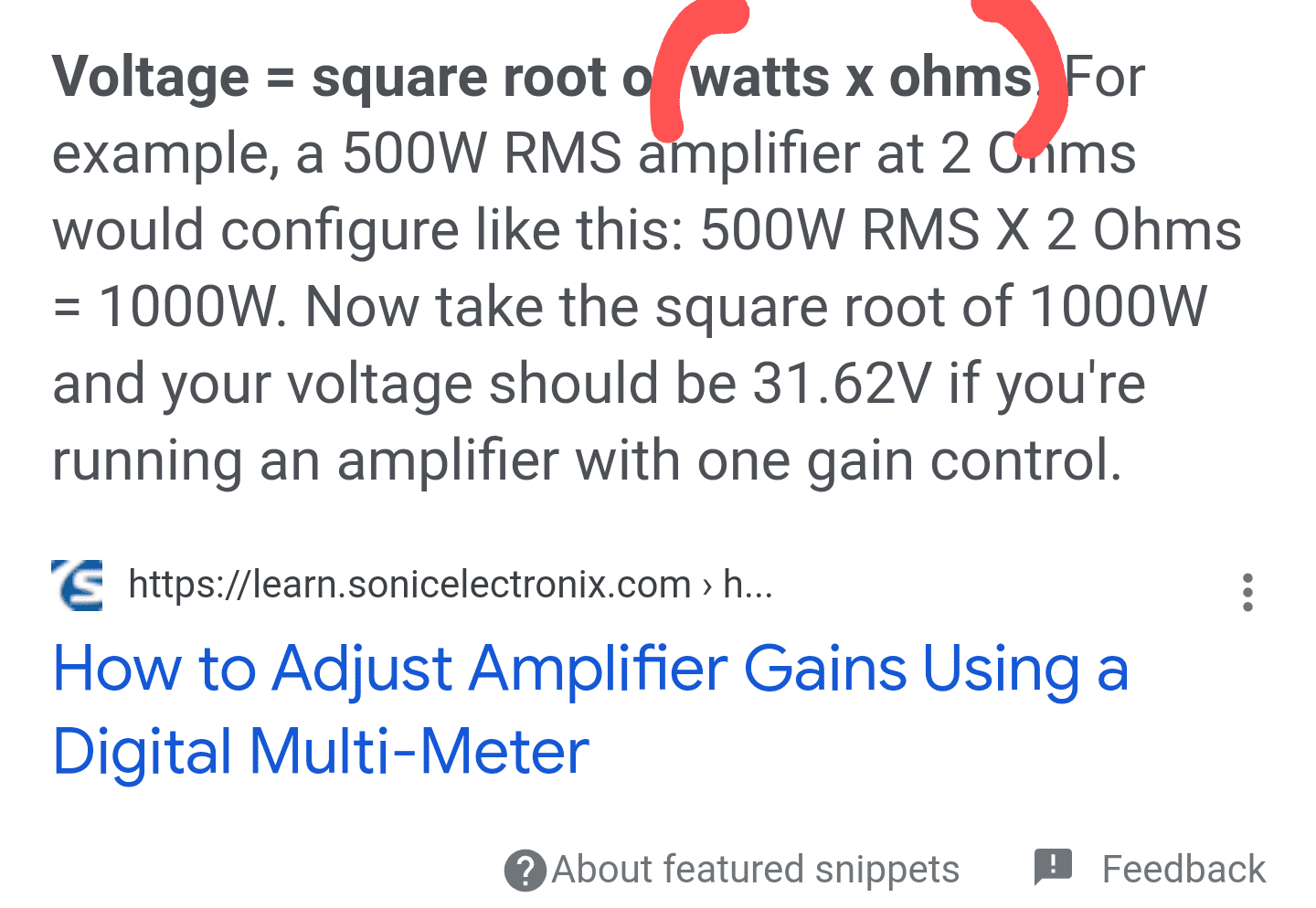

Using the multimeter works fine. I set my own gear by ear and have great results, but that is because only I have access to my gear. Here is the formula for setting with multimeter. The watts in the formula will be what you wish each speaker to receive.
