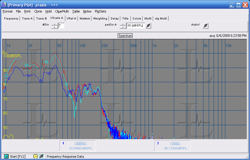

As a measured example of how placement affects phase and then response, here are the measurments from Bose301's Magv4 in his blazer. The light blue curve was the original placement. There is a huge peak at just under 50hz followed by a large dip at about 88hz. The difference in magnitude between these two points is 45dB! This will make it sound like the woofer is not even playing at all as many people experience. The dark blue curve is the flattest placement. This is simply changing the same woofer in the same box to firing upwards. A lot of the bump below 70hz was decreased and the bump at 88hz came up significantly.
There is still a large amount of extra low end, but the apparent difference is now only 18dB vs 45dB. All that was done was to change the position of the box in the vehicle.

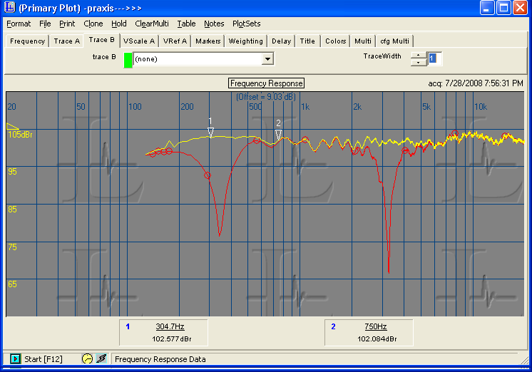

Then other way to test for this is to actually listen for the null. Flip the polarity of the woofer and adjust until the bass really disappears at the xover point. Then flip polarity back. Sometimes it is easier to listen for the most cancellation than the most summation.
Here is an example of a 3way system. You can see the yellow curve is quite flat response with drivers all in phase. When the polarity of the mid is flipped 180degrees you have 2 very deep nulls at the crossover points. This shows that the phase was correct when the mid is wired with normal polarity.
John

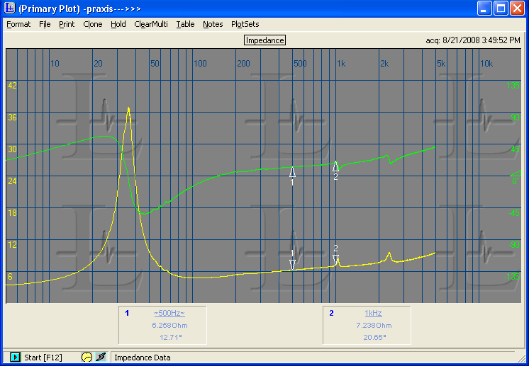

If you take a look at the impedance curve you can see the 2 breakups. The dust has a breakup at almost exactly 1KHz and is quite minor in magnitude. The cone on the 12" has a breakup about 2.4KHz which is more significant. Even if crossing at only 12dB as high as 100hz you'd be over 40dB down by the time you got to the first minor breakup from the dustcap and over 50dB down by the cone breakup. For any subwoofer application the breakup is not even remotely an issue.
If you plan to use the drivers up to 500hz or so in a 3way home speaker then you'd need to take a little more care. You'd want to have a 24dB slope to keep these breakups suppressed. These drivers actually will reproduce the lower vocal region as well or better than most good midrange drivers. I doubt anyone on this forum needs to worry about it though. //content.invisioncic.com/y282845/emoticons/smile.gif.1ebc41e1811405b213edfc4622c41e27.gif

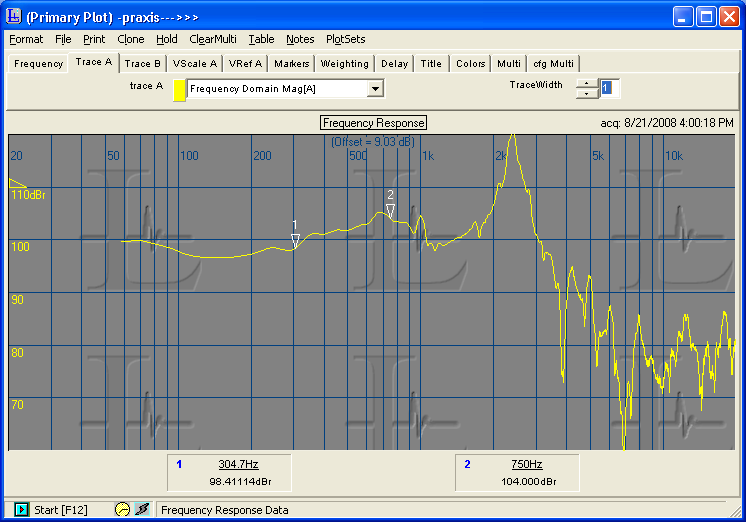

Point taken, however when you look at the measure response of the driver in question, IMO the most significant break up with just over 2kHz, that is a good 4.5 octaves above where I would cross over at, so really it isn't an issue.
