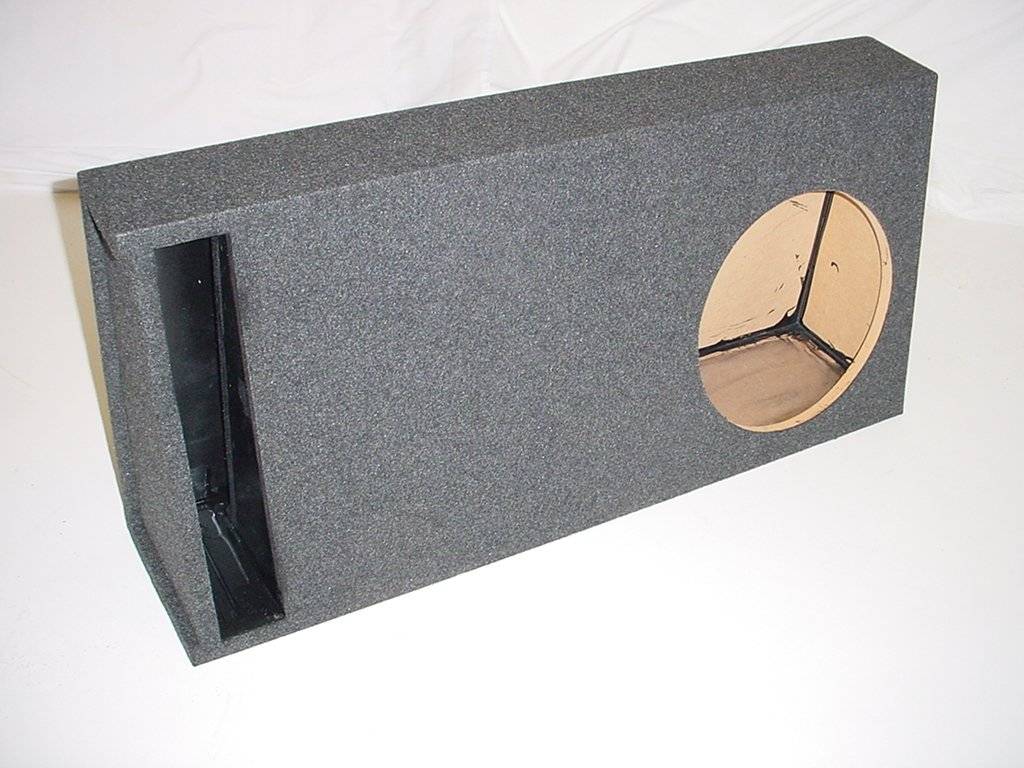

This is the box I havein a single cab 2006 Silverado.
http://caraudiofactory.com/single-slot-ported-truck-p-204.html

I would change box before a new sub. If that pic is the box you have, that box looks like a prefab and a very bad one at that
^^^This.....And if your amp is getting hot get some fans or a different amp. Plenty of options...just need to have the cash.
well Buck's as well but look into a custom quality built box over that pre-fab

Yes, I have a prefab box.
