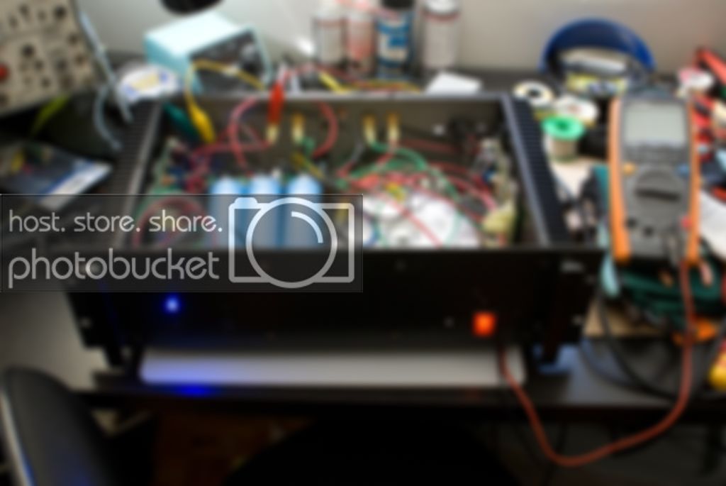

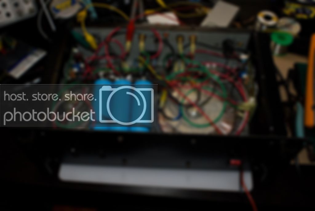

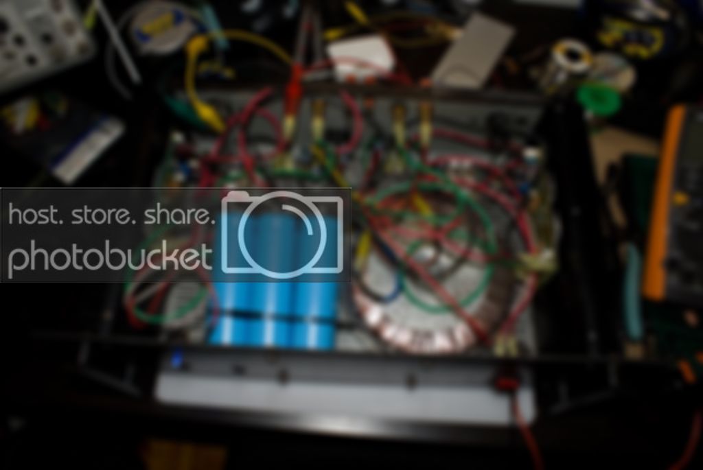

Picture time? First of all don't mind the nasty wiring. I've been reconfiguring and changing things around. And for the sake of time I am cutting the wire quickly and not organizing it.
I've got a few more things I want to try to make it sound even better. But, right now I've changed the bias current to 30 mA instead of the specified 15-20 mA and it has cleaned up a lot of the weird distortion I was hearing. It also had made the amp sound a bit warmer. Also, I changed out the input capacitors with a different type and a slightly higher value. Which has helped with a bit or noise I was getting on the left channel. Also, rewired the XLR connectors and changed the wiring on the filter capacitors.
I am planning on adding a few bypass caps to absorb some of the switching noise from the rectifier and I want to do a split powered system using two rectifiers. Still also need to finish the soft start circuit so my power center stops hating on me when I turn this amplifier on.
Anyway, pictures:
Ignore the ugly wires...
BTW, since my modifications to my power supply circuit the amplifier drove a 8 ohm load to 45.939 Volts with out clipping at 1kHz which is about 263.8 Watts... //content.invisioncic.com/y282845/emoticons/woot.gif.aaa6090e619a97b6090d16dd863c5a69.gif
I would have kept going by my pre-amp source ran out of steam and was maxed out. The cooling fins got a bit warm needless to say.
