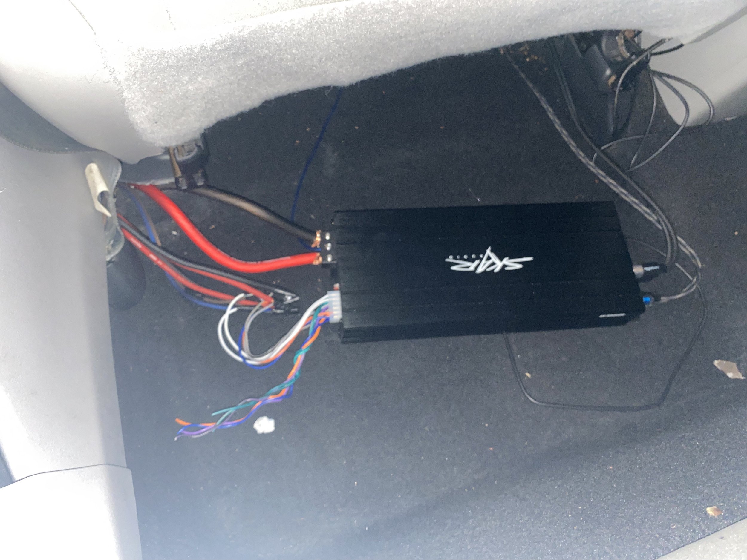

I posted a pic of the amp (Sorry for the low quality)

Many red flags from that single picture. I would get the install fixed for safety reasons. I wouldn't bite on their jl speakers. You only need new rca's if yours are damaged. What the **** are 9mm's?

Only issue I see is those bare power cables. Remove the fuse under the hood and tape them up. As for power cutting out, it may be a bad grounding point. Make sure the ground is sanded to bare metal for the best connection.
The extra tweeters may be redundant seeing that you have full range 6.5s. Since they are "sharing" the same channel with the 6 5's tweeters, the Ohm load may be dropping and pushing the amp a bit harder.
I would disconnect the 6.5s tweeters or eliminate the Polk tweeters.

Yes. If the part you can see looks this sloppy it's anybody's guess what all else has been done incorrectly or half-arsed.
how the amp was wired is dangerous and can cause a fire.
That is probably a little overdramatic, but again, what else is done sloppy that we cannot see from this picture? If you did not properly install fuses you could very easily burn your car to the ground and just with what we see there's a lot of opportunity for you to break equipment prematurely.

Id pull all the wiring your buddy ran and uninstall the amp...then get quotes for installing the amp...it should be a good bit cheaper

I'd move that amp to the trunk.. Looks like you got it on the rear floor board, That's a bad spot to put it if you ever have passengers back there, Feet ripping out wires, sand, dirt, moisture not to mention just plain old wear and tear.
Just that one pic you posted has multiple issues.

$500 for labor is BS, but I see there point. Yeah, keep in mind, they have to check every wire. It's not just a full install, it's more. They can't just check connections, they need to check every bit of wire, and see how it's been done. They clearly need to redo every connection.
As everyone else said that is dangerous, and those bare connections on the amp, could definitely cause a fire. That amp doesn't look secured. Your amp could slide around on the floor, and with those bare wires at the connections, the cables can shift, and might shift enough to arc.
It looks like he ran smaller power and ground wire, that's not connected to anything, and just electrical taped them together. Is that 5 or 6 more wires? What the hell is that?
Running wires under carpet to hide them is fine, but you can't put them somewhere right where someone is going to put their feet. They will eventually rub through the casing to the bare metal.
SERIOUSLY, PULL THE FUSE on the power cable, (if there is one, (which there needs to be)), pull the fuse on your radio, so you don't accidentally turn it on. Pull the power cable off the battery if you feel comfortable doing that, and zip tie it out of the way until someone who knows what they are doing can fix that.
Where does that ground wire off the skar amp go? It doesn't matter.
SERIOUSLY, YOU NEED TO PULL THOSE FUSES OUT OR EVEN BETTER, PULL THE CABLES OFF THE BATTERY, AND DON'T TURN ON THE STEREO UNTIL YOU DO.
See that little blue wire between the power and ground. That's your remote wire/ switch wire. That's the wire that turns the amp on, when the head unit is on. Cut that wire before the amp, and the amp won't turn on. You will still have the length, but nobody who knows what they are doing is going to leave your amp there, and let someone who knows what they are doing fix this.

I really do not know what everyone here is going on about this "dangerous" install. The red/black wires are for the 6.5s. Each wire is twisted and taped individually with electrical tape. The blue/black wires go to the sub and are also twisted and taped individually.
That amp obviously goes tucked under the driver's seat but was pulled out for the photo. Like I stated earlier, the only issue I see is the exposed power cables. Add to this the OP's statement that all was working fine and dandy until the Polk tweeter's install.
